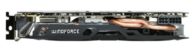

I understood that there are a great many PC cards that can be used so long as I'm prepared to forego the boot screen or flash the EFI. So I decided to go the PC card route and ultimately opted for the following card:
Gigabyte GeForce GTX 960 OC 4GB GDDR5 Dual Link DVI HDMI DisplayPort PCI-E Graphics Card (links through to exact model purchased and price paid).
I settled on this card, reassured that it was being offered by macvidcards.
However, what I can't get my head around is how much should I worry about the fact that it's the GTX edition with "OC" (presumably overclocked?). Does that mean it'll draw more power than a non OC version and therefore cause stability issues?

Yes I believe so. And if not in the box it has the slots:
Ok, the 8 pin connector can draw 150 Watt, the 6 pin 75 Watt, too much for Mac Pro (2 * 6 pin).
Use an external PSU, do a mod with the internal PSU, or a workaround with adapters (2 * 6 pin to 8 pin adapter and 2 * SATA to 6 pin adapter).
However, I don't think a GTX 960 is worth for extensive work. You can have a GTX 980 which fits in the power envelope of Mac Pro with 2 * 6 pin connectors.

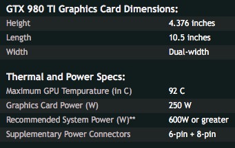

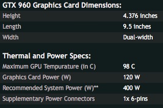

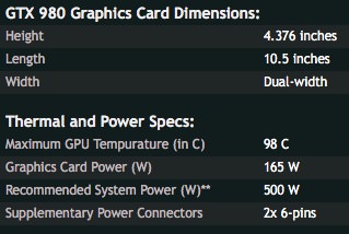

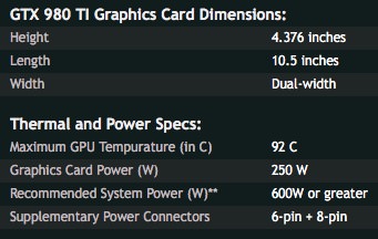

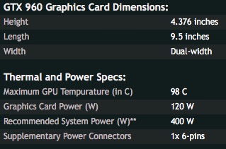

Recommend 400W PSU because the computer has CPU, HDD, mobo, etc., not just the GPU. In fact, a CPU can easily consume 100W. Also, AFAIK, the 400W may means the max output is 400W, not minimum, under high temperature etc, the output may be lower than the rated number. Therefore, GPU manufacture will recommend a PSU that has much higher power rated then the GPU itself.

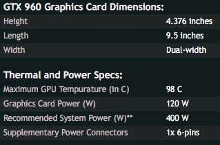

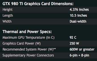

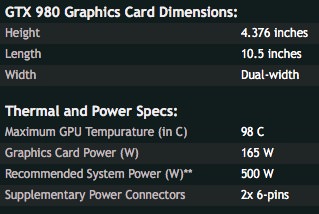

These are all directly from Nvidia. As you can see. They recommend a 400W PSU for the 120W 960. For 980Ti (250W), they will recommend a PSU rated 600W or above.
View attachment 631419 View attachment 631420 View attachment 631421

Your 960 is fine. The reference model is 2x 6-pin and that tiny factory overclock will not add an appreciable amount of wattage. The 960, even overclocked, uses significantly less wattage than the cards people are recommending with 2x 6-pin connectors. The two extra pins on that 8-pin connector are almost certainly cosmetic marketing BS for the overclocker crowd, as we've seen on many other cards, and are not actually required as it is on other cards like the 980Ti.
Get two normal 6-pin Mac Pro GPU cables and connect them to the 6-pin and 8-pin connectors on the card. The 8-pin connector on the card is keyed to accept the 6-pin cable.
