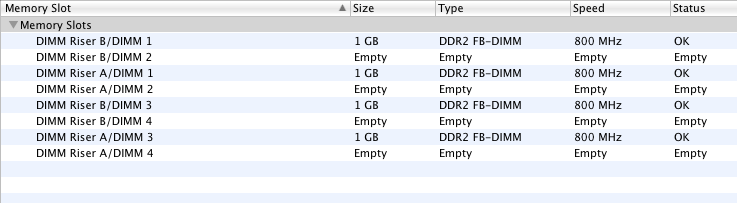

Yes, I understand configuration, but I was testing the riser board slots with the 4 dimms that I have. They show up in System Profiler as OK and the dimm type or as Empty. The only way I've gotten my entire 4x1GB dimms to show up and give me a total of 4 GB is placing them in A1-B1, A3-B3 (according to System Profiler).
It is just very hard to believe that the same 2 slot on each board has gone bad, A2, A4, B2 and B4, but these show up as empty when tested. Can there be some other problem besides both boards being bad?
The above is the only configuration that gives me my entire 4x1GB ram.

OK, my bad. I had my ram manufacturers mixed up even though the dimms have the same specs. Now I can see slots A2 and B2 are working. Trying to figure out now how to test slots A4 and B4 with only my 4 dimms. *sighs*
[doublepost=1549492998][/doublepost]I figured it out! If I insert all 4 dimms, paired by manufacturer, in the top riser board they all show up in System Profiler. I did this on each board, swapping them out to the top. ALL MY SLOTS WORK! YAY!
