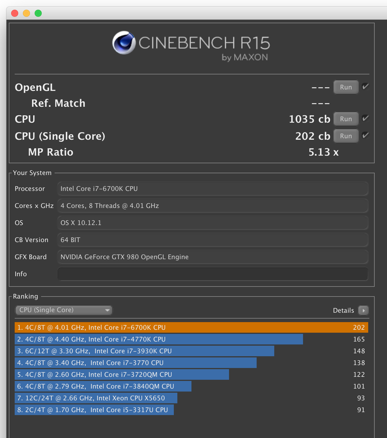

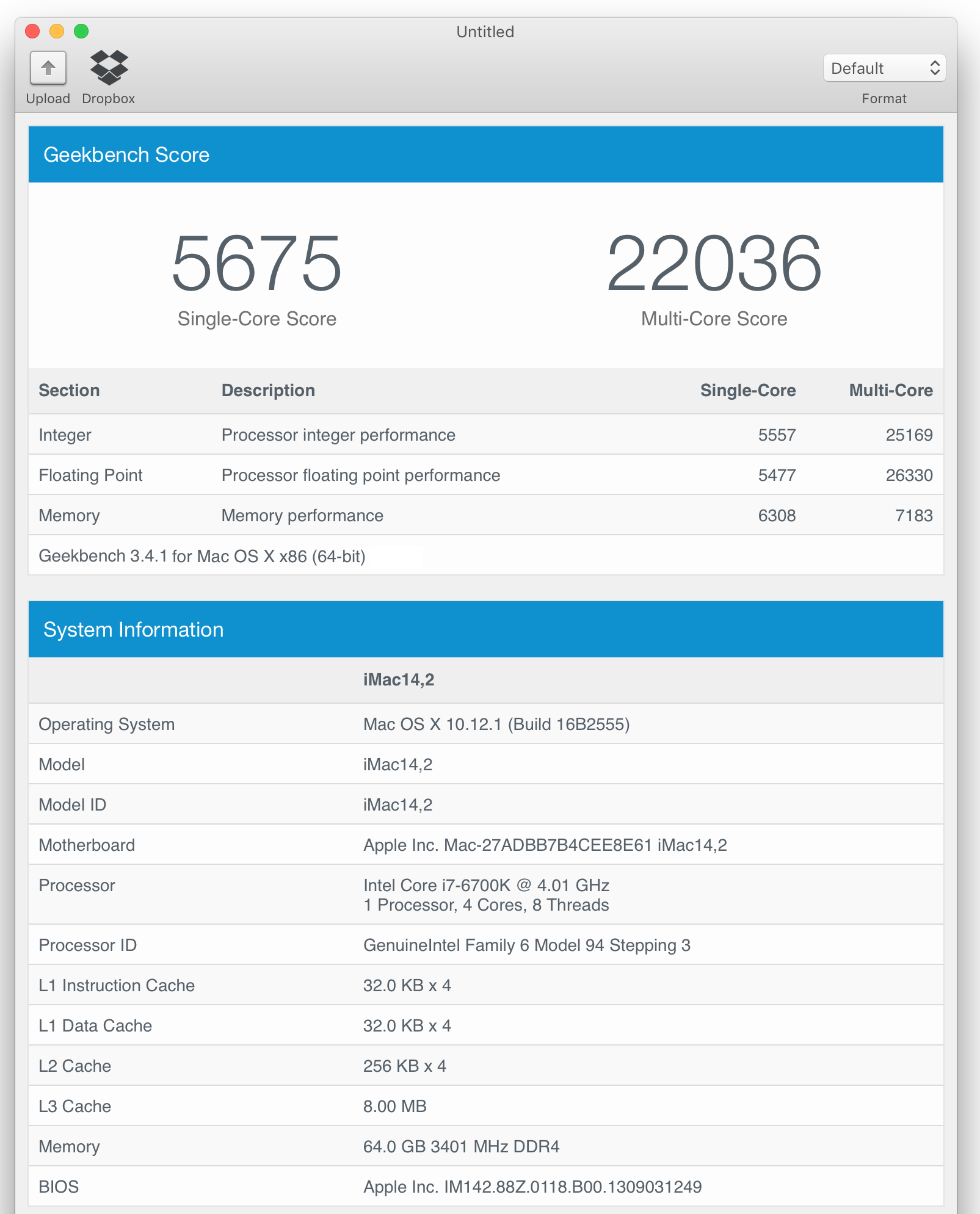

Just for comparison sake, here's a single i7 6700K...
I don't feel using a pair of 150W CPUs to do what a single 130W CPU can do is "worth it" at all.
