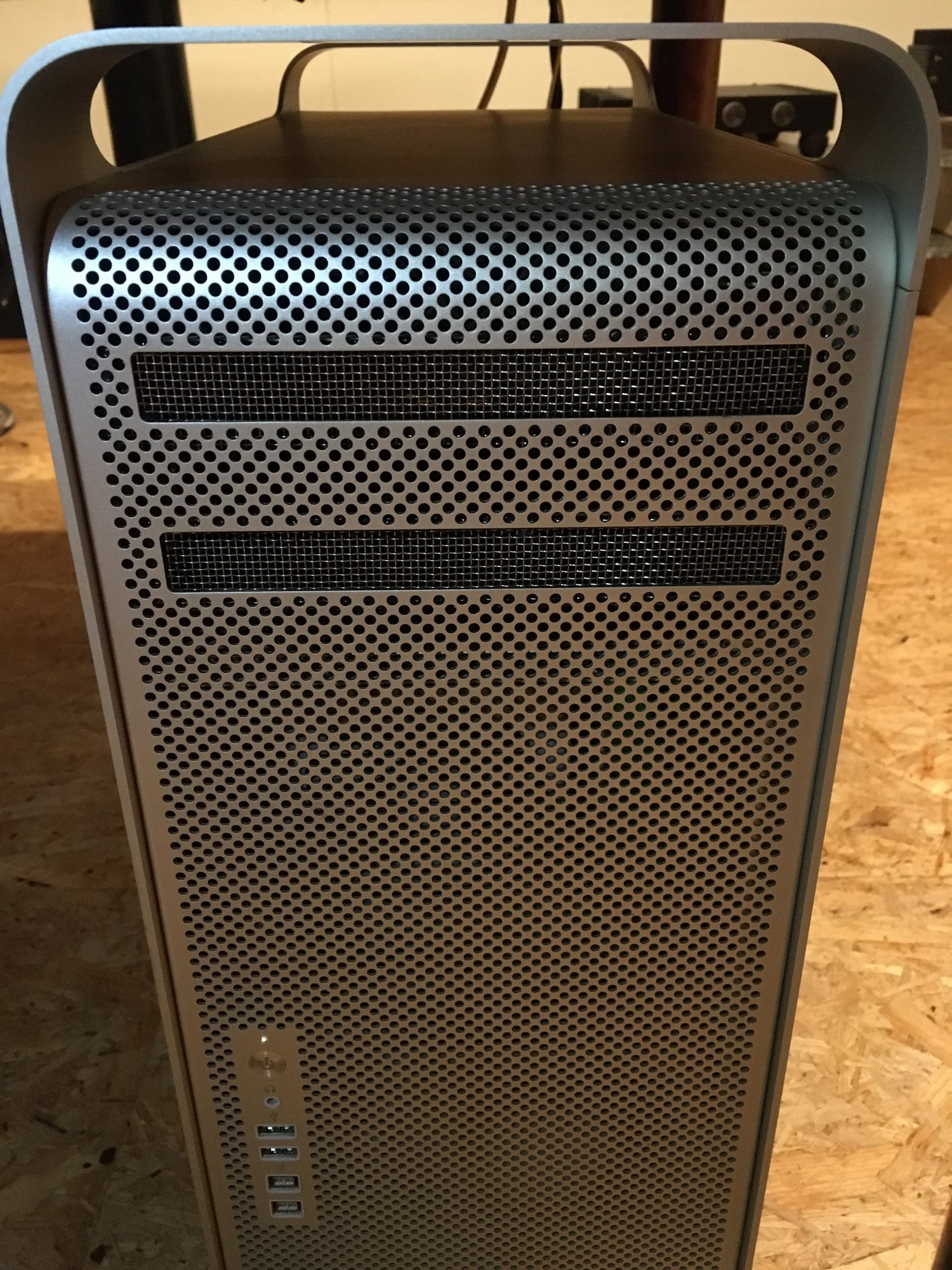

From the day I bought this MP 4,1 I removed the DVD drive, and along the way , any part that is not necessary like spinning HDD , obstructing the airflow ,generating more heat and slowing down boottime.
The optical bay , I think, can be seen as a tunnel in front of the PSU fan.
This tunnel should have a surface equal or bigger than the surface of the fan (circle of radius 6cm).
If the surface is smaller, this will lead to resistance , which means an increase of the airflow speed at the bottleneck, or just less throughput.
The motor of the fan is not a AC synchronous type (regulated by the frequency of the AC),neither a PWM (regulated by Pulse Frequency), the speed is regulated by voltage.
Presuming the SMC is not influenced by the current the fan motor draws, depending on the resistance of the airflow, the voltage will be adjusted too.
To put it simple: I think its save to presume that with more resistance in the airflow, the motor draws more current and will heat up more.
The power draw is compared to a big GPU marginal, but the heat might be a negative factor.
Looking at the empty optical bay, the surface is much bigger than the surface of a 120mm fan, which is good.
But the whole dvd door mechanism is definitely not, even with the flaps kept open permanently, there is still lot of material in the way I think.

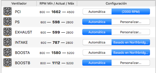

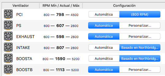

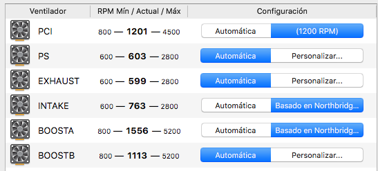

Last night I “removed” the plastic mechanism with the doors for the DVD- drives completely and glued some stainless steel mesh in the slots.
A quick test showed that now the PSU fan ,depending on the load, is running significantly slower (somewhere between 100- 300 RPM less) SMC set to default for the PSU fan.
Of course, this is on my set up.
I attached a foto of the result,I hope that the purists among us won’t be shocked 🙂
BTW I tried to define the sound of my (worn) PSU fan so I ramped it up to 2800 RPM for a few seconds.
The sound is very close to a bomb alarm siren…. 🙂
I’ll buy a Noctua fan this week !
Reactions: atonaldenim

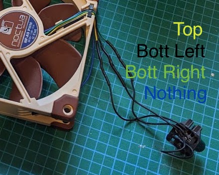

EDIT: Amediast cleared this up. The Noctua 4-pin PWM will properly work as the 92mm PCI fan when wired correctly. It will only go as slow as 1,000-1,050rpm in my experience with iStatMenu but being a noctua fan that's not bad. Software can ramp up correctly from there.
Pinout for the 6 pin connector for the PCI fan
There's only 4 pins connected as it's jut the fan in there, the other two pins are empty.
(top left) = VCC (12V)
(bottom left) = GND
(middle bottom) = V Control
(bottom right) = Sense/Tacho
I followed your pin out diagram today, using a Noctua 92mm NF-A9 PWM it shows the RPM in my iStatMenu app but I have no control over RPM. I was excited to do this because we were supposed to adjust fan speeds with software.
Black #1 GND on the ••• bottom right.
Yellow #2 12v on the • top
Green #3 Tach on the •• bottom right.
Blue #4 PWM disconnected. •••• bottom middle disconnected.
Have I done something incorrect?
Is it perhaps the app I'm using that doesn't offer control over this fan?
I'm also looking to replace the 60mm fans in my 2x CPU coolers. You've done a wonderful job illustrating pinout for the PCI fan, considering all the wires have no colour coding. Is there a simple way to tell which wires are soldered to which for the others?
As per the few posts earlier, and my original post on page 1 all my testing was done with non-PWM 3 pin fans. It appears that at least some 4 pin PWM fans do not respond in the same way.
I’m afraid the only way to work out which wire is which is to label them and start testing! Either by probing output pins on the board while the machine is running, or where this is not possible, like on the CPU heatsink fans, apply test voltages to the fan and work it out. This was the most annoying bit of the whole procedure but if you label all the wires and work methodically only a takes a few minutes.
[automerge]1588574521[/automerge]
EDIT - also, looks like you’ve wired it up wrong too.
double check my notes on page 1, I think from your description you’ve wired the 12 fan input to the 12v output in the board and NOT the Vcontrol output pin which is middle bottom according to my notes and photo[/QUOTE]

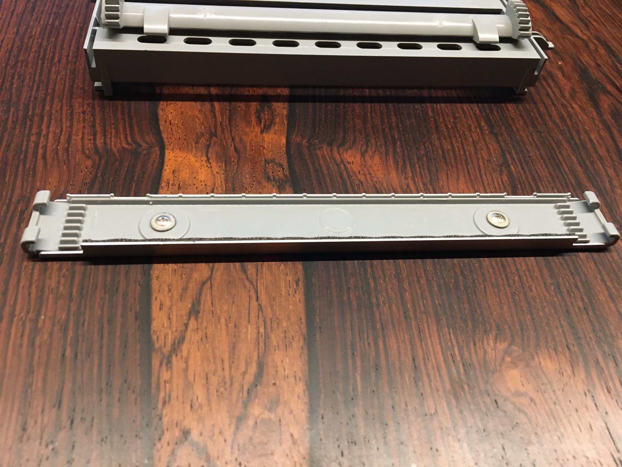

Can you give me some instructions on how the dvd slot doors and frame are removed, i removed one screw but it seemed to be fixed in there.......
The "removal" of the door mechanism was something closer to violence than to science...😉
So I'm in no way responsible to the damage you could do to your Mac Pro, by doing the same thing...

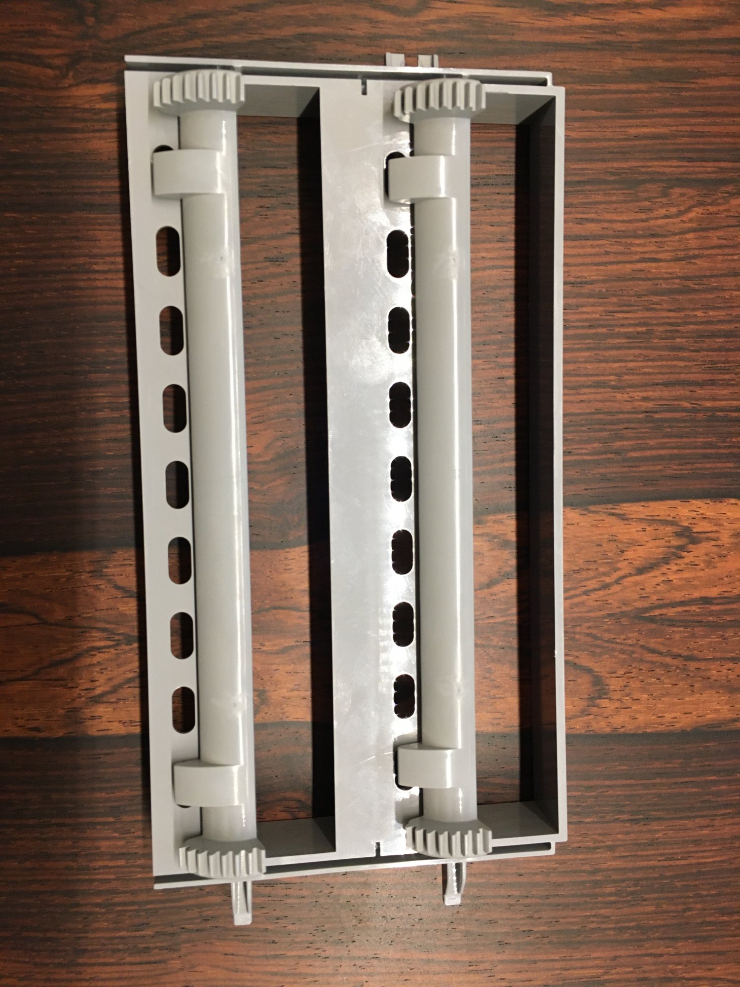

I attached a photo of the plastic mechanism after removal.
You are right, there's only one screw , but as you can see on the other side there are two latches .
The doors when "open" slide into a space between the front and another perforated aluminium strip (which looks exactly like the front).
These strips got a tiny edge which prevents the doors from sliding upwards beyond the correct position (when closed).
That's why you can't get it out:
-the latches
-the doors
I placed the MP on its side, open side facing upwards.
I don't know exactly in what order, because I was fiddling for a while, but forcing the whole plastic frame a bit away from the front with a flat screwdriver , I managed to get the doors above the edge of the strips, and then you can slide the plastic latches in the back out.
Maybe its necessary to bend these strips a bit backwards, but after removal you can easily bend them back.
Another possibility is to manage to get the doors out of the plastic frame, by breaking or cutting the hooks at the end(photo), and then remove the whole unit.
I counted on breaking the whole thing (but it didn't), so it's something that could be irreversible ...
You will need patience to get it out!

Hi amedias,
Conclusive response, hopefully i can capture all of your questions
the pwm 4 pin fan i refer to is the following noctua
https://www.amazon.co.uk/gp/product/B07C5VG64V/ref=ppx_yo_dt_b_asin_title_o01_s00?ie=UTF8&psc=1
I found that when left on auto, the fan would occasionally surge. This left a gap on istats logging graph for all sensors. The fan would register from 0 to 950 rpm. I found that this irregularity was consistent until i left it running at 1100rpm.
before i remedied the irregularity i found that the sudden surge would cause the system to switch off when sleeping, i was not happy with this and once applying the 1100rpm it no longer happened.
not happy that a 4 pin would work correctly, i sought out the 3pin variant. Because i wanted to fix this quickly i ended up buy the following 3 pin fan.
https://www.amazon.co.uk/gp/product/B00KEST8PQ/ref=ppx_yo_dt_b_asin_title_o00_s01?ie=UTF8&psc=1
The noctua specs don’t include a minimum for this fan, however as explained above...... it has the same characteristics in terms of irregularity.
https://noctua.at/en/nf-f12-industrialppc-2000/specification
i have not reset the SMC, and i used macs fan control and istat. Could these two be conflicting? My reasoning for the two is to show the historical graphs but prefer the control that macs fan control gives me.
i note your comments regarding the ability to unplug a fan, I don’t believe your statement to be correct because if you remove the front intake fan then the exhaust and/or booster fun at full speed.
Lastly i have been using these fans in the PSU slot.
again, great work...... its people like you that keep these things running well.
This is a symptom of either a fan that will not run at the SMC target speed, OR a misbehaving SMC. Basically the voltage output on the control pin is not enough to start/stabilise the fan, so it stalls. In response to this the SMC increases the voltage until the fan starts, at which point it then starts decreasing it again aiming for it's target RPM....and then the fan stalls again, repeat on and on....
Well that is very curious as I was pretty sure someone else had reported the NF-A12-25 working for them using the Mac Pro headers and the pin swap, although I can't remember if they were referring to the 3 pin version or not. I will see if I can dig out the reference.
It's not a model I've tested myself personally.
I linked to the specs to on Noctua website above for the PWM version of that fan. Although the control driver will be different the airflow, pressure and RPM ratings are identical which would suggest the motor is capable of spinning without stalling at 450RPM when controlled via PWM signal. But with no listed min RPM and without one of those fans in front of me I can't check the starting voltage and min RPMs required when controlled via Voltage alone.
As you and another have noticed there are difference between Noctuas PWM and non PWM fans even when they otherwise appear to be identical in spec!
NF-F12 industrialPPC-2000120x120x25200029,7121,83,943-pin
NF-F12 industrialPPC-2000 PWM120x120x25200029,7121,83,944-pin PWM
This is why I asked about whether you'd tried any other headers or done an SMC reset and your sleep issue as I can confirm that on all 3 of the Mac Pros in the room with me right now I can plug and unplug the PSU (and other) fans without there being any immediate impact on the others. They do not spin immediately spin up, no fault (other than zero RPM on the header) is registered and there are no issues sleeping or waking. I've done this on the PCI and PSU fan headers and on the front Intake header numerous times while testing different fans before fitting them.
I routinely run two of my Mac Pros with no PCI fan fitted at all with no ill effects which is why I was asking, as I do not think your sleep issue/behaviour is normal so I wonder if there is something else going on?
Is yours a 2009/2010/2012?
They do conflict when both are running, but do not normally produce the behaviour you describe. how they conflict depends on which you start first and how you configure them to control/not control the fans.
You can check and control the SMC manually using the open source smc comman budled with smcFanControl
https://github.com/hholtmann/smcFanControl/tree/master/smc-command
Or if you use Linux using the AppleSMC module, either of these will give you direct access to control fan speeds manually, or automatically with modified min/max limits. (They also allow you to check temps on any sensor as well).
I have done the bulk of my testing using these as they allow a level of control that is not possible using Macs Fan Control, smcFanControl (gui), TG Pro or iStat Menus.
But I do often keep TG Pro or iStat Menus running to collect the historical data while I'm testing (but not using them for fan control so they don't override my test settings)

Noctua NF-A 9 FLX confirmed as a possible PCI fan!
Last week I ordered 2 fans which arrived today :
NF-A9FLX
NF-A12x25FLX

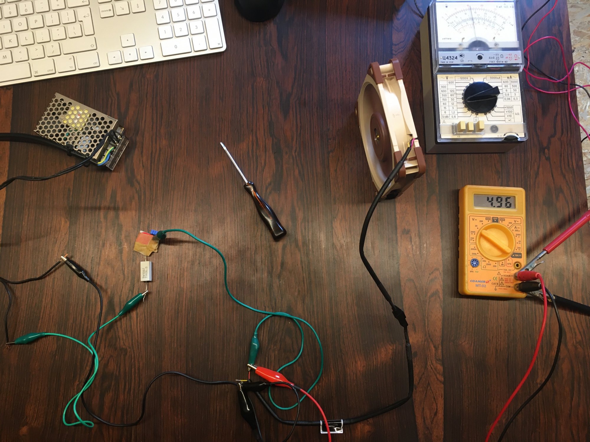

I tested minimum voltages to spin :
NF-A 9 FLX : V=4,5v
NF-A 12x25 FLX : V=5,0v
With a little lower V they start "pulsing".

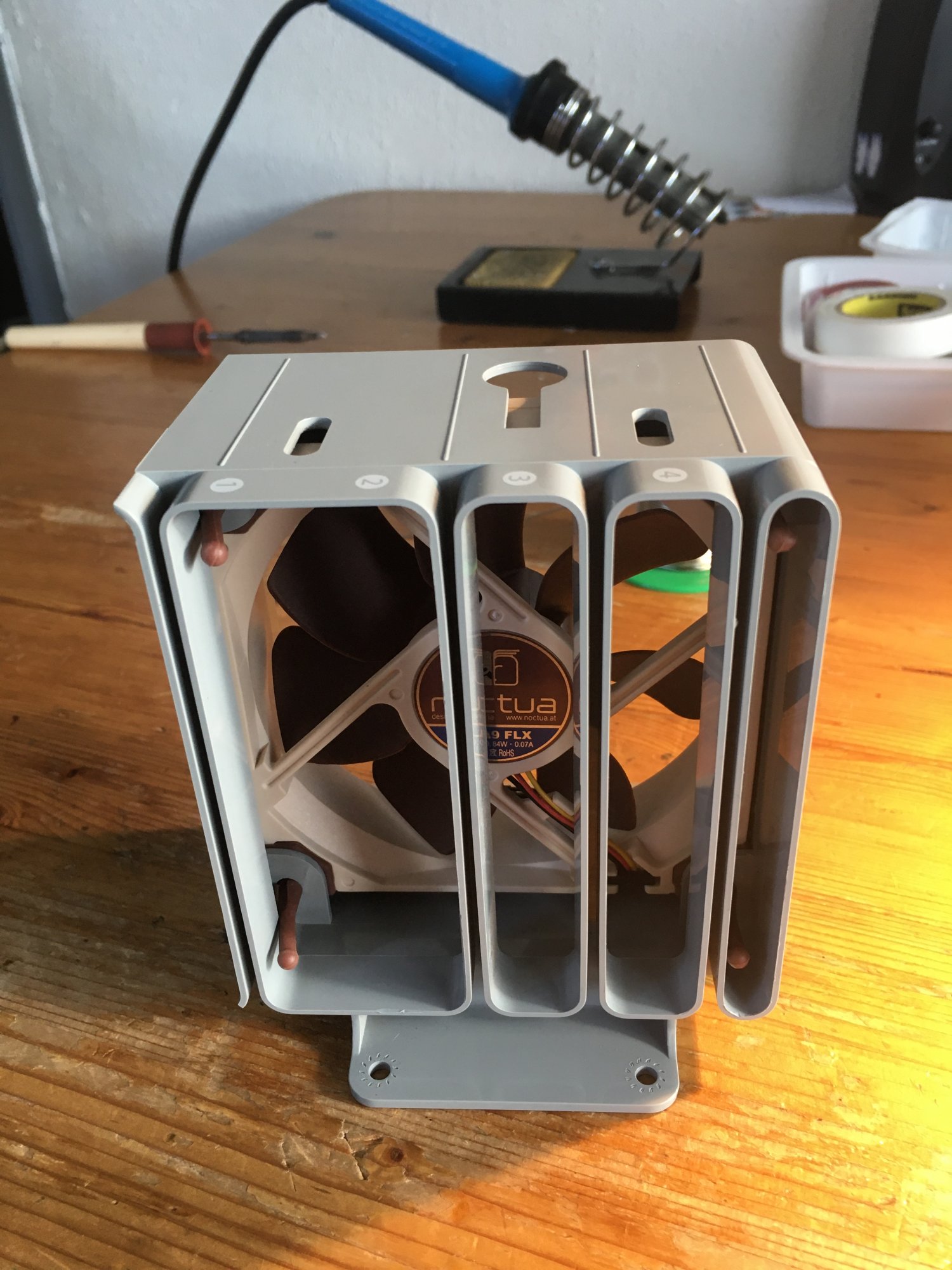

I couldn't resist to do a quick swap for the PCI fan, it was like a walk in the park🙂
Thank you so much for the pin-layout, it saved me a lot of time!
Unfortunately the PSU fan has to wait a few days, because of things I have to do on the same Mac Pro...
Since I only got installed a Mac OS I can't test the minimum RPM for these fans, but at least the NF-A9 runs perfectly smooth at default min. (800rpm).
No issues with wake/sleep , and normal response to SMC.
Both models come with new silicone grommets, rivets inclusive.
I put them "reversed" because I didn't see the possibility to stretch them when you mount the fan.
