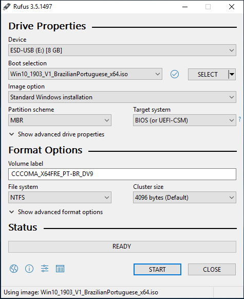

One difficulty with this is that the ISO that Microsoft currently provides does not fit on a regular DVD. Other than using a dual-layer disk, is there an easy way to use a DVD? Are there any other ways to force a CSM install?
That procedure is for “no boot screen graphic cards”.
If have any Mac EFI UGA GPU, hold option to boot can always choose legacy mode.
Reactions: cdf
Use RUFUS with BIOS?
Reactions: cdf
