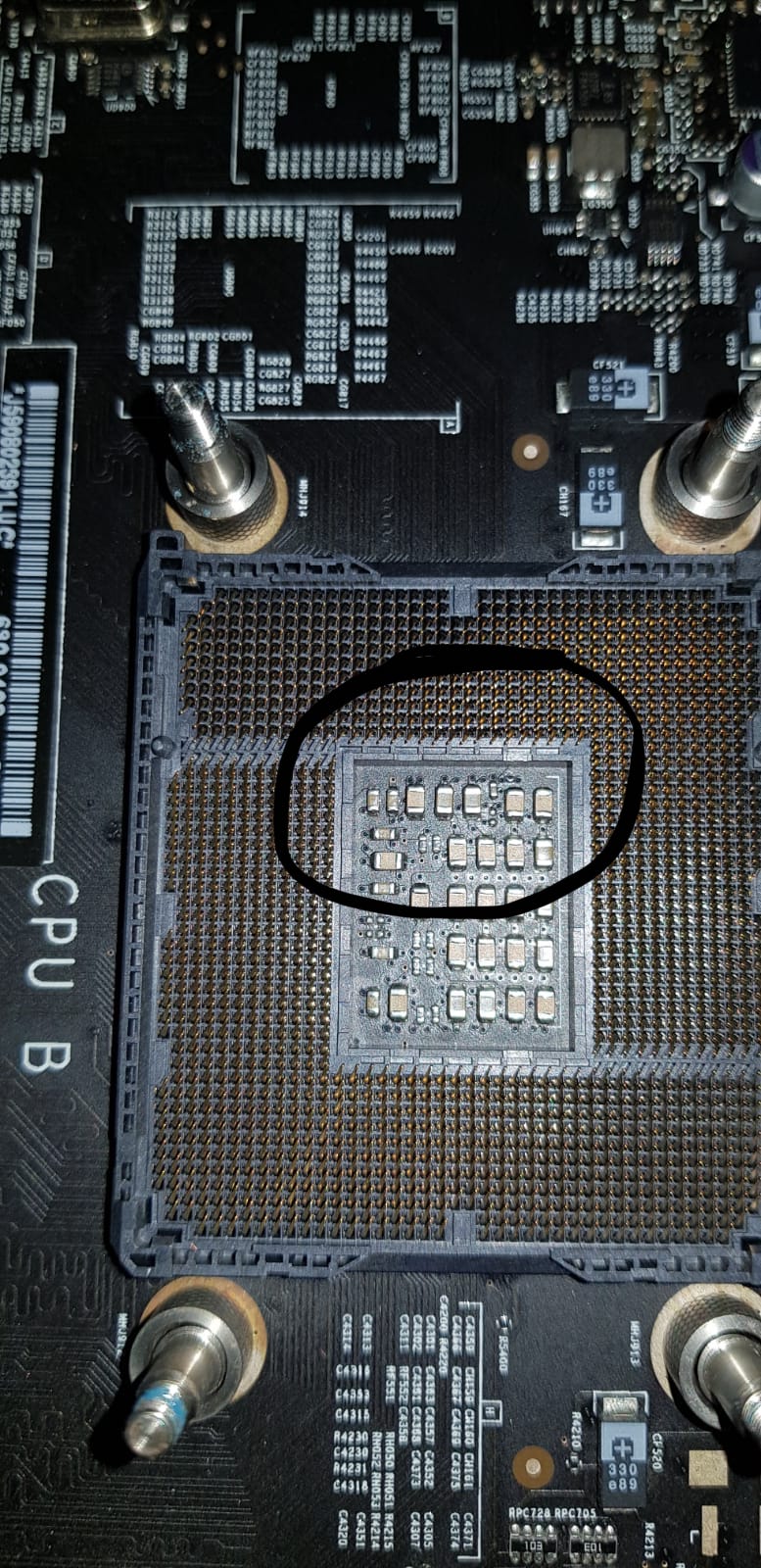

I think I have found the issue but I’m not 100% sure
It looks like there is a row of pins out of alignment and also looks as if there is one higher than the rest I have tried it but still no go so far.
I’m thinking it’s either a Bad SMC or the Northbridge is faulty if it’s called that
Able to take a close up picture of the pins?
Much more likely to be socket damage than a suddenly bad IC, especially since it did work when it first arrived
Here is a pic I dunno if it will show up ?

most the time it will be a bent pin/bad cpu or wrong cpu/miss matched cpu's /dust dirt/not corectly montedheatsinks or cpu's
i dont think iv seen a SMC go bad on a cpu tray
if you have a good light bring it to the side and cirlce around, as the light moves it may help show where the problem is, can be hard to spot some times
Hard to tell anything from that photo as needs to be bigger/more close up.
I'm not saying it's impossible but it's really really really unusual to just have an SMC or tray 'go bad', it's normally damage that does them in...
