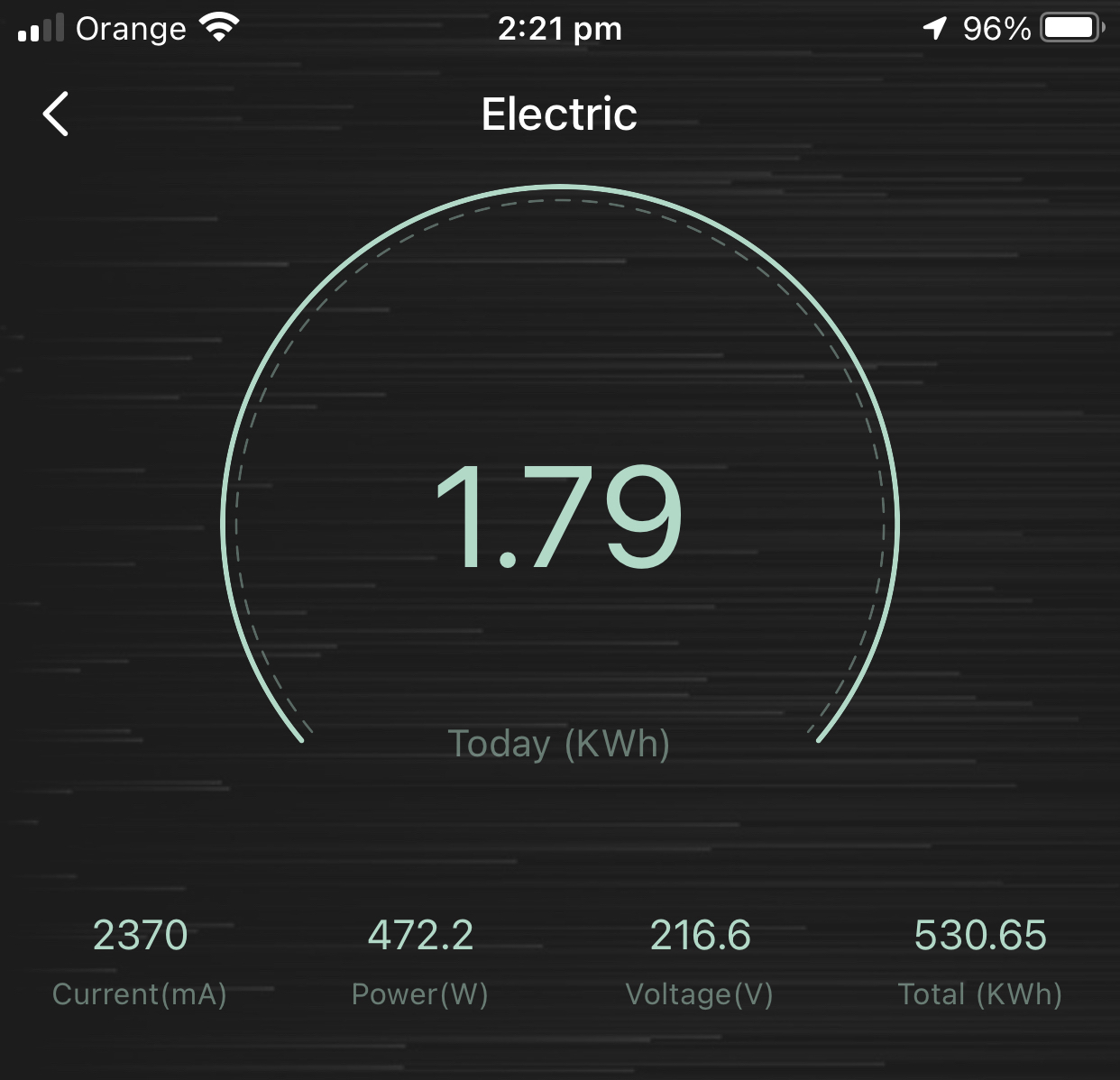

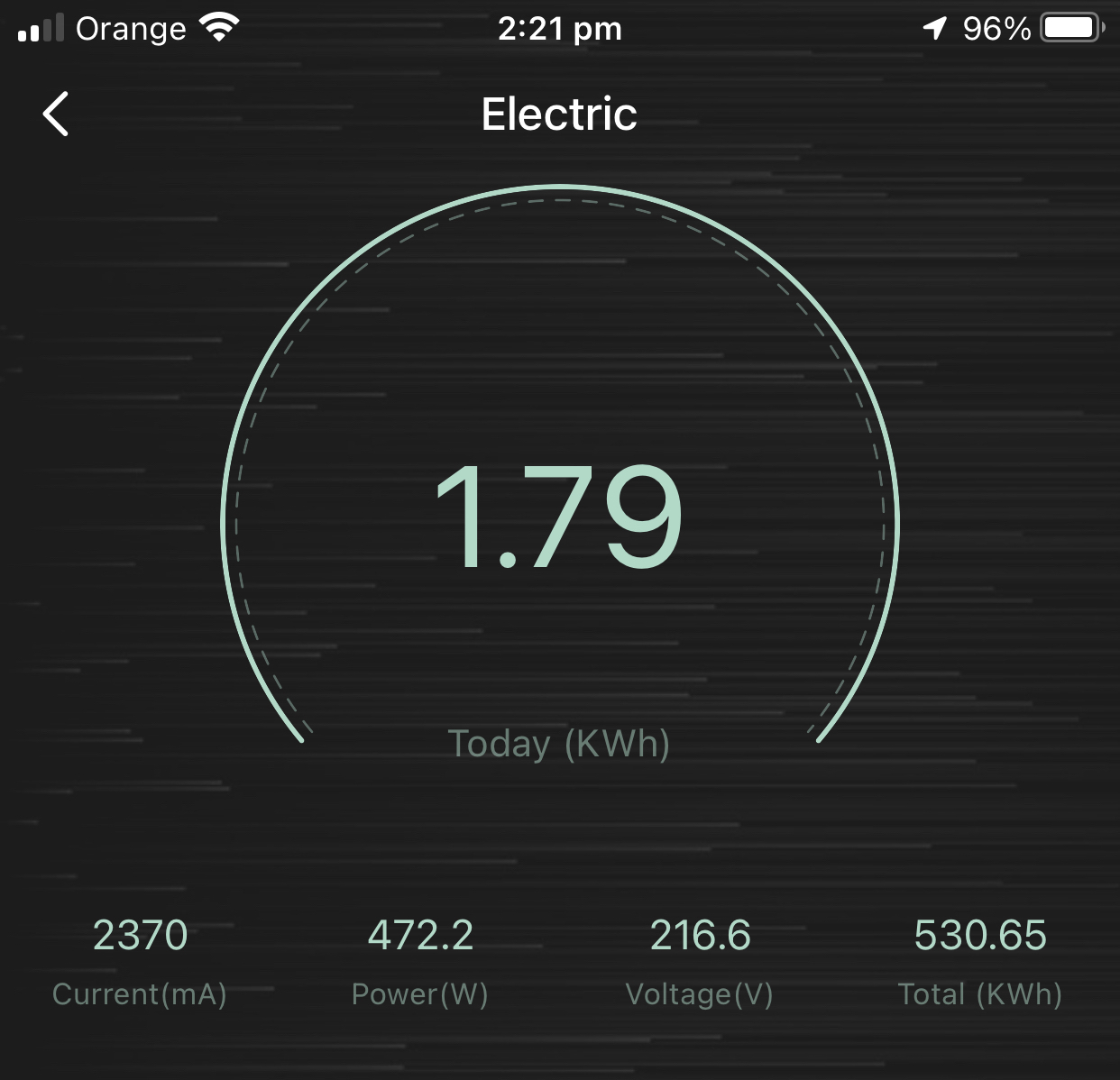

While I use a 5,1 as a main computer for years now, it is an extremely power hungry machine even doing nothing. Here it is with two X5690s, 3 NVMe drives (no spinners) and a single Safari window, the very one I am typing this text into, opened:
In regards of a NAS, I am well catered with a Dell OptiPlex 7060 running a number of VMs under ESXi and a "dumb" (non-NAS) 4-disk enclosure hooked to it via USB3. Total power consumption of these two is below 80W.
