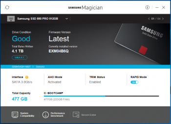

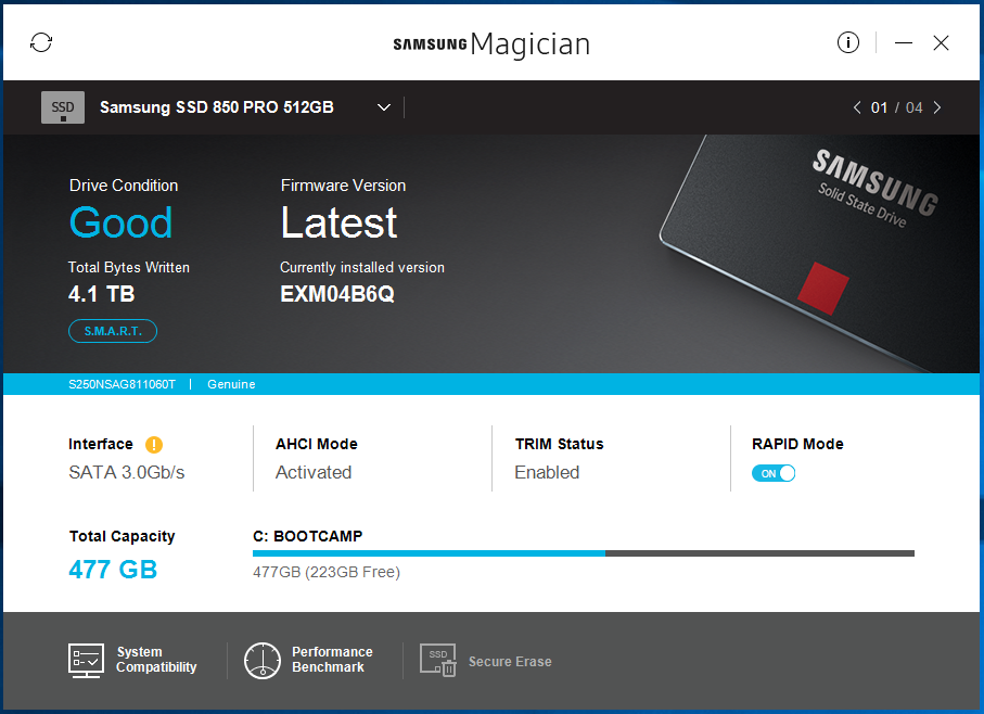

Installation in UEFI mode promotes superior benefits for bootcamp - not officially supported by Mac OS but window 10's latest installation ISO file seems to have found a reliable way to make it seamlessly compatible. AHCI mode is activated for full SATA II speed with improved overall responsiveness on SSD. Rapid mode on Samsung SSD is enabled as well. Installation process can be quite tricky but is well worth at the end.
