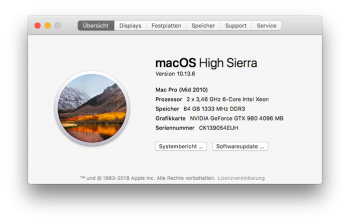

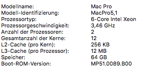

Hi everyone, this is my very first post here and im wondering if someone can help me out with my little problem or point me to the most relevant thread.
Sorry in andvance if this problem was is already discussed, there so many threads and i could not find the right one. 🙁
I have a flashed NVIDIA GeForce GTX 980 4096 MB and everything works fine so far with the latest web driver (17G3025 / 387.10.10.10.40.108).
The only thing, when i start my mac, he don´t boot right away. I have to press the "alt" key to select my SSD drive where High Sierra is installed and then he starts as usual.
So my question: Is there any way to fix that, so if, how?
Thanks for any help!
My current Setup:

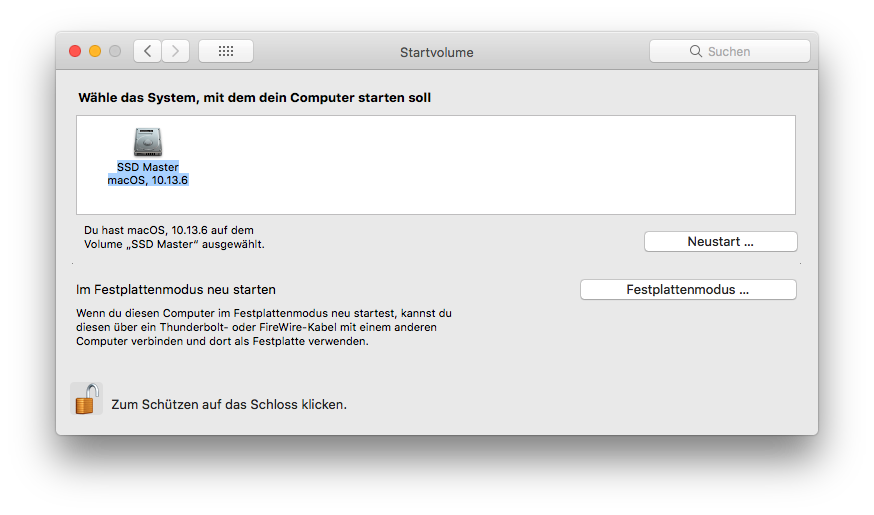

Perhaps try System Preferences > Startup Disk and make sure that your disk is selected.
Since you have a flashed card, you can alway a perform a PRAM reset, then select the boot drive (and web driver) again.

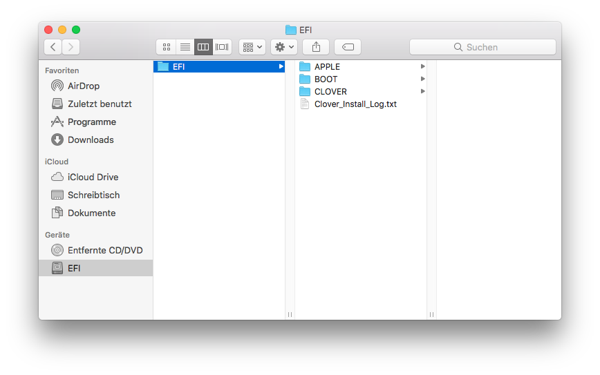

Multibest is the software to make macOS installer for Hackintosh.
What you actually installed is Clover.
You can simply mount the EFI partition and delete the associated folder. (WARNING: Deleted the wrong folder / file can completely kill the OS)
Or simply leave at there. The PRAM reset will make your Mac ignore it during boot anyway.

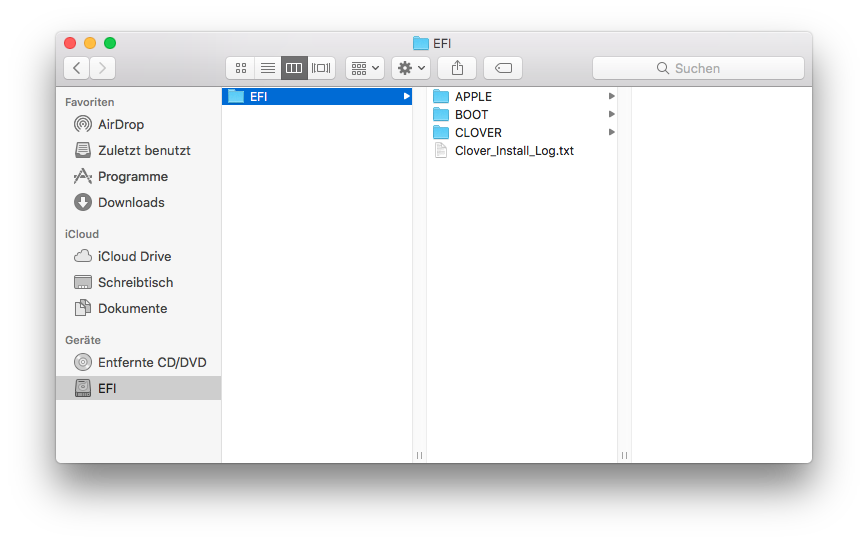

I´ll rather have a clean Mac 😉

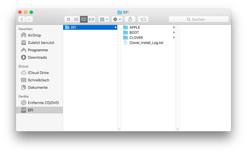

I managed to mount the efi partion from the terminal. Which folders do I have to delete? Just the clover folder?
I was concernd to damage somehow my hardware?! Is that possible with clover?
I was concernd to damage somehow my hardware?! Is that possible with clover? View attachment 804137
It can't damage the hardware by removing the wrong files / folder.

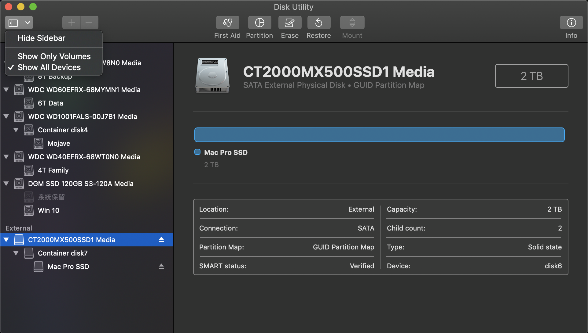

Make sure you set "Show All Devices", and then select the DISK, not the container, not the partition.
Then "Erase" it.
Thats good to know! I was afraid a litte bit. 🙂
I solved that right now. The terminal did magic for me, all partitions where erased with the following command:
diskutil apfs deleteContainer disk0s1 (in my case disk1)
Otherwise it was not possible in my case, even if you show all devices.
In my opinion the cleanest solution to get rid of the Clover EFI partition. 🙂

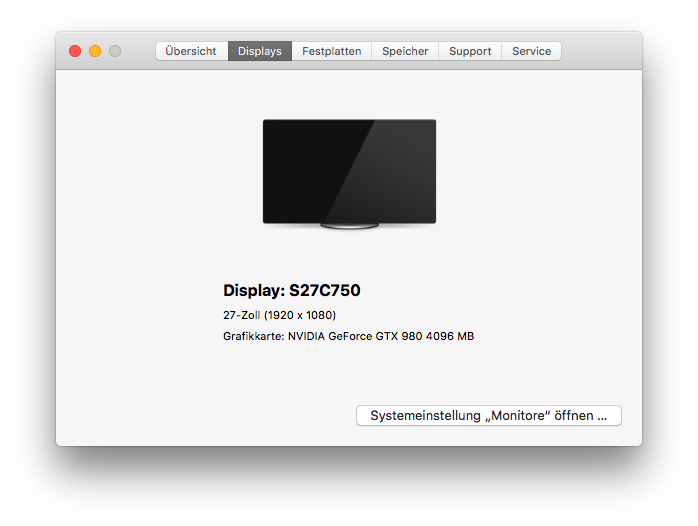

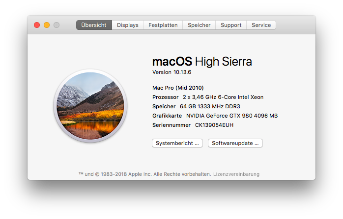

Back again to my boot problem with my flashed NVIDIA GeForce GTX 980 4096 MB.
I tried it with a SMC reset = no luck!
Mac Pro starts normal after SMC, selecting the WebDiver, Restart = same problem!
I did a fresh reinstall of High Sierra to the latest version = no luck

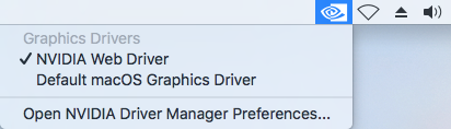

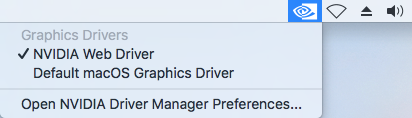

Nvidia Card is working! NVIDIA Web Diver is working! I have no glitches, so acceleration works fine...

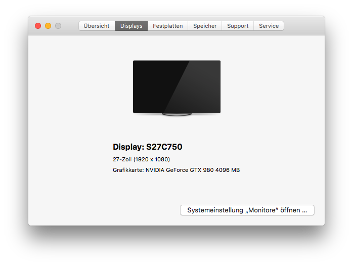

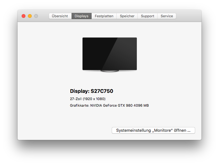

I really don't know why my Mac Pro don't power on the Monitor or boot as usual after a restart.
The Monitor is a Samsung, connected with HDMI Displayport.
Only when press the ALT key while booting and select my SSD, everything works normal.

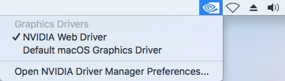

I also guess, I don't need to work with these terminal commands: because my Mac Pro is using it!?!
sudo nvram boot-args="nv_disable=1 (disables the standard driver in OS X)
sudo nvram boot-args="nvda_drv=1" (force to use NVIDIA Web Diver)
I could live with that little problem but it would be nicer when everything is working as it should.
Does anybody have any ideas what that can be? 🙁

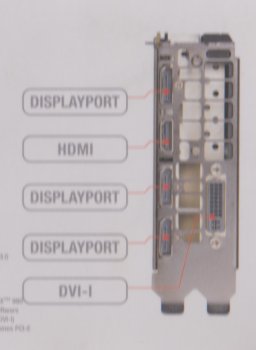

The GPU port layout is correct and looks exactly like my 980TI.

- After finishing install, im updating OS X, and then i changed the GPU (Geforce GTX 980 SC)
- Needed a SMC reset. Then the Monitor powered on, at the Login u could see that u need a driver.
- Then I installed the WebDriver.
The GPU & Driver are working fine, last time I tried a 2nd Monitor and it worked too.
Like I said, the problem is only when I restart and while booting up. Monitor won't power up,
it seams there is no signal, only the ALT "Key" wake him up.
Then I select my Drive - and everything is normal.
So it should work?! 😉
