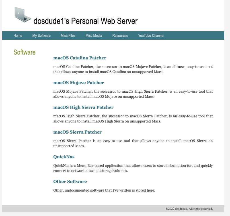

It did do an install onto a thumb drive with Monterey though using Dosdude's software.
Not even possible, you are mistaking something here. Dosdude stoped patching unsupported macOS releases with Catalina, years ago, see for yourself:

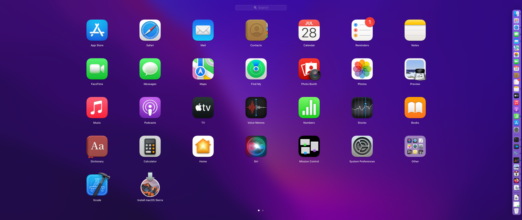

Apple offer official links, this is the support page, go to the "Use the App Store" section.

Sierra and earlier releases are available from Apple servers OUTSIDE the App Store - "Use a web browser" section of the support article - just clean install Sierra to a spare disk instead.
It will be just a way to get you online again and later you can nuke it.

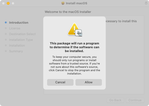

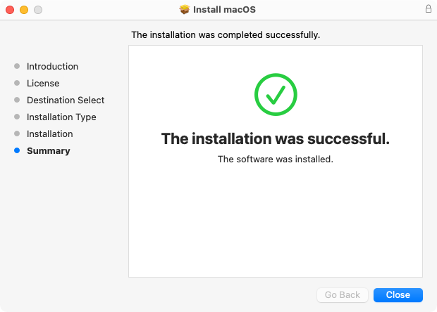

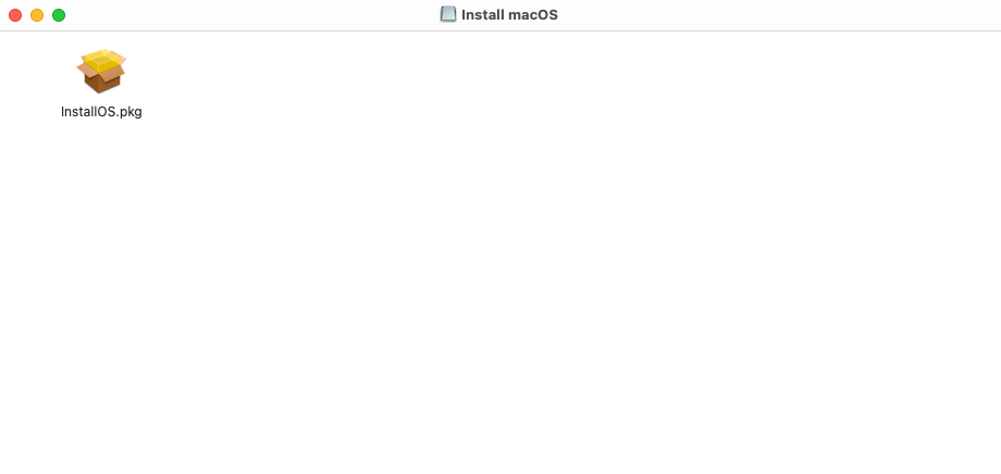

You'll need to open the InstallOS.dmg downloaded from Apple and run the InstallOS.pkg installer for Sierra to go to the Applications folder, after the installer is correctly placed into the Applications folder, you can then run createinstallmedia to make a USB installer of Sierra.
Btw, this is working perfectly fine, just downloaded it, opened, run InstallOS.pkg and Sierra is now on my Applications folder with my MacPro6,1 running 12.6.8.

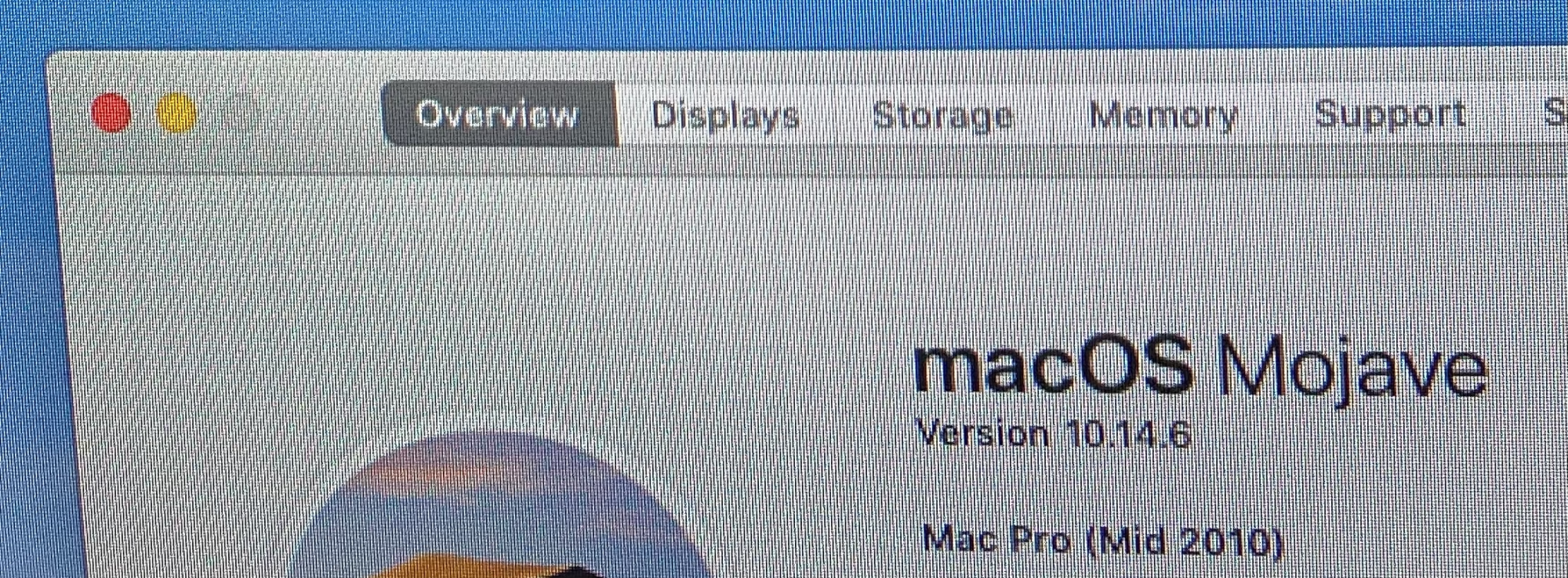

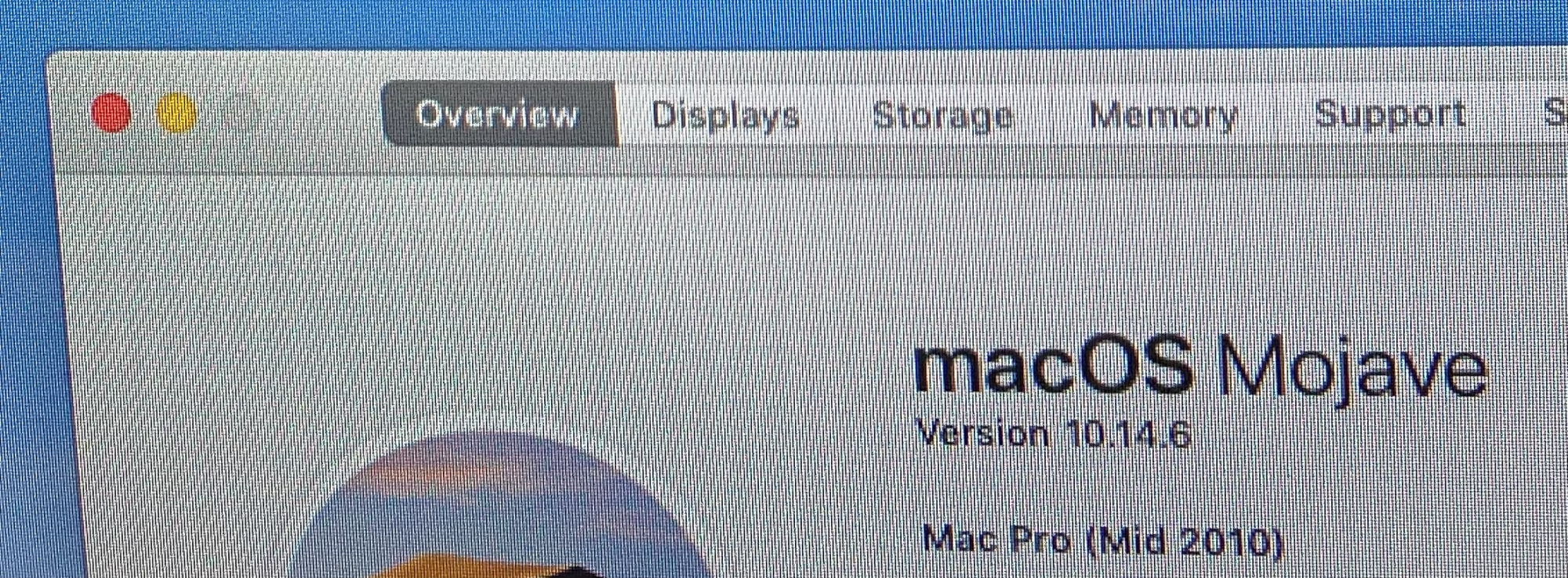

What has now happened to me:
Booted on a Carbon Cloner copied SSD drive which was a copy I made of the Mojave SSD I have been using as a boot drive. This copy was made a few days ago.
Booted from that SSD drive (still no internet on that drive, which as said runs Mojave)
Formatted the normal boot Mojave Drive SSD. I presumed it was failing as Disk Utility hung. It's an el cheap Green WD SSD, so I ordered another SSD drive.
Installed a 250 GB SSD into an ATI port (one of the top DVD enclosure spaces), which was an old OS.
Removed the RX 580 Card and put in the 5570.
Put in the install thumb drive with Mojave download (sourced from Dosdude and installed with his software.
Had the (maybe faulty) just erased SSD drive formatted as APFS in one of the 5,1's drive bays.
I left the RAID card in the machine.
I rebooted and an install instruction came up. I approved.
The machine rebooted and the disk drive choices were provided. I selected the Mojave SSD drive.

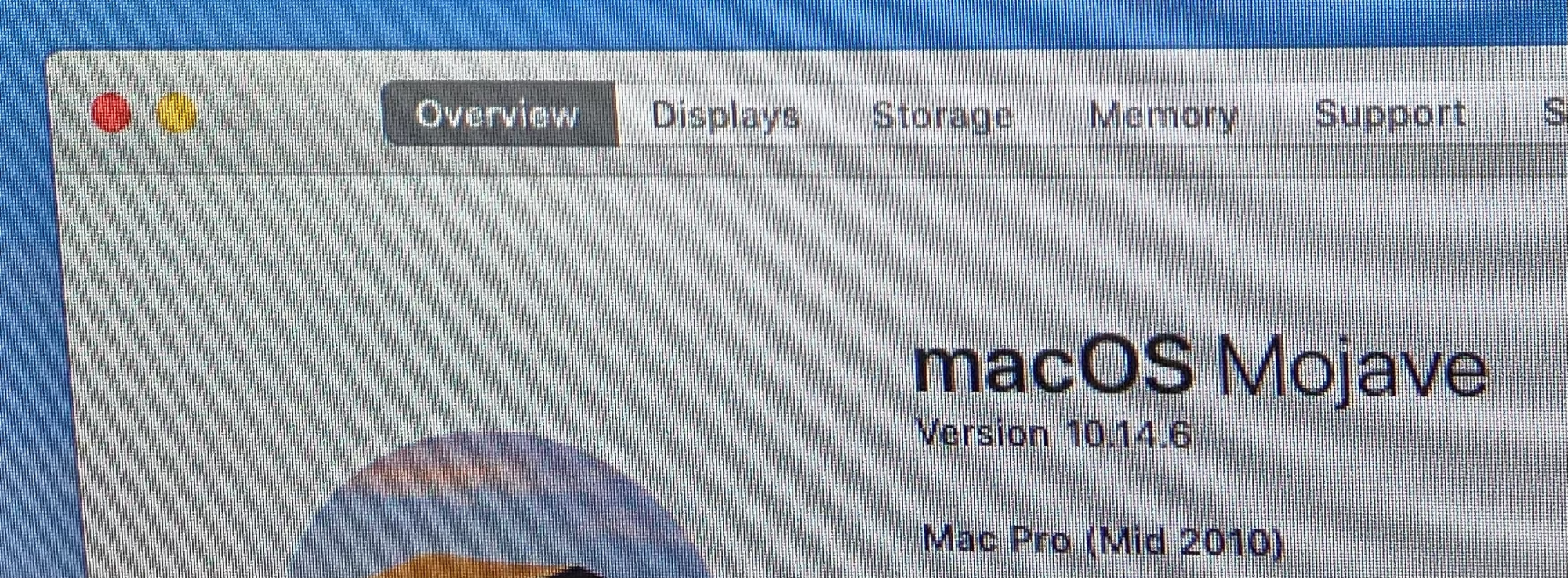

The machine booted in Mojave, 10.14.6.
The internet is now working.
I also re-booted with the option key down, and there were three boot options showing - the thumb drive, the 250 GB (OS 10.9.1) and the now installed SSD based Mojave.
I chose the 10.9 drive, and it booted fine.
I then restarted and it showed boot options, and I chose the Mojave SSD. It booted, and the screen works fine.
I will now install the 580 metal GPU.
I did not realise the 5770 card runs Mojave though, as I thought it required a metal GPU. It seems it does not.
And yes tsialex, looking forward to getting boot choices with the 580 card. It's a recommended Sapphire branded 8 GB version. Thanks again for your efforts, they are fabulous.

This is running with the original 5770 GPU. I did not realise it could run in Mojave.
After you installed Mojave with a METAL GPU, you can boot it with an AppleOEM non-METAL GPU and even some PC GPUs, but it's now using a fail-safe unaccelerated mode. Also, you can't install Mojave without a METAL supported GPU and it's so slow to run Mojave with a HD 5770 that even using the browser is painful.
Anything that requires 3D and video acceleration will work very incorrectly and Mojave native apps News, Stocks, Voice Memos and Home do not even open.
Btw, I've sent you a PM.
