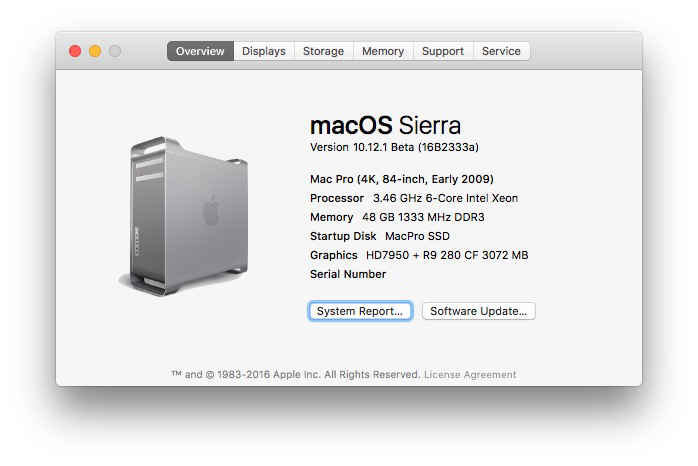

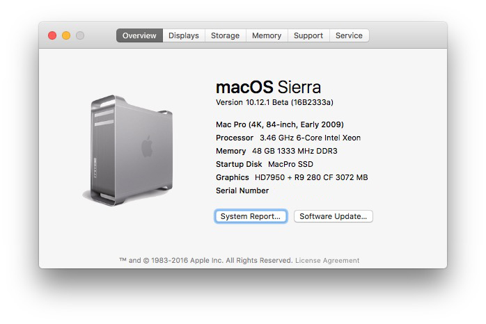

You won't see the card's name generally unless you intentionally to call out something like the "About my Mac". It won't affect anything for real daily use.
Anyway, Some info on that "About my Mac" page is editable at OS level. As you can see, I can make it display my Mac but not the Sierra picture. Make it display that I am using a 84" 4K TV, also make it display I am using a HD7950 + R9 280 Crossfire... This is just cosmetic. IMO, not bad to do that for fun, but not quite worth to pay significantly more money just for an identification which is editable.
Anyway, Some info on that "About my Mac" page is editable at OS level. As you can see, I can make it display my Mac but not the Sierra picture. Make it display that I am using a 84" TV, also make it display I am using a HD7950 + R9 280 Crossfire... This is just cosmetic. IMO, no bad to do that for fun, but not quite worth to pay significantly more money just for an identification which is editable.View attachment 728804

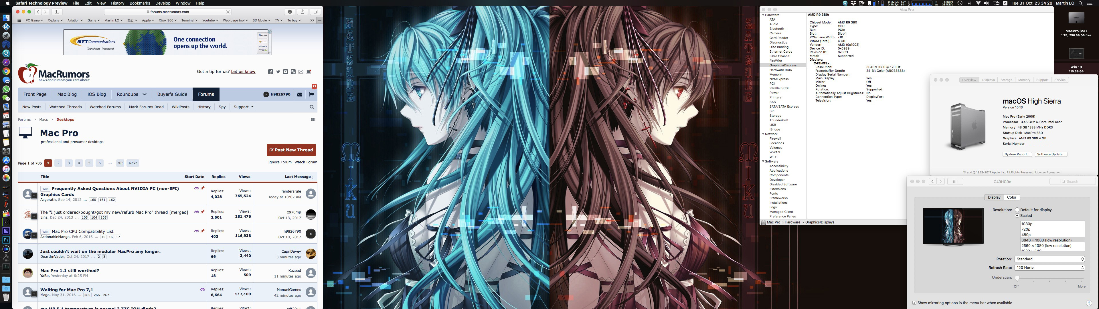

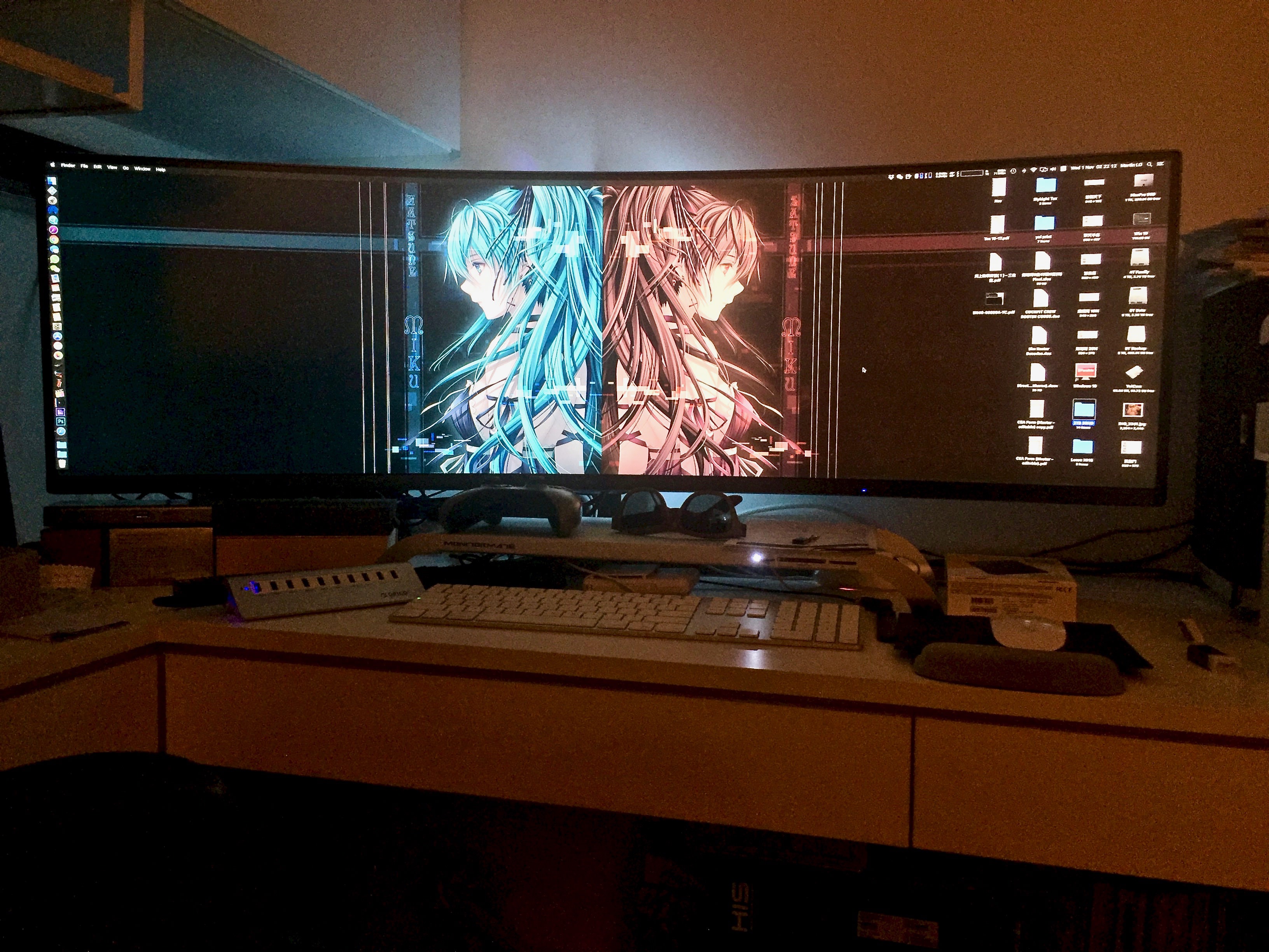

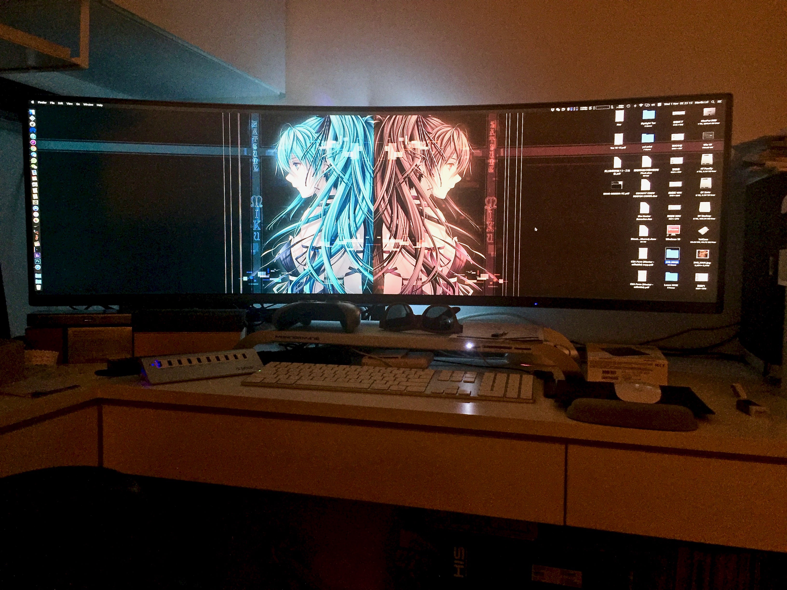

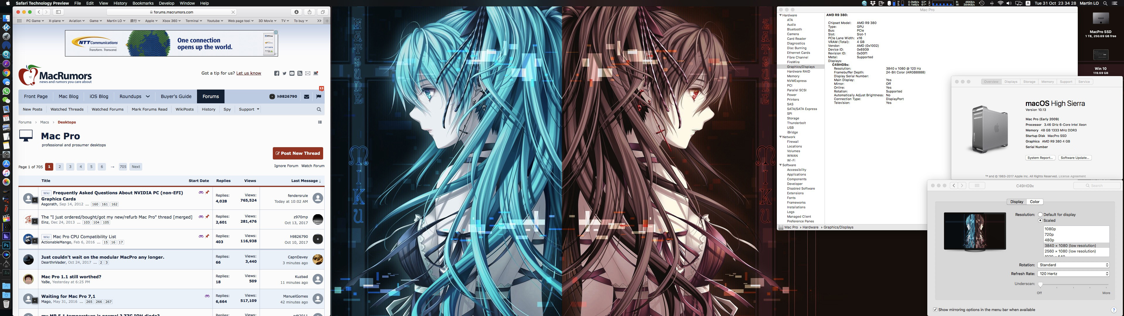

Just get the new monitor today. It's a Samsung CHG90, 32:9, 3840x1080, 144Hz. I quite like it. It's super wide, lots of room to work. The best thing is that without any gap. Now I can place 3 different sizes Windows side by side. Therefore, I can put the most important one right in front of me, make it a bit bigger, and the other 2 a bit smaller, and put them on the side as the assist windows. Very flexible, and very comfortable to use.
I also quite like the back light from the monitor. Now I can work / play comfortably with all other lights off, but can still easily read the keyboard.
