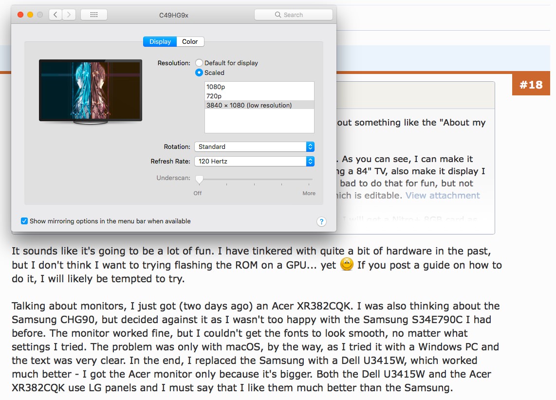

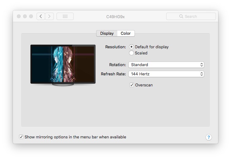

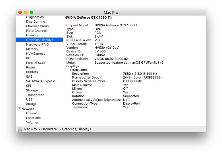

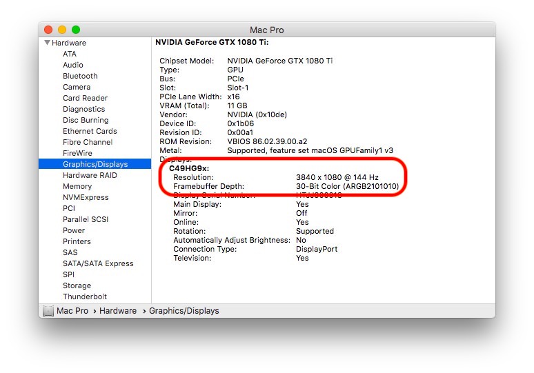

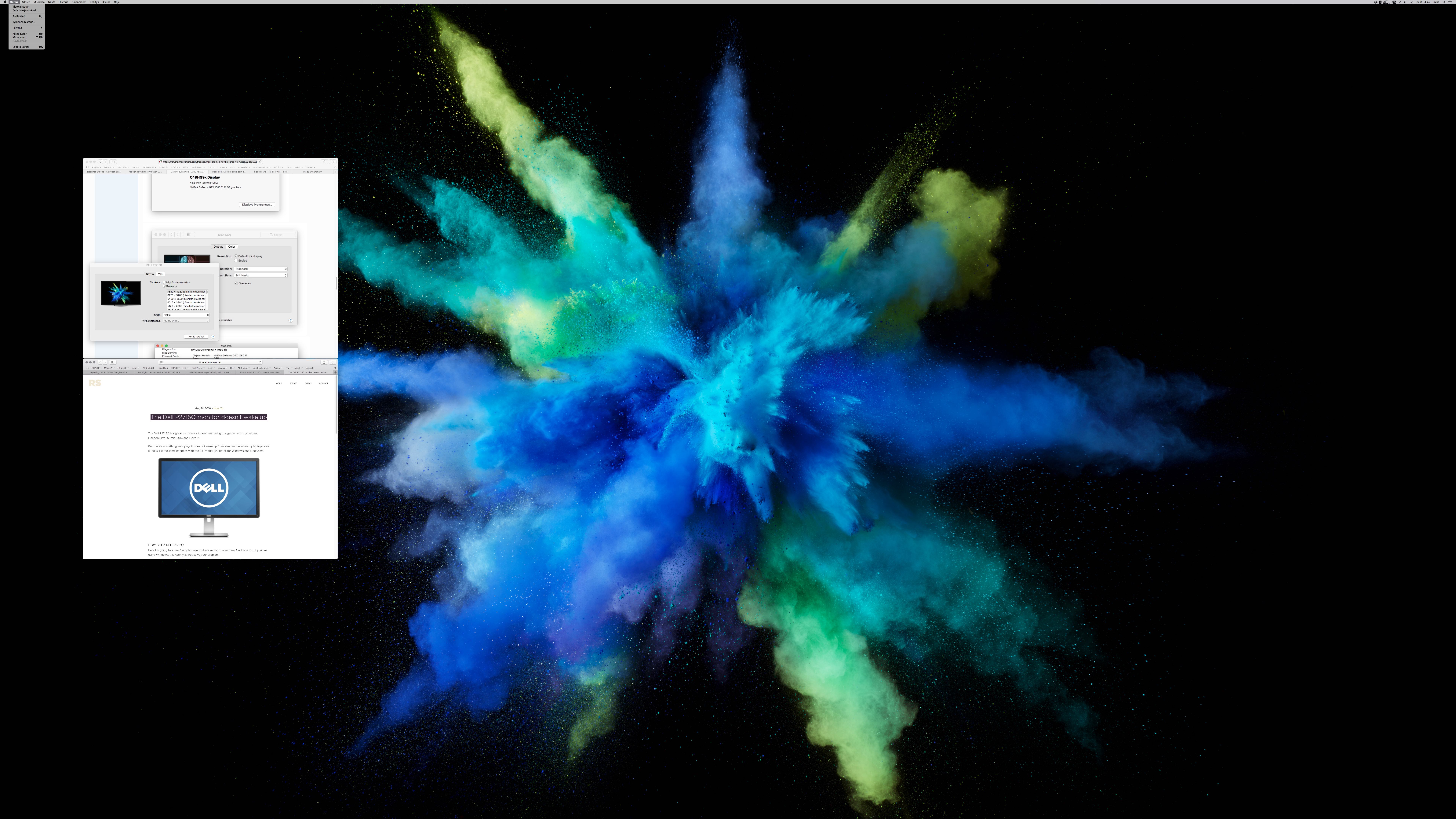

After switch to 1080Ti, discover an interesting feature. I can actually select 7680x2160 @144Hz on my CHG90. The machine will respond, and will display everything at that resolution (everything is very small on the screen. Screen capture confirmed that the GPU is actually rendering the desktop at 7680x2160.
I've seen this feature back in around 10.9.2. But once Apple release the Retina stuff. This function is gone. May be it's driver controlled. Apple took it away, and Nvidia keep it.
P.S. I have to reduce the screen capture size back to 3840x1080, otherwise the file is too large to upload. But the file info shows the original capture is at 7680x2160.

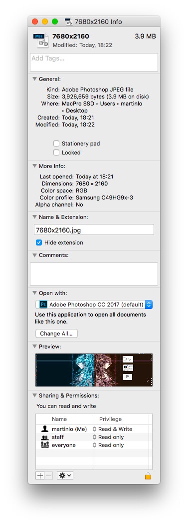

It seems like it's not about nVidia, It's in there with RX 570 too. Just tried 7680x4320. Boy are there pixels, enough for anything - huge. Compressed aggressively with jpeg, and I was able to attach my huge desktop.
