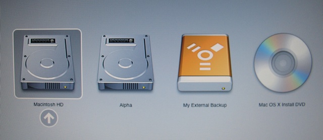

This can be misleading. Do you have the Apple BootPicker when you power-on and press/keep pressed ALT?

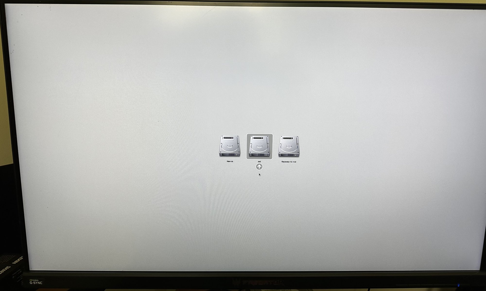

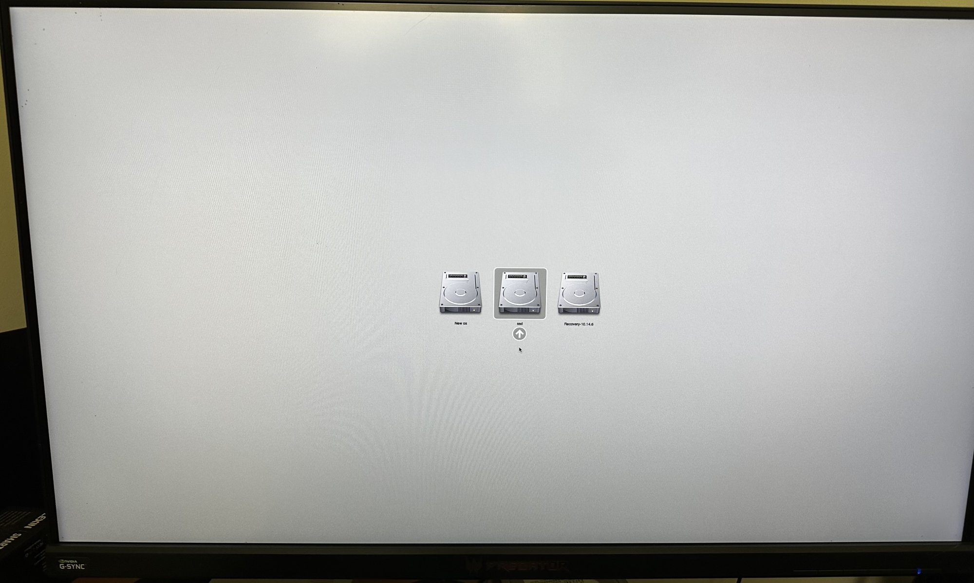

Thanks for all the responses and assistance folks, a little update (i rarely turn my mac pro off as its my main workdstation and i couldnt find a wired usb keyboard lol). So this morning i raised my Wife's 5.1 and borrowed her keyboard (yes this exercise is being applied to 2 machines eventually).
So on start holding alt on the wired board i get the following disk selection screen -
That means your RX580 is flashed, and you can continue to install Monterey (my recommendation) onto your cMP via OpenCore. Ventura also works via OCLP, but I personally don't recommend that for anyone who don't know what's going on behind the scence (heavily patched system files to avoid AVX2, and possible sysem break down after every single macOS update).
