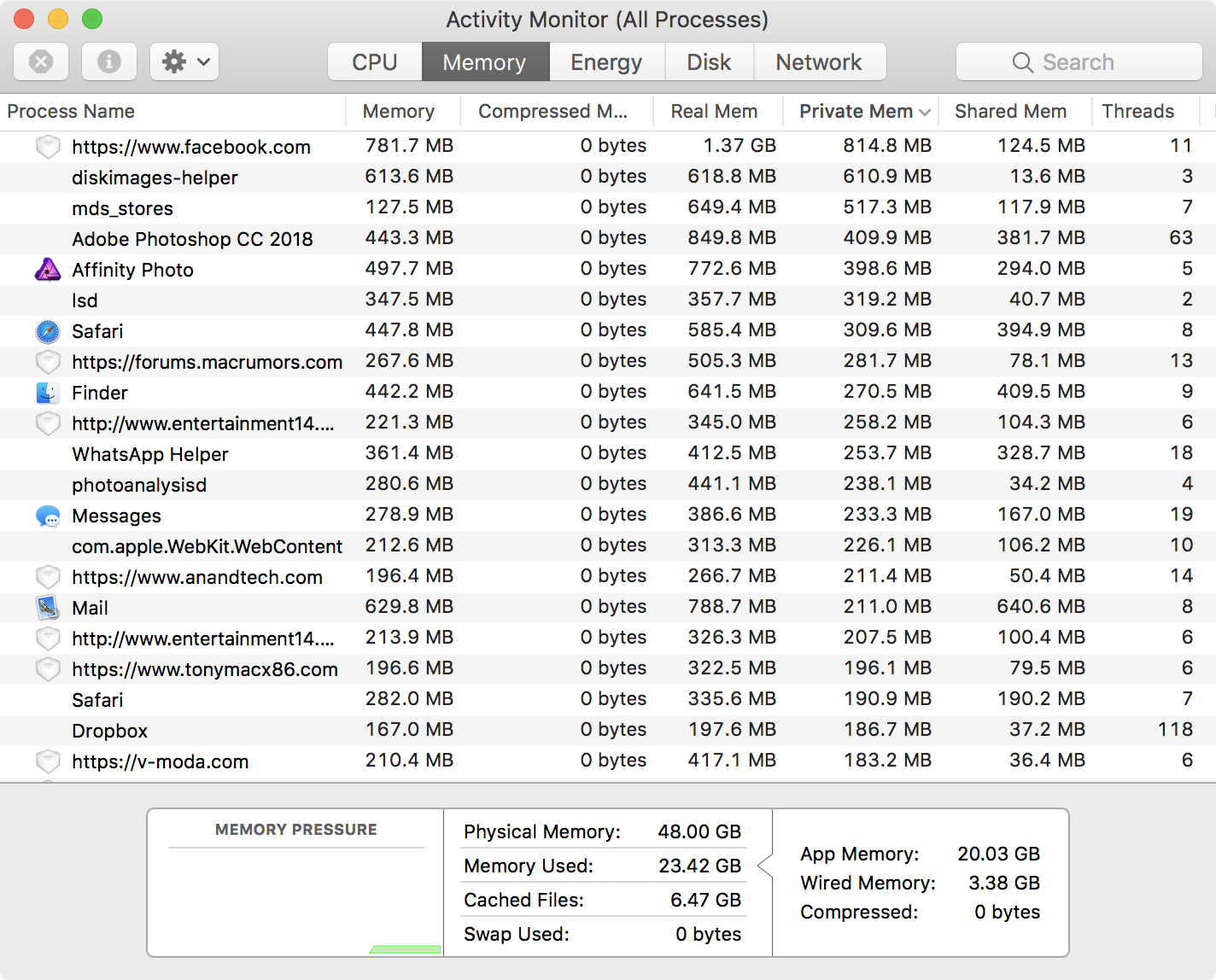

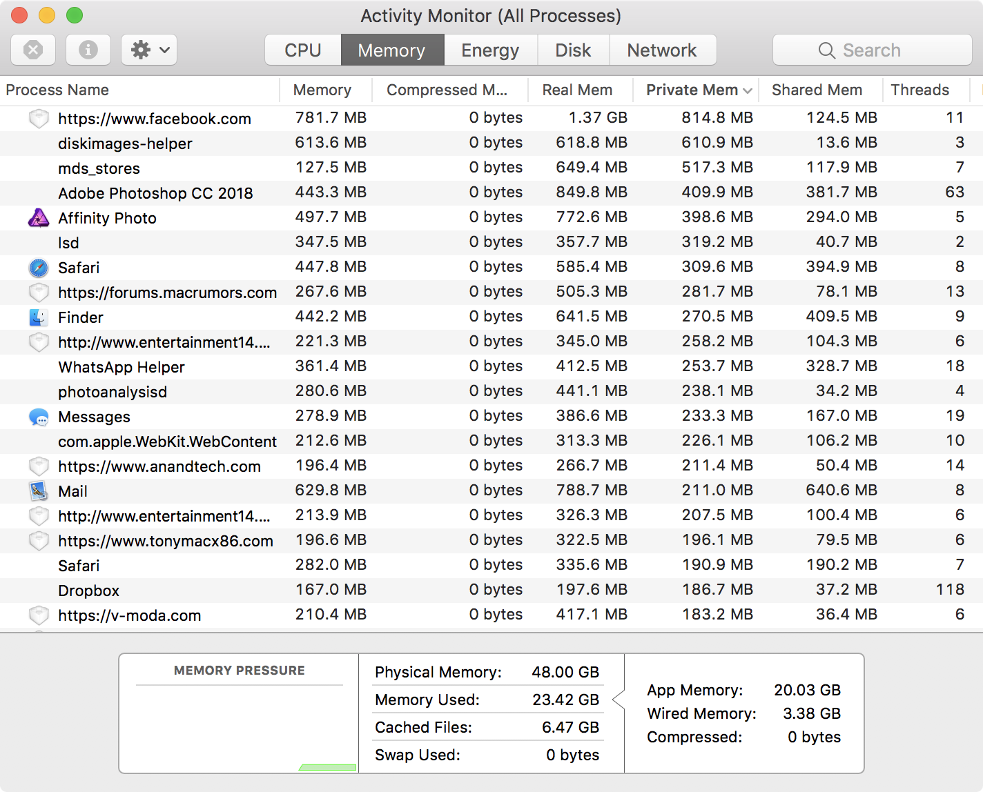

TBH, you only need the hardware good for your workflow.
12 cores is virtually completely useless for LR / PS. W3680 is almost the fastest you can get.
96GB RAM also way overkill for most usage. In my own observation, my cMP usually stay at around 24GB memory usage.
I just check my current memory usage, and bingo, very close to 24GB again. (This is with PS, BR, and Affinity Photo opened)

So, assuming your usage is not much more demanding than I do. 24GB is good enough, the extra RAM can serve as OS cache to further speed up some operation, but that's really base on if you work flow need to regularly access the same data from the storage, if not, then it won't help much.

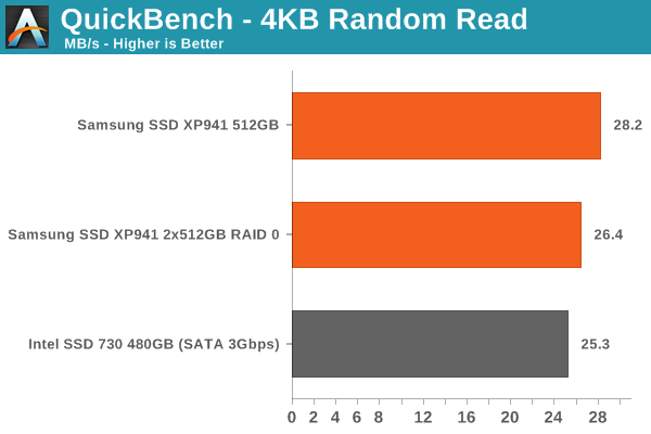

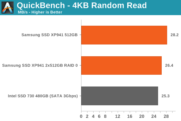

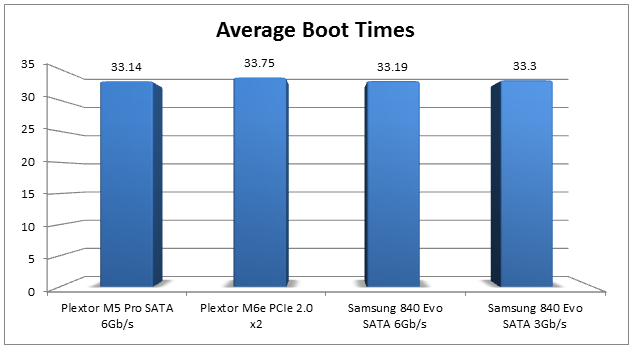

That's exactly what I want to say, you won't get any snappier experience.
Your system's snappiness mainly depends on the 4k random read speed (of course, I mean when there is no other limitation. e.g. you system has plenty of memory), not the sequential speed.
And this is the fact.
Even though you upgrade to a PCIe SSD, the 4k random read speed still at the 30MB/s range, way way below the SATA II connection limit (250MB/s). And it's also true for your SSD. The bottleneck (of snappiness) is not at there, further improve the bandwidth won't help. And yes, I intentionally to post this graph to illustrate that RAID 0 also won't help, but can make it worse. Quite a few people love to use RAID 0 for their boot drive (or even SSD RAID 0). That may be doing exactly the opposite what they want.
I know boot time is NOT everything, but it's a good indication about system snappiness. And guess what?
SATA II, SATA III, PCIe connection... give out virtually identical boot time on a same system. That means, no snappiness improvement by moving from SATA II to SATA III.
However, copying files or some (un)zipping operation can be faster with SATA III connection. It depends on how often you do this kind of operation, so that you can benefit from higher sequential speed.

To be fair, the xp941 is a first generation Samsung SATA Express AHCI ssd from 2013. Samsung is set to release the 5th generation PCIe ssd's within 30 days. Performance has scaled tremendously over the last 5 years
