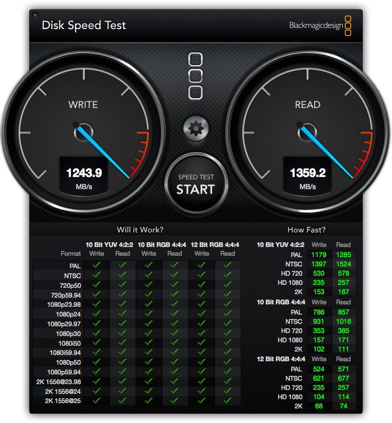

Just a quick update to share my joy with you guys...I returned the 950 PRO and got an SM951 AHCI.
Quickly cloned the MAC OS X drive into the new SSD and voilà! It boots and the speeds are phenomenal 🙂
The SM951 is the same as I'm looking at for my upcoming 5.1 purchase. Good to know it's as fast as claimed.

Was that a 256GB SM951? I think the 512GB drive is even faster! Write speed anyway.
Yes, it is the 256GB version.
[doublepost=1453210870][/doublepost]And I also did the "enabletrim" thing through terminal and it worked easily and painless 🙂
