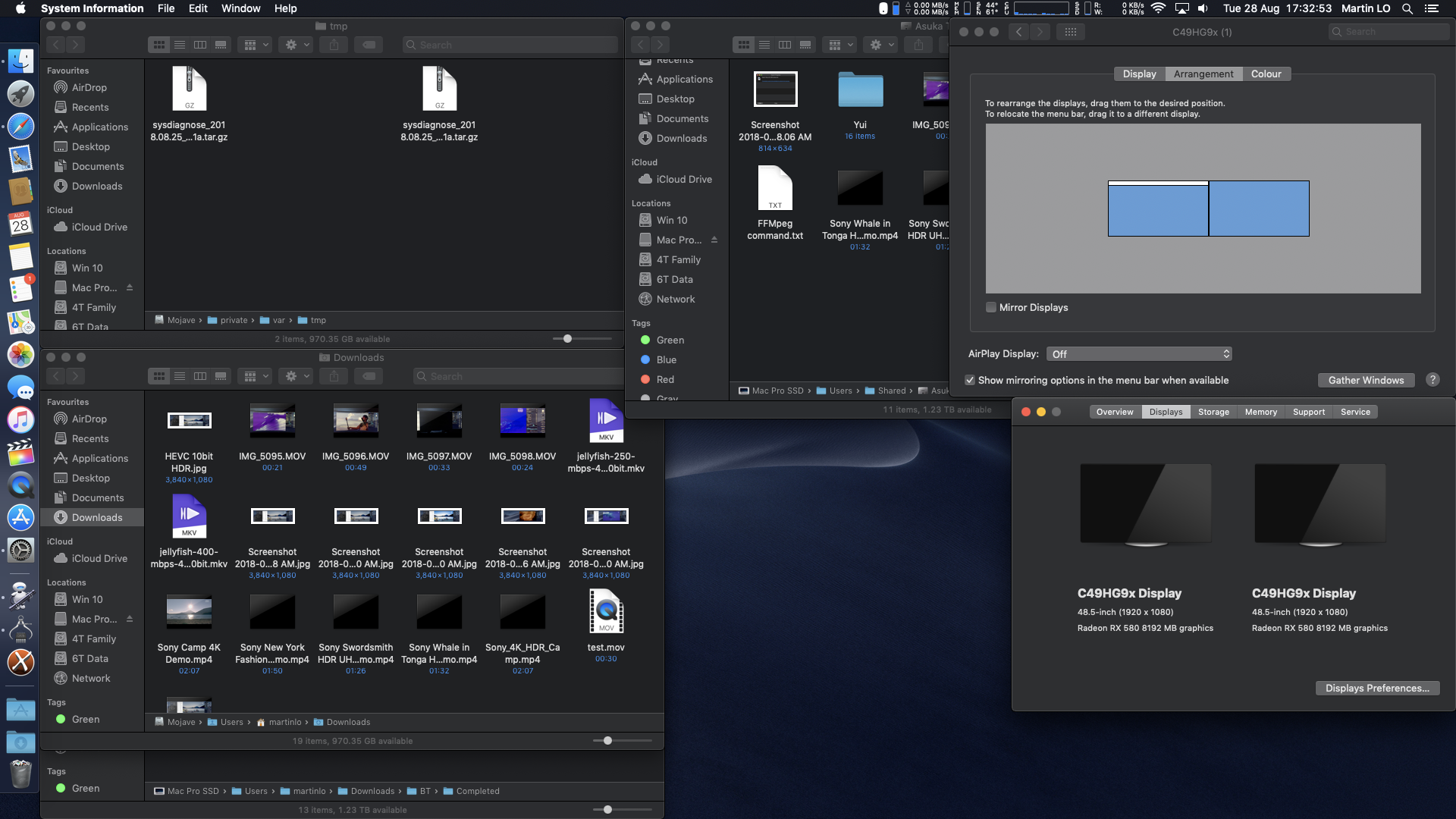

I open a bug report in Apple, and have reply already. So, the Apple engineers may be working on it.
But anyway, my 49" 32:9 monitor can be use as 2x 27" 16:9 monitor. I connected both input to the PULSE RX580, and use it as two monitors side by side. Loading, temperature, fan speed all normal. No restart.

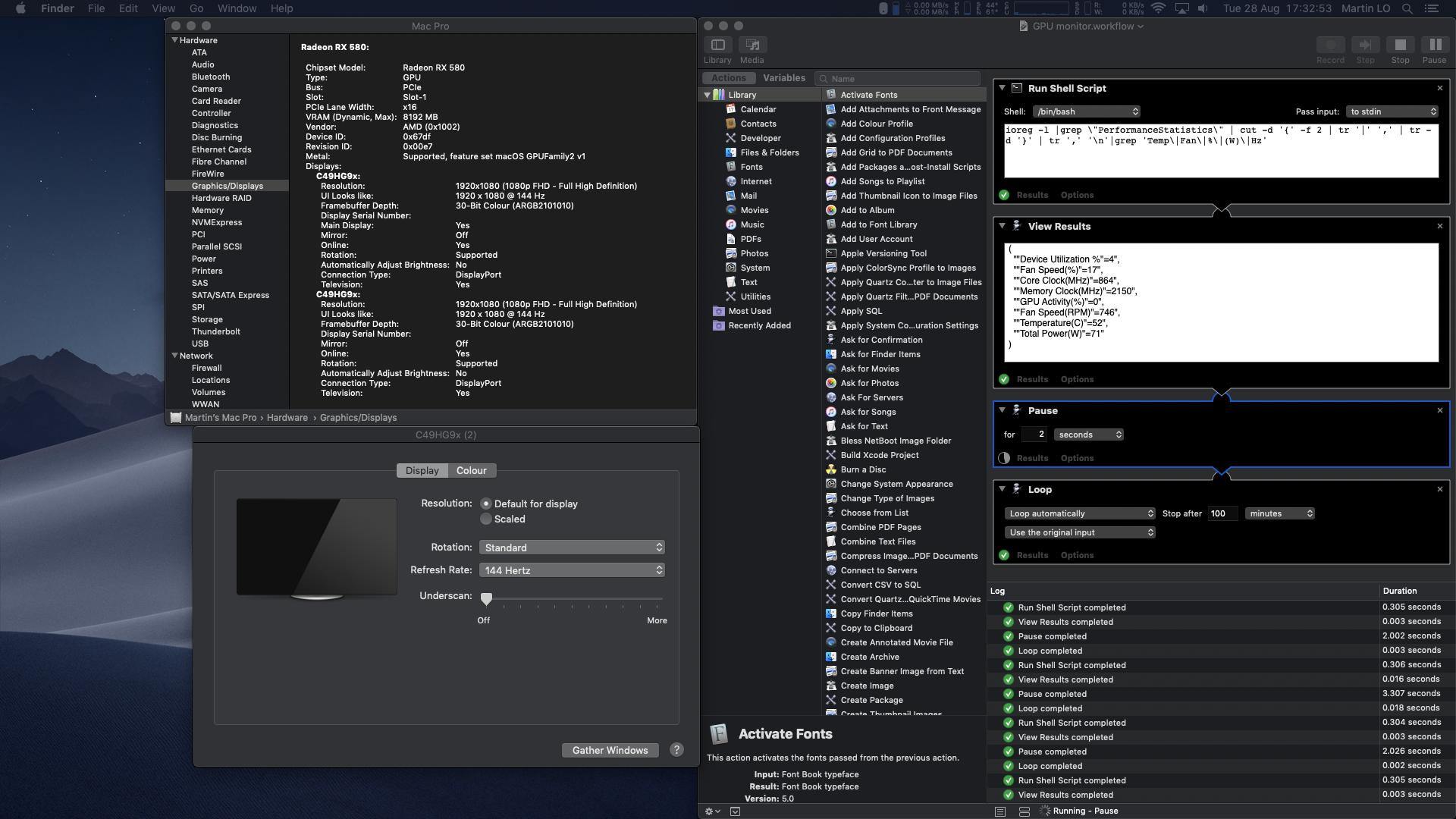

If you want to monitor the GPU parameters, this automator workflow can do it.
Just unzip the attachment, double click it (automator should open automatically with the workflow loaded), then click "run" on the upper right hand corner.
The View Results windows will display the GPU parameter and update every 2 seconds. (Note, that Total Power is NOT the GPU's power consumption but something else. So, don't worry about it)

First of all, thanks h9826790 for the automator workflow, it allowed me to investigate further…
(Also, under Sierra it only displays the device utilization)

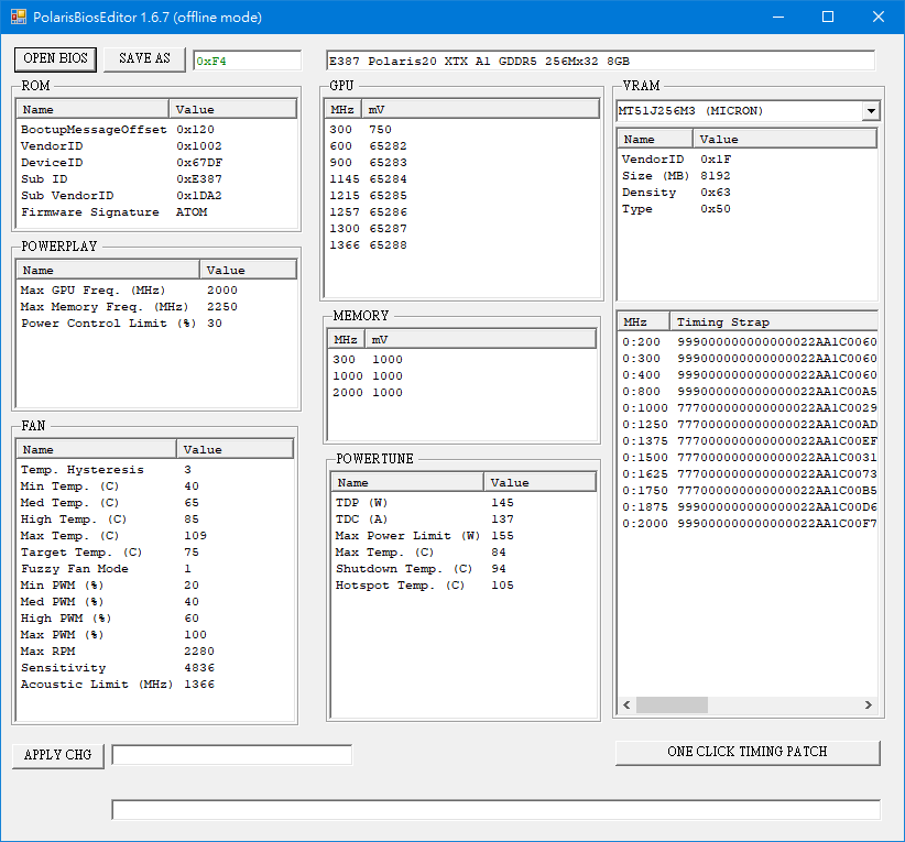

However, it's possible to mod the ROM's fan profile.
