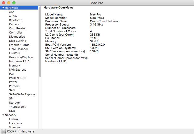

Just check, System Information > Hardware > BootROM version.
