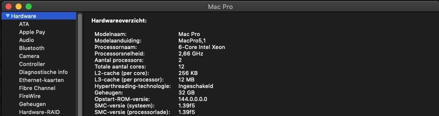

Hi all,
Well i have the same issues with a flashed 580 card. And was hoping that somebody found the solution.
Did many test installs even with dosdude , upgrade HS volumes to Mojave clean install even now to Catalina and still reboots freezes and have good split cables what came with the GPU from Ebay.
Had also green red orange and many strange color screens.
I try to do install on a sep harddrive but I don't think its the HD with volumes. its software or GPU hardware
Ok I read further here that a 4K display could cause troubles. I have a display port 1.2 version monitor.
Running display port is then the problem?
If i do DVI (lower res unfortunately) or HDMI will be better? I try that.
Attachement is my details

Hi all,
I solved the problem by replacing the power supply. I think it was on it's way out, but the extra power that the 580 was drawing was making it fail more often. As soon as I got a refurbished power supply and installed it, I never had a freeze or crash since.
Thx Jayson, I am first looking if I still have the same problems with another GPU a 7970 what I have.
Thats the one what I normal used in the machine but not allowed me to do the firmware updates. I come back at it...

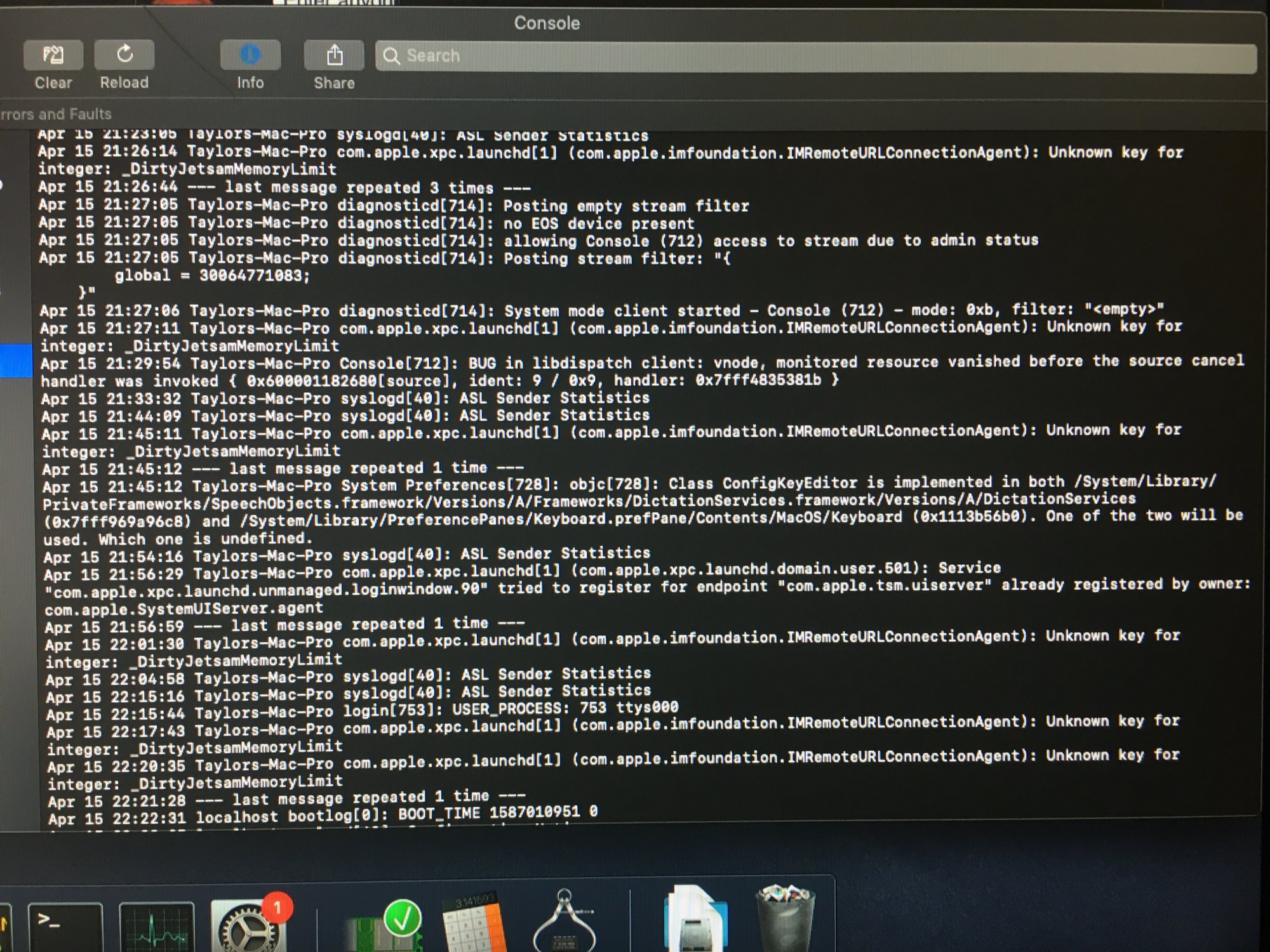

I'm in the exact same boat here, got a 5,1 with a Sapphire Pulse RX 580, High Sierra 10.13.6, BootROM 144.0.0.0.0 and random freezes when only casually using the computer. Sometimes the computer will restart itself, sometimes I have to restart it manually. Moreover it seems to only happen when Safari is up and doing stuff. I've been using Firefox all morning and the only restart I had was after I pulled Safari up and started using it.
Nothing appears in my logs that indicates the system even knew it crashed.
The other thing I've notices is that the freezes occur after periods of intense use. I ran Logic, Call of Duty, LuxMark stress tests, a ton of Firefox tabs and a 4k YouTube video all simultaneously and had zero hiccups. Only after closing down all the intense stuff did the freeze happen.
I would like to somehow solidly convict the power supply for the issue before forking out the dough.
Reactions: zoltm
I've had my RX580 for almost 18 months. When I first installed it, and I was probably running 13.x, I had random issues, like a seeming restart and some freezes. Issues happened while working in FCPX and browsing in Safari. It was bothersome enough that I RMA'd the card. But the replacement didn't seem to help. I think the thing that helped was updating to 10.14. I don't recall any of this bad behavior over the last several months.
The more I mess with my computer, the more consistent the results:
Using Safari, particularly after a GPU-heavy event, almost always results in a freeze-reboot within five minutes, sometimes as quickly as 30 seconds.
Happened just barely. I played some games, ate dessert, browsed the web on FireFox. No issues for three and a half hours. Opened Safari (no extensions). Freeze and reboot within 30 seconds.
System.log at the time of the crash:
