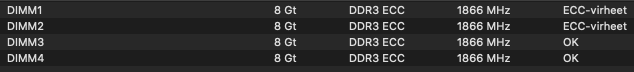

I have this 2013 mac pro and no matter if i put a brand new pair of tested ECC memory into one of the Mac Pros memory slot it shows after
2-3 restart it has ECC...
I tried to swap the memory module with the other slot and the ECC error stays for a while then goes then comes back on the same slot.
Any suggestion?
Can be the CPU messing with me having memory chanell issues or the memory slot itself?
Did you solve this, ? I have an error on 1&3 but not 2&4. sometimes restarts when they are populated.
Well ill order a 10 core and try it, thats the best bet and i can always resell if no go. as the ram talks direct to the cpu and the slots look ok .... its a fair bet.

I am experiencing the same kind of issues (currently on slots 1&2 but had it on other slots with various combinations of modules).
Is it really likely that the CPU went bad? Isn't a loose contact somewhere more likely? I seem to have recurrent issues with the MP6,1 that I never had with my earlier MP and I was wondering whether it was not just a matter of poor memory slot design with too stiff connectors...

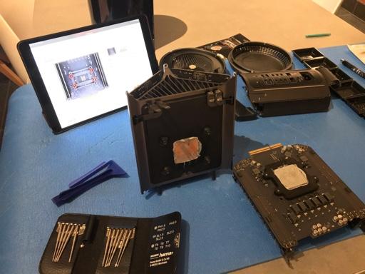

I bought a used 6,1 Mac Pro cylinder (6 core 32/500 D300) in september. Me too noticed quickly there were a lot of ECC errros accumulating with one DIMM, andsome with another DIMM. No panics or restarts though. They were all recoverable errors.
It bugged me though, and because I needed more RAM anyway, I ordered 64 from eBay. ECC errors went all away with RAM change.
So I don't know if they were badly seated (I do think it had factory installed RAM), or DIMMs going bad for some reason - maybe heat, maybe usage and age or whatever.
OT: Now I have this 10 core 2690v2 here ready, waiting for some holiday spare time with my cylinder.
I already replaced/swapped all memory modules and improvements were only temporary in my case.
My Mac currently only reports errors for DIMM1 and has been usable for the day without slow-downs or crashes. But yesterday, I had several crashes, with sometimes modules not recognised at all or even improperly recognised (like 40GB of RAM made of 16+16+8+0 when all four slots were populated with 16GB modules !!!). I even had some cases where the Mac refused to boot and I had to disconnect all cables for a while.
OTOH, it can sometimes run beautifully for days or even weeks at times. I think I will too wait for some holiday spare time for a full dissassembly/cleaning/rassembly, and perhaps a CPU replacement (but I already have the top-of-the-line 2697v2). If that does not cure it, I may end up throwing it through the window (and into the swimming pool) in despair ;-).

I am hoping it is a loose contact somewhere (the author of the CPU swap video above mentioned the importance of correctly seating and tightening the CPU to avoid memory channel errors), so I’ll do a full tear down/rebuild with fresh thermal compound.
If that doesn’t work, I’ll declare it a total loss. I’ve spent too much money and time trouble shooting that machine, there’s no way I’ll take a chance changing the CPU riser card or logic board ($$$).

From the start, I have had 2 sticks giving me errors - 1 has thousands and the other only ever seems to get 50 or less.

  1. Slot 1 gives me loads of ECC errors (like 100,000+/day);
  2. Slot 2 only a couple a day;
  3. Slot 3 is ECC-error free but would occasionally not be recognised at all after a reboot - resulting in 48GB (I have a slightly bent pin in that slot that I partly and carefully fixed with fine tweezers);
  4. Slot 4 seems non problematic.
I could live with 32GB using only slots 2 and 4 I guess, although I would prefer to keep a module in slot 3 as I fear that the risk of short circuit because of the bent pin is bigger with no module in place.

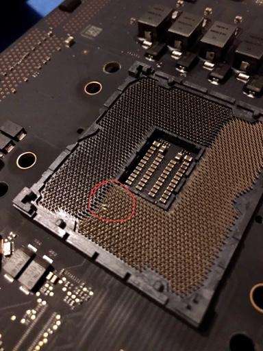

I am hoping that this is related to a slightly loose CPU or board connection. The machine has again worked without crash for almost a week, but I have received the new thermal paste ordered online and I'll probably do the planned tear down/rebuild tonight. Wish me luck... 😕
Good news is that disassembly is a lot easier and faster than I feared.
Bad news is that part of the grid array is slightly damaged, with bent pins
That with the bent pins in one memory slot, a previous owner must have been pretty careless during one of his maintenances. Fixing that will pretty tough. I have good eyes but even with tiny tweezers and a loupe, that’s damn small!
Any source for cheap CPU riser boards?
A pair of 2.5x reading glasses do wonders for small intricate work. Nice to have on hand.
My elder son took care of it with his soldering station with magnifier. MacPro back up and running... still a few ECC errors in bank 1... hopefully it will be ok for a few more months (years?), until I find an Apple Silicon machine I'd be fully satisfied with (M1 CPU perfs would be OK, GPU would need to at least match my Vega 56, memory would need to be at least 32GB, preferably user-upgradable).
