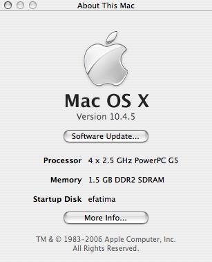

Yes. Lucky you. I had to drive 35 miles to Santa Clara to finish buying my Quad G5 that way in February. They took my check no problem no hassle. Then I used one of their Macs to complete the transaction right there in the store. Took Apple's customer service Sales Department several hours to figure that one out. I just saved you hours of pain on the Apple phone with them. 😛
Boy do I love this Quad G5. And it's only 15% slower than the Mac Pro 2.66. 😛
