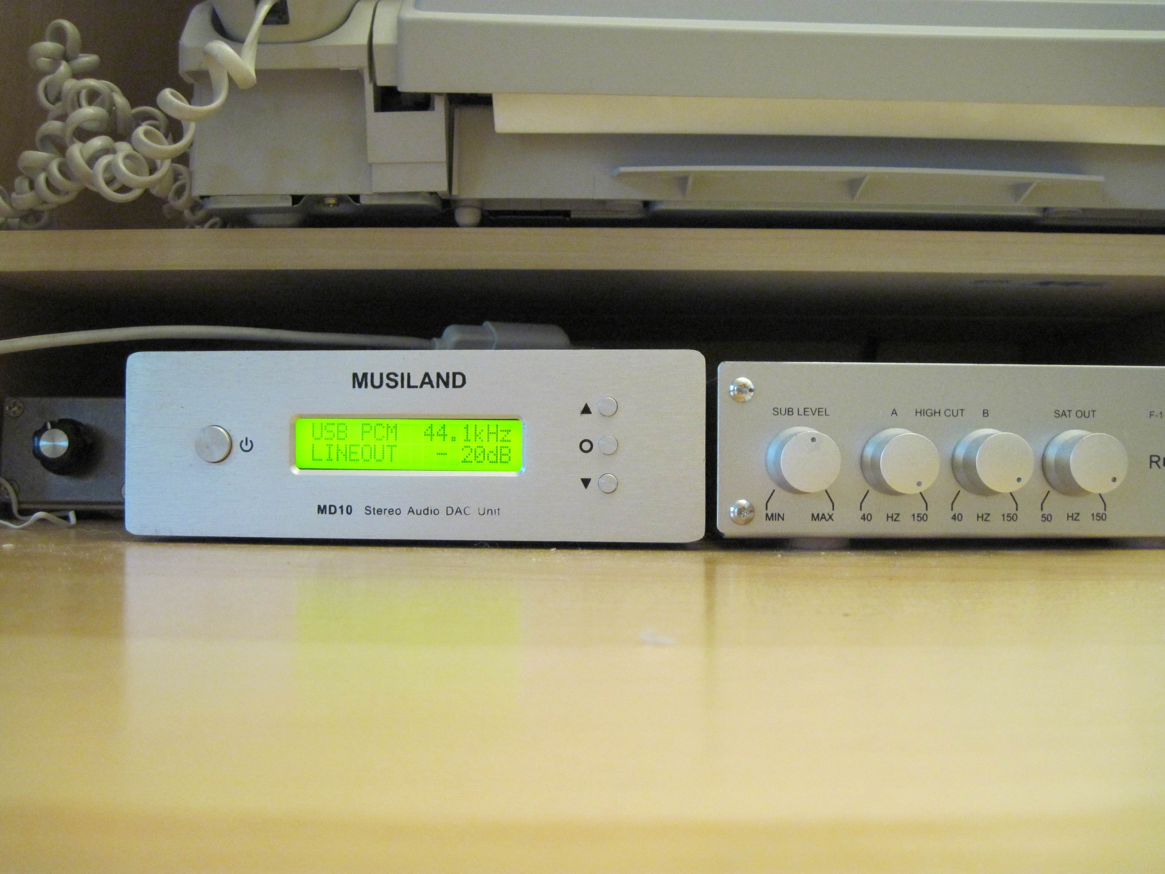

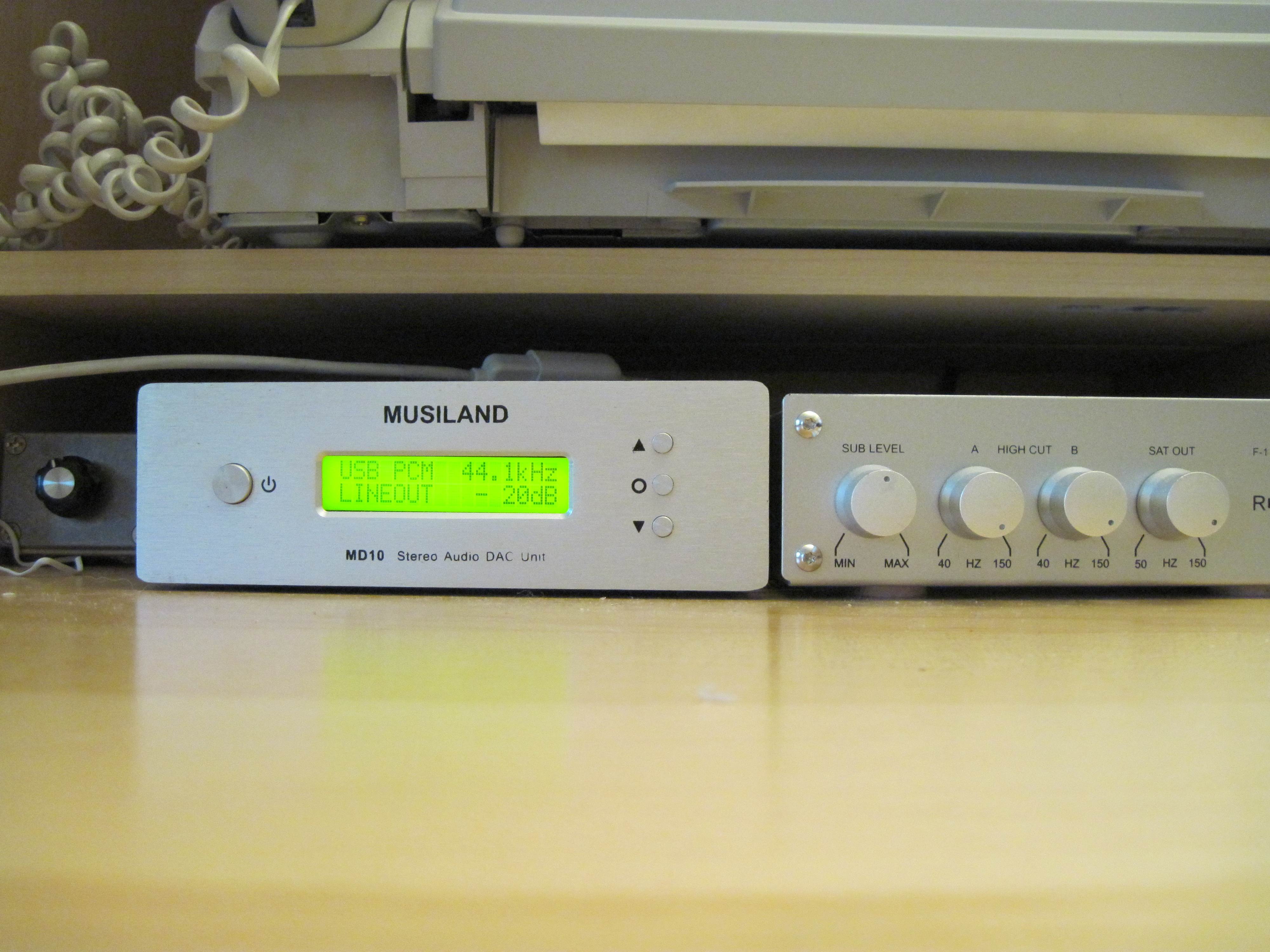

yes. let me sign on to my mac pro I will post a screen shot. here is a photo and a screen shot. I use a 2.1 sound system. in the photo is the dac.
the black knob on left is the satellite volume control.
the dac has a master volume control both left right and sub.
the sub crossover is on the right it has a sub volume control

So you then set your computer volume up all the way? Does the DAC have a volume control as well? Or only for headphone volume?
