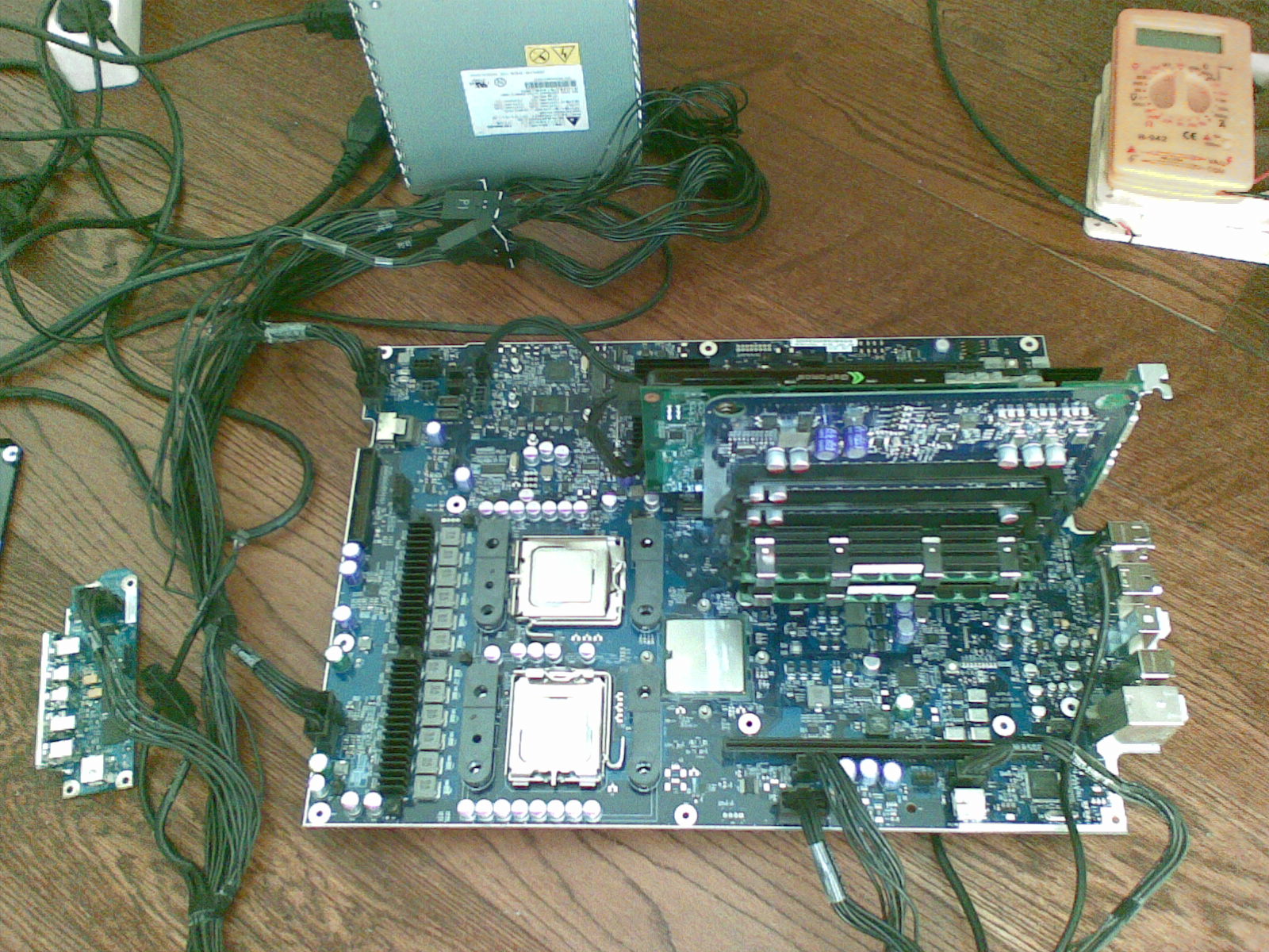

Hi,
I would need a little help here.
One day I had a weird idea to build mac pro from parts. No problem so far, slowly purchased everything needed, logic board, processors, memory, video card, case, psu, cables etc... so it is really a long story.So far I was not brave enough to add all cost together, probably could have bought a retail one, brand new for sure.
Anyway which makes me sad now that after I put everything together it just doesn't start up. Does not give any signal. The only thing is when I press the diag_led button the 1st led (yellow) is on "standby" which means the trickle power is sufficient. But even if I press the power on button nothing happens, no more led lights on. (PSU I tested out of the case, at least in all connectors the 12 V is there)
Any suggestion how I should test whether there is anything wrong with the PSU or the front panel board?
your comments are appreciated
thank you!
Zsolt

- PSU I tested out of the case. Shortcut 7-9 pin in C connector can hear that PSU switches on and can measure 5 and 12 V in all connectors.
This is eg. what I don't hear when everything is connected to the logic board. What is the moment PSU should switch on?
- front connector cables seem to be ok but nothing happens if I press the start button, not even the led lights on. (tested it separately, ok)
- took out the logic board, cleaned again the ram and riser connectors with PVA cleaner, same with the video card.
But same symptom, no green led only 1 yellow if I press the diag.
Is there any way to exclude the front panel somehow to test whether there is wrong sg?
thanks
Zsolt
- nothing else connected
no fans, no harddisk or dvd.
Tried to use only one cpu, switched them in all possible ways, no luck.
Have you tried with both RAM riser boards inserted?
I'm not certain but I think having one missing may stop the computer from starting up.
yes, have tried with both risers installed not any better unfortunately...
neither if memory modules have been changed in various ways.
I think the main issue is that for some reason the PSU doesn't switch to power mode. I don't know whether the logic board or the front panel controls that function.
Should the logic board be powered from the moment the AC plugged or when I press the power button on the front panel?
Still my question whether there is a way to exclude the front panel from the circle?
