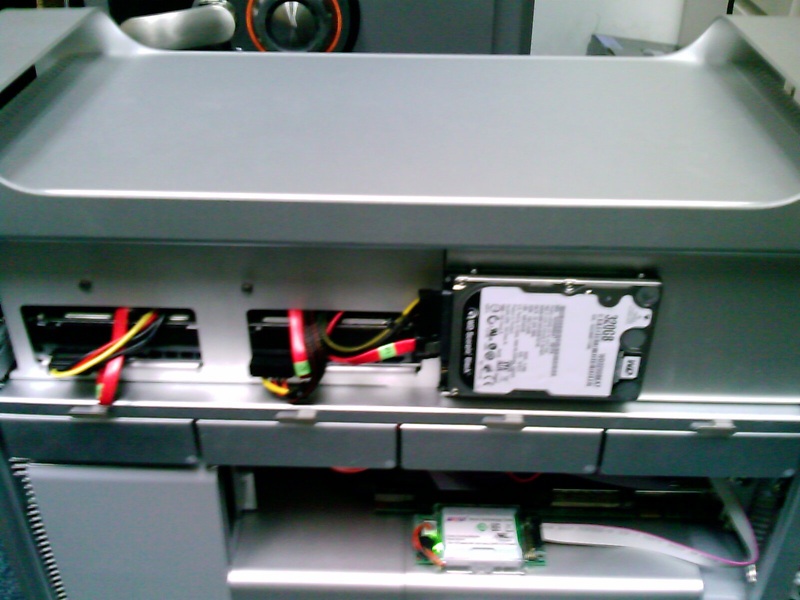

yeah. I already have array drives 5/6 in the optical bay. But your correct, Im going to install another internal drive (drive #7) in the machine, its going to be a laptop 2.5" sata high perf drive.
I found a 2.5" 320 gig, 16mb cache (most have 4/8) 7200 RPM, and I'll take a picture when I have it installed, It actually fits against the psu wall and fits in the small space the door has in it. This will be directly connected to the logicboard via a sas to sata pigtail.
There is also the option of fitting the 2.5" on top of the two 3.5" drives in the optical bay, I just dont want the 3.5" to add heat to 2.5" drive.

Well, after 6 days, 500 bucks (at least) and lots of trying every thing that can be tried, I ended up going another route.
$100.00 at fry's
7200 RPM
16MB Cache
320 GB
"Desktop Performace" 2.5" sata II hard drive
I just routed one of the pigtails up to the optical bay like I did with the 2 from 5/6 on my areca raid card, and lined it up so that it was in the exact location, when the door is on, the rails actually hold the drive almost perfectly, so besides the doublesided foam tape (thats insulating the oposite side I might add) the door closed stops and movement or sag just the same.
Maybe someday, someone else will get it working, but I didnt, and I bought enclosures from WD, Vantech, MacAlley, OWC, and even Trans Intl'l Mini G, none of them would work through the logicboard through a esata back plate like we all use on our pc's and let me install windows. failure after failure after failure.
here's a pic
vista is already installed.
Glad to hear you got it running. 😀 Sorry it took all that aggravation, and the RMA's to boot. 😱 😉
I prefer to keep the drives internal. Extremely simple, and avoids issues like what you ran into. (No PM issues,...)
If I go external, it's almost always for RAID. Previous experience helps, but I can buy the wrong parts if I ignore research first. 😱 Even then, it's still possible. 😛
Usually due to issues though. 😉
