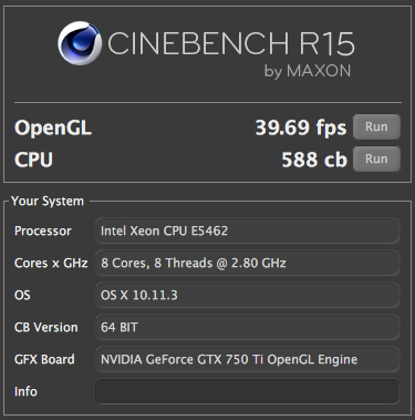

It booted! That's always nice. The results seem pretty good. I just did a before/after with cinebench. If the results are to be believed, there is a 20% performance improvement.
I'm wondering about these temp outputs though. CPU b seems hotter. Is that within tolerance? I didn't think to take note of the measurements prior to the update.

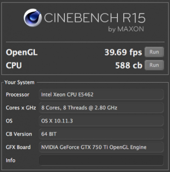

I just upgraded my MVC flashed GPU tonight, and got a 400% speed bump over the stock HD2600. Something isn't quite right with your CPU benchmark.
Here's mine with my two 2.8GHz Xeons. I hope I get more than 633 out of it from the 400Mhz bump in speed.

Cinebench is heavily biased towards AMD/ATI cards, and I dont trust its cpu benchmark much either.
If you want a cpu benchmark, use Geekbench.
You'll note my 2.8 before score is more than 120 less than your 2.8 score. So I don't know that I trust Cinebench for anything more than a relative gauge.
I'd use Geekbench, but i guess I'm too cheap to pay 10 bucks to get the 64 bit support. 😛
