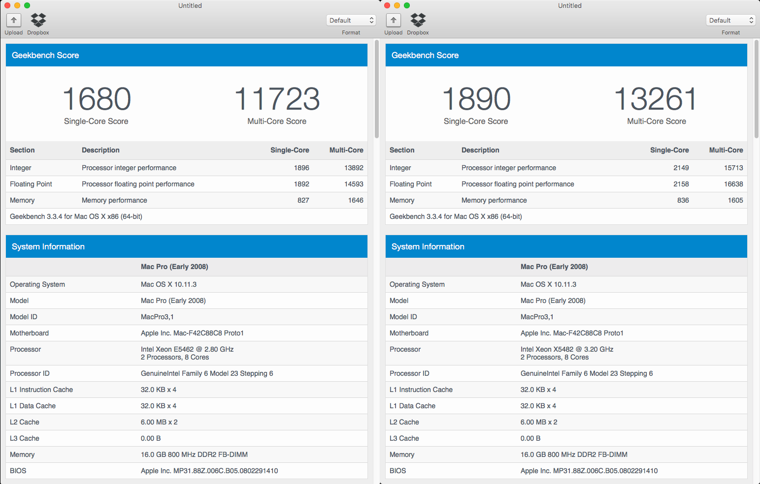

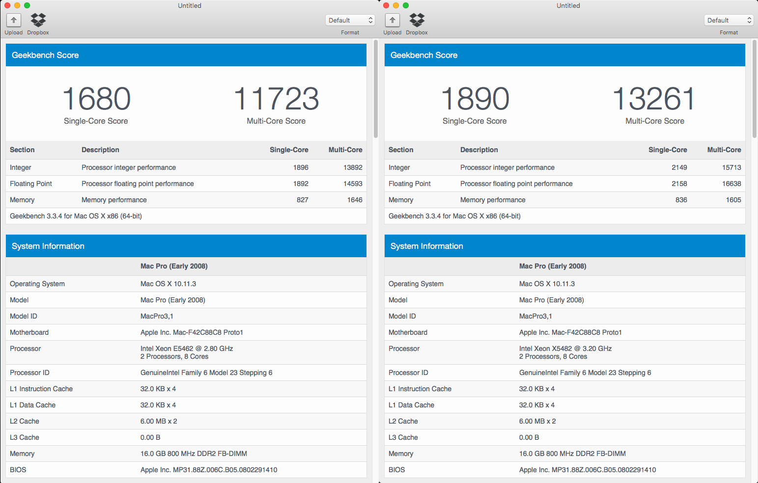

It turns out they ended up shipping me SLANZ Xeons, and I just finished installing and benchmarking them. They run about 1 degree warmer than the 2.8's.
Benchmarks show an 11.6% speed increase, so for $119, I guess that's not a bad upgrade all things considering.

Finally got new RAM (8x2GB), but it didn't affect performance at all. Still getting about 630 on Cinebench, and 11400 on GeekBench... Sigh... I wonder why your machine is benchmarking so much faster?

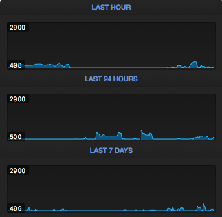

Also, this new RAM seems to be making the fans more volatile. Before I would rarely hear them, now they go up and down at the the drop of a hat. Already tried resetting the SMC... Maybe the temp sensor is not registering correctly?

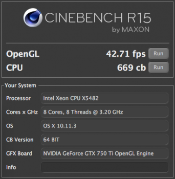

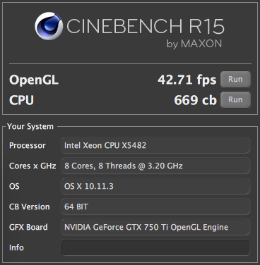

Here's my Cinebench score now.
The only time I hear the fans spin up higher than idle is when I'm benching, or playing an intense game, and even then, it's not by much.

@Ursadorable , interesting. the big difference between our two systems is the OS. I'm running 10.10.5 and my CPU score is 561 cb. My MP3,1 is also a quad core 2.8 while you are running 10.11.3. My system has 32GB of memory so wondering what else could account for that difference.
We're not going to talk GPU because we all know the original 2600 is horrible for GPU performance and that is what I have currently at 10 fps. LOL < hangs head in shame... >
