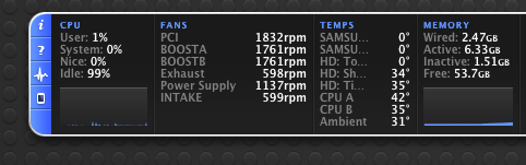

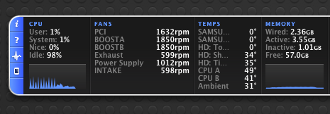

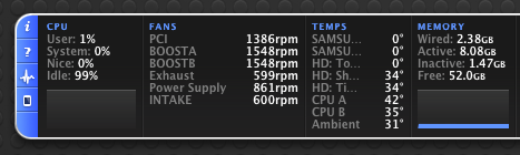

Which fans are speeding up? What's your temperatures look like?
Do you have iStat? It's a free trial for 14 days. Shows CPU Diode temps and all fan speeds. Give it a go if you haven't got it. Let us know what you see if you install and run it.
This is what seems to be all of the relevant information from iStat but I don't know what is normal.
I ran a photoshop sharpening action on a folder of images. Here are a couple of screen shots of iStat. The fans were revving moderately but they get faster than that. As you san see, the processors are barely working. I am not sure where it is reading it's ambient temp of 31ºC from but I make it 25.5ºC. The first screen shot (with the lower fan speeds) is on idle and the other two are under light load.
Any help with interpreting these figures would be much appreciated.
Thanks

Based on the images you posted, your Booster A, Booster B, and PCI fans all run considerable higher than mine. Mine are running at 1114, 1112, and 799, respectively.
I don't know which video card you have, but some people have issues where their video card needs to be stressed a bit before the PCI fan will throttle back to normal speeds. Try the following:
1. Goto http://unigine.com/products/heaven/download/
2. Download Unigine Heaven
3. Run the benchmark
4. Check to see if your PCI fan throttles back to normal speeds
As for Booster A and Booster B, you can try checking the heatsink fan connectors, thermal compound on the CPUs, and the RAM. Testing with half RAM and then other half should be good.
Also, 2009 Mac Pros with dual CPUs used "lidless" CPUs from the factory. When CPU upgrades are done, the CPUs used are always "lidded". How much torque you apply to each of the screws holding the heatsinks can be the source of your problem. One technique used by some upgraders is to count the number of revolutions they turn the screws to try and balance the heatsink properly. Since the original "lidless" CPUs are a bit shorter in height than their "lidded" counterparts, the fan connector on the heatsinks are also sometimes not well connected. Remember not to over tighten the screws for fear of damage to the CPU and/or socket. Err on the safe side and under tighten before you over tighten. It is very much trial and error.

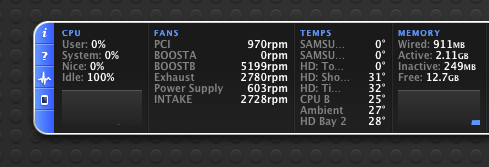

Here is what it is doing now.
Sounds like you need to tighten the screws for the heatsink a bit more. The connector for the fan on one of the heatsinks is not making enough contact.

pastrychef you are a genius, thanks!
I am pretty sure the connector to the fan and sensor was in far enough but maybe one of the hundreds of pins wasn't contacting. I have been looking at the side of the connectors as I screwed them down X pattern 1/4 turn at a time.
The upshot is it is working very well now. these are my readings after giving the graphics card a workout with "Heaven" (ATI Radeon HD 5770 1024 MB).

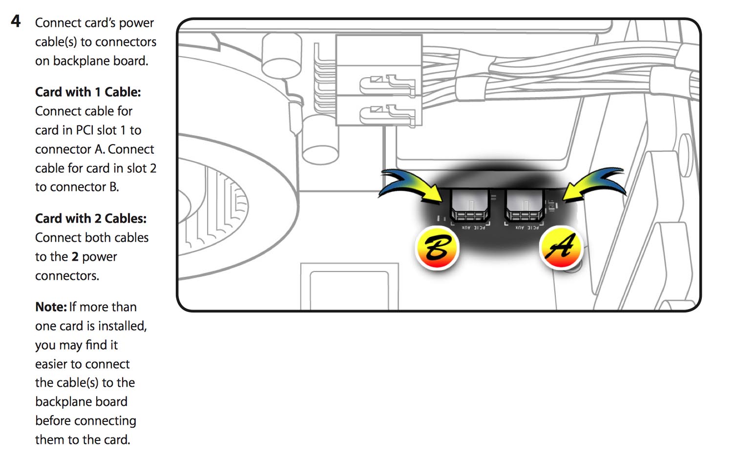

I believe both the GTX650 and the HD5770 have only one power lead. Are you both (Studio K & Chriscotech) sure you plugged it into the correct power plug on the MB. If plugged into the wrong power plug, you will get excessive fan noise.
Lou
Lou
No, it was in the right one (A). That picture is upside down in my opinion. Then again, I am from Australia.
