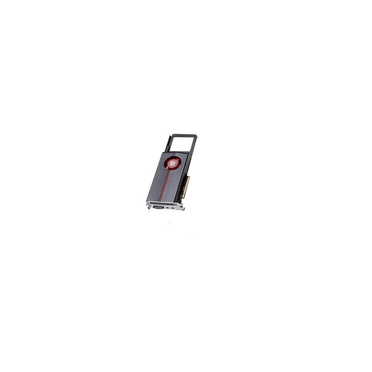

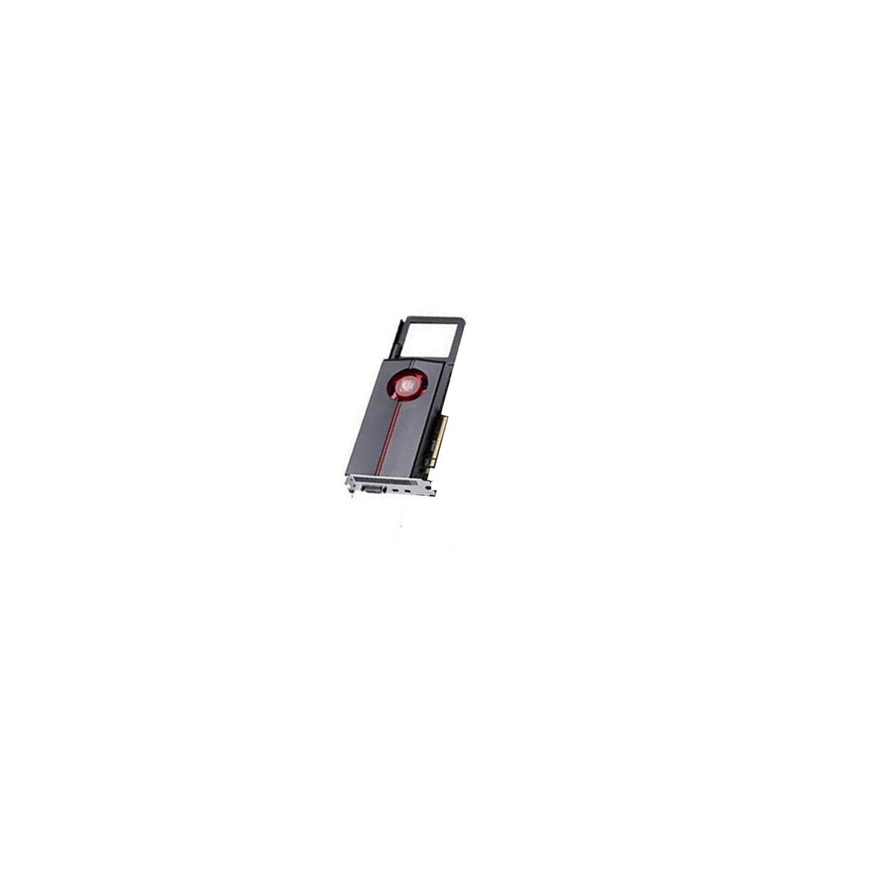

It is an ATI HD 5770 but I don't know if it is an Apple one or a flashed PC one. It has a normal boot screen. The computer was put together a system builder and there have been some economies made. Does it make a difference if it is an official Apple one or not?
If your Mac Pro is a 4,1, then the 5770 is not officially supported even if it is the Apple OEM card. It will still work just fine, but may exhibit some of the PCI fan weirdness that other non-supported cards experience.
If it's an Apple card, then it will have bracket built into it. It looks like a handle when you pull the card out.

It is an Apple card in that case. My computer is a 4,1 with a processor upgrade to 6x 3.06 GHz so that might complicate things. It ran well until recently though.

An Apple HD5770 looks like the pict attached.
Yep, it's one of those.
