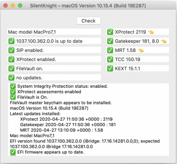

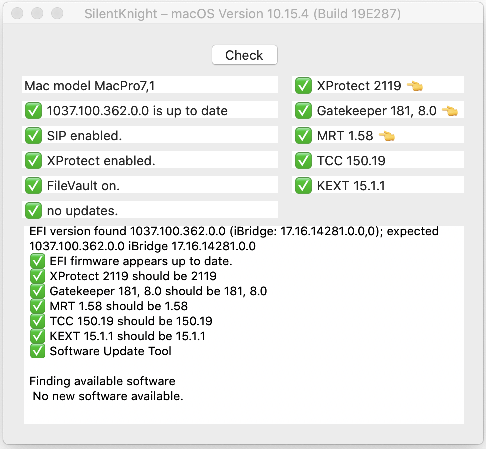

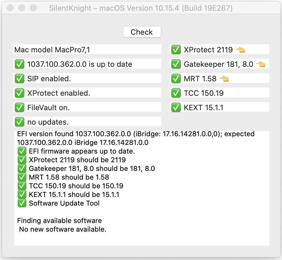

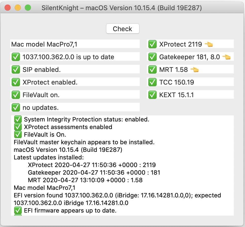

Thank you for you input. All Software is up-to-date:
