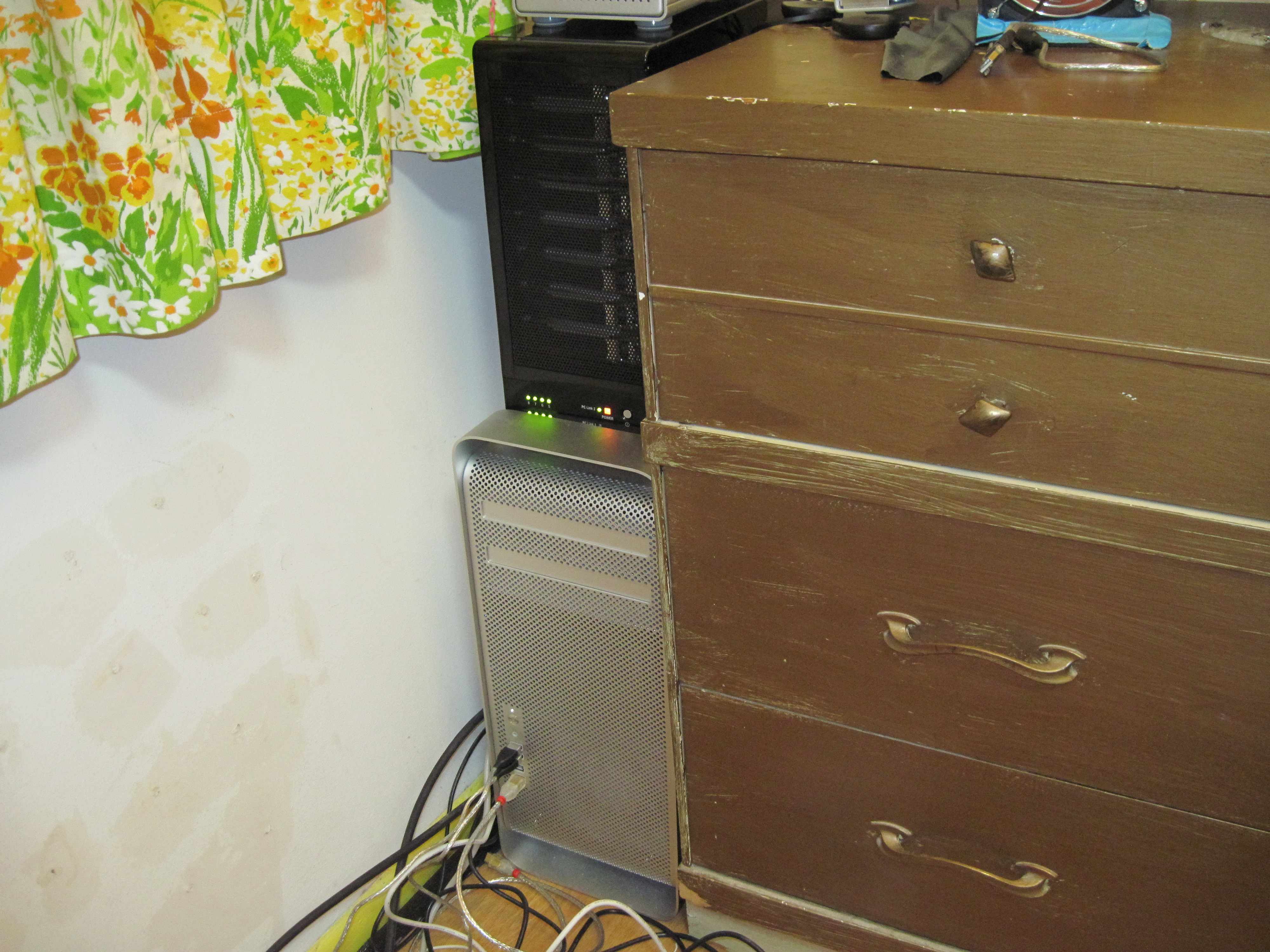

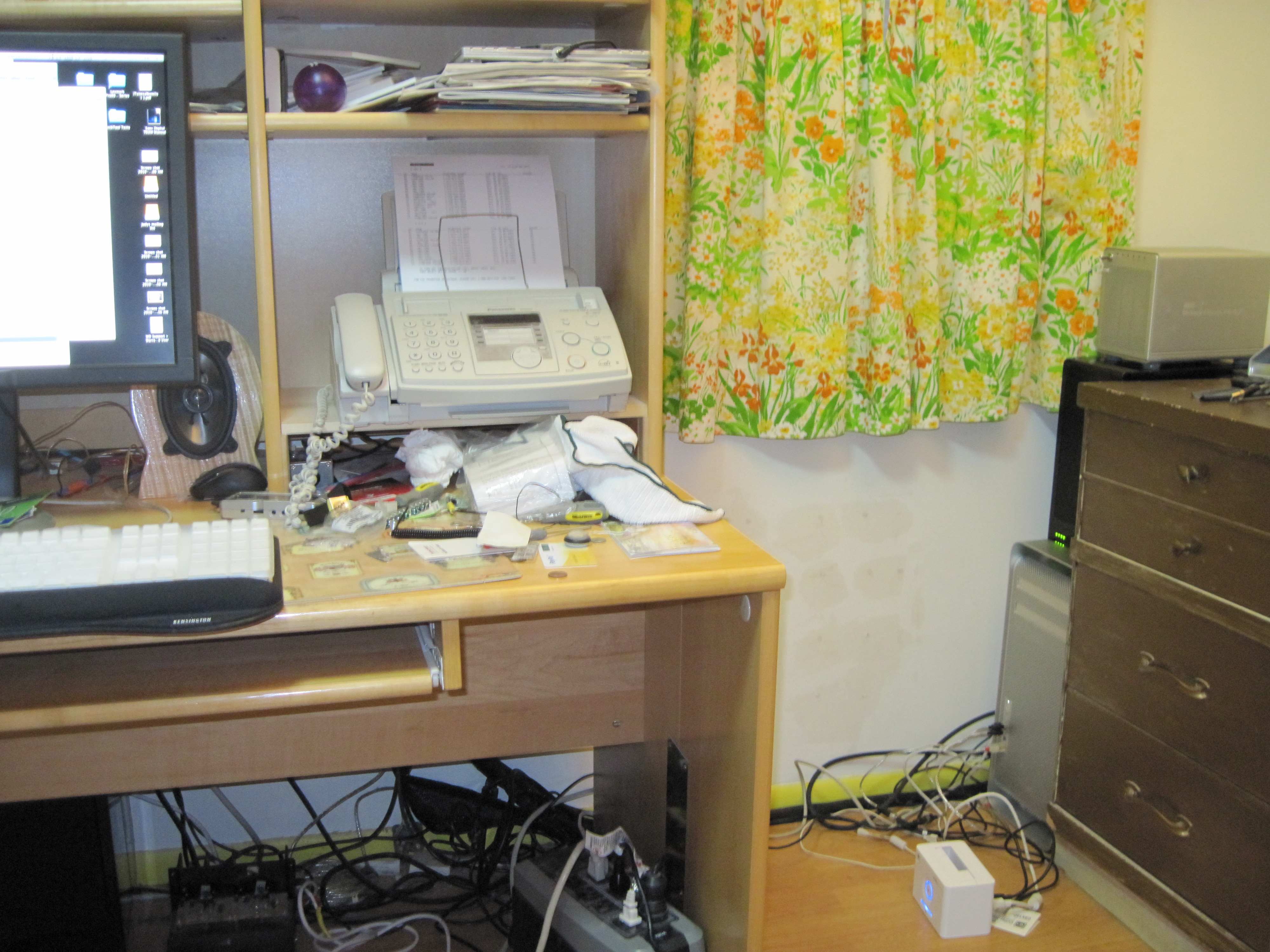

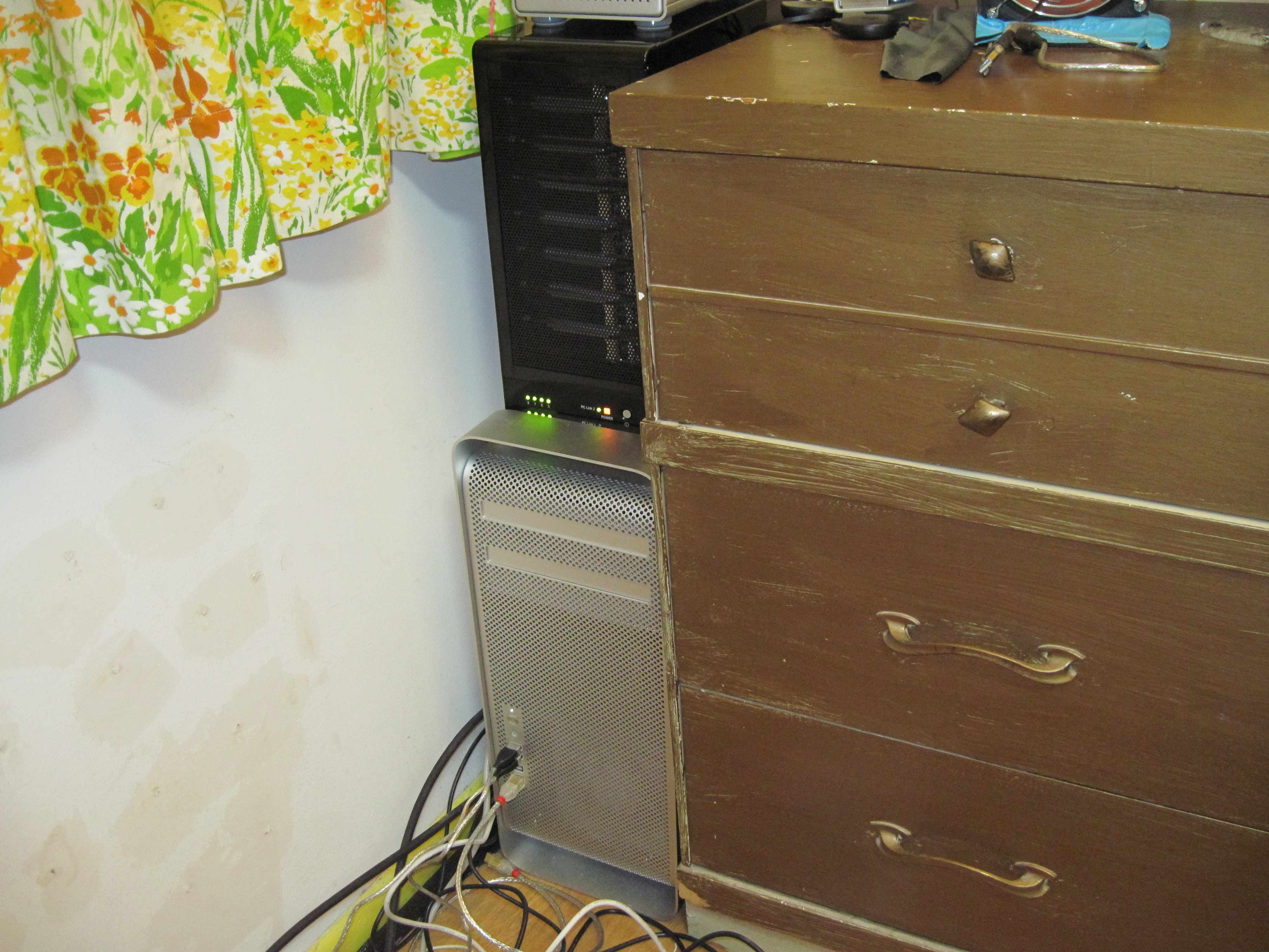

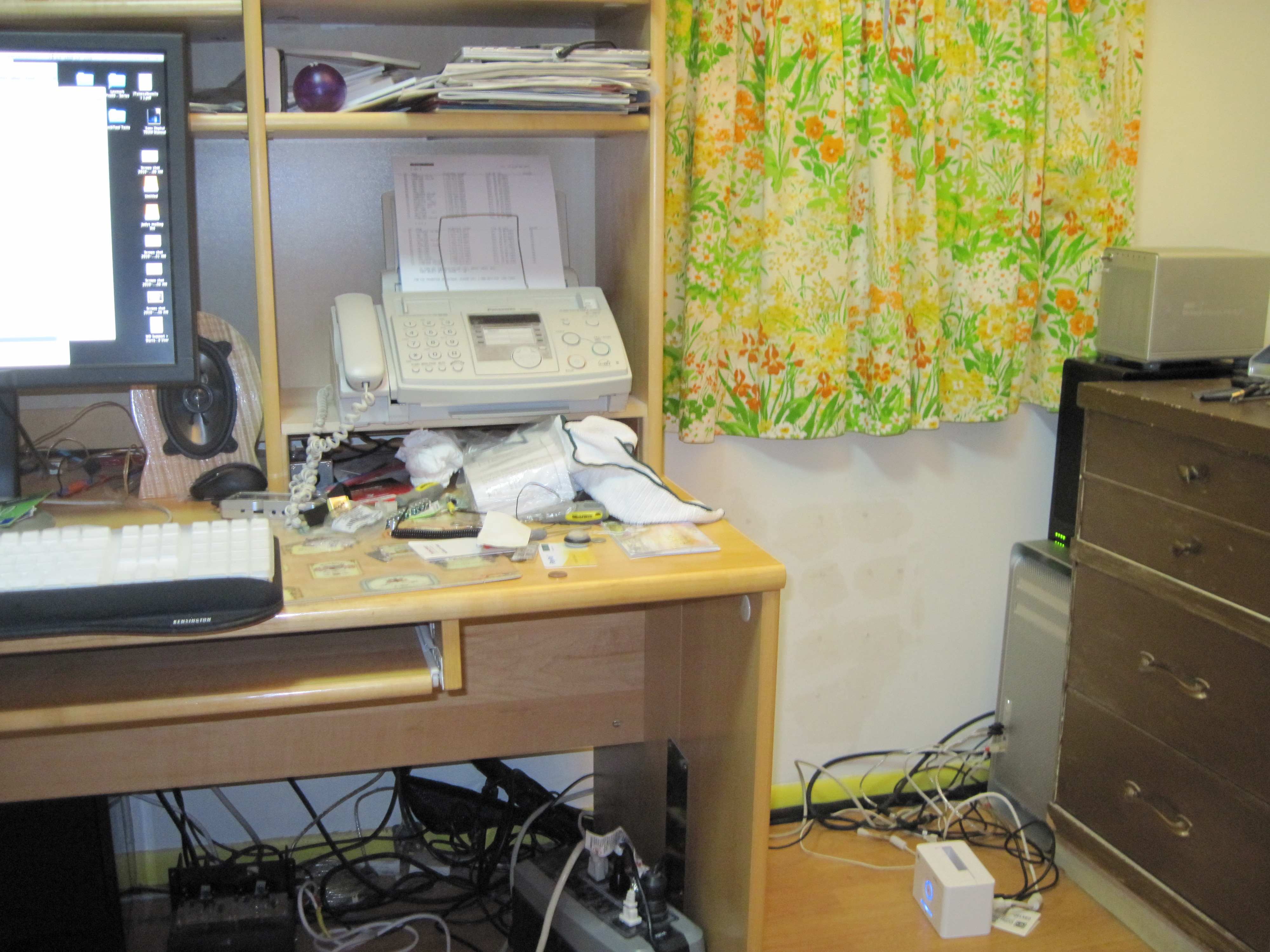

product placement is key. it has a big open grill and 3 or 4 fans. that mac pro is off to the right of the work station. most sound is stopped by its placement.
That looks like the worst possible place to site the computer. Sure, it may be quiet, but it's in the corner of a room, surrounded by furniture, with another computer on top. Where does all the heat go? And how much dust gets in there?
My Mac Pro is 2 feet away from my face, and I cannot hear anything coming from it. There is more sound from the default fan speed from my Macbook Pro than my Mac Pro.
