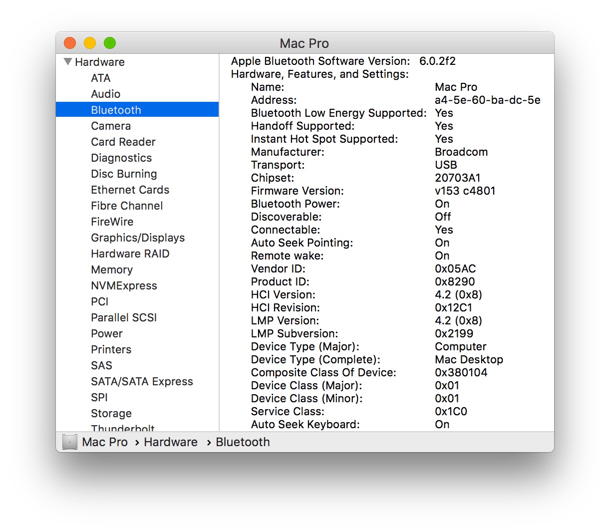

Nothing I can help here. But for your info, I just test watch unlock with the latest 10.13.3 (17D102) on my cMP. It still works. So, the OS itself should be OK, and my BT card is the BCM943602CS. The system info looks like this.
