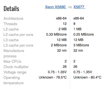

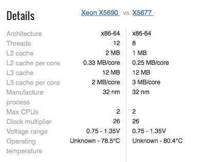

The 78.5 is TJMax, your 81 is core temperature, the core may be 10C hotter than the TJ temp, so it's nothing to worry about. Anyway, you can install some fan control software to cool down the CPU more if you wish.
Lots of heat sinks are like that just copper on the surface for the better heat transfer to the underlying real heat sink metal. The gouge is not the best idea to have but your temperatures are reasonable. The intel specification would be one the tjmax things whatever it is called I would think, the point where they throttle is 100C I believe so you have plenty of headroom left. Lapping is just that polishing the cpu and heat sink until the have mirror like finish on them for better contact between them not recommended unless you know what you are doing/want to risk frying cpu you can't really hurt the heat sink unless you fill it full of gouges.

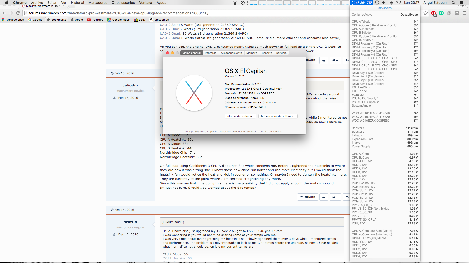

I just upgraded my 8 core 2.4Ghz to 12 core 3.46 (X5690). Did it yesterday and just like you, now is the first time I am concerned with cpu temps. So making some research I found this post, so...
These are mines in this moment:
Your temperatures are looking pretty good to be honest. Those are idle temps Im assuming.
