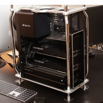

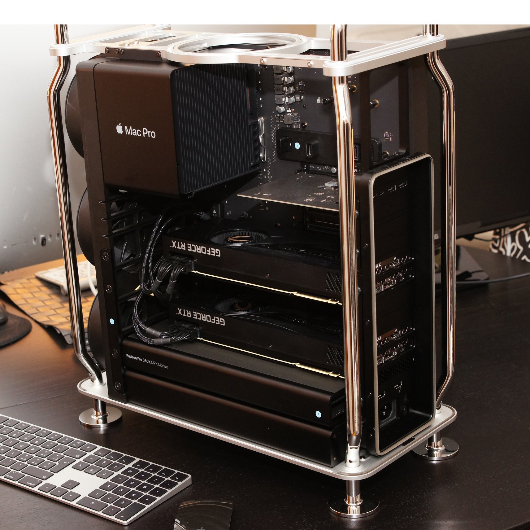

I've installed two RTX2080Tis. Unfortunately these gpus inside a standard pc case run cooler, about 10° Celsius less. The Mac Pro 7.1 cooling system is not designed for axial or blower fans. Also on Bootcamp the 3 Mac fans on the front aren't accessible, we can't tweak the speed. I have to use Msi Afterburner to adjust the RTX fans speed but it's not enough, there isn't enough air to push into the blowers.

I've installed two RTX2080Tis. Unfortunately these gpus inside a standard pc case run cooler, about 10° Celsius less. The Mac Pro 7.1 cooling system is not designed for axial or blower fans. Also on Bootcamp the 3 Mac fans on the front arent't accessible, we can't tweak the speed. I have to use Msi Afterburner to adjust the RTX fans speed but it's not enough, there isn't enough air to push into the blowers.

I needed an hybrid dual boot workstation, MacOS and Windows on the same machine. Sometime I use Mac apps (Final Cut and Logic), very often 3d apps using CUDA on Windows.
There aren't alternatives, I could buy two different workstations and spend more.
On Bootcamp this machine is blazing fast. I use the Radeon Pro 580X to drive a 5Kx2K monitor (LG 34WK95U-W) and the two Nvidia gpus as slaves for rendering with Blender and Optix
AMD and Nvidia gpus can cohesist on Windows 10, unfortunately they can't on MacOS.
Lenovo, Dell, HP or assembled workstations probably run faster and cooler but they can't run an official supported MacOS, they haven't four thunderbolt 3 ports, many pci slots, a compact design with premium materials.
