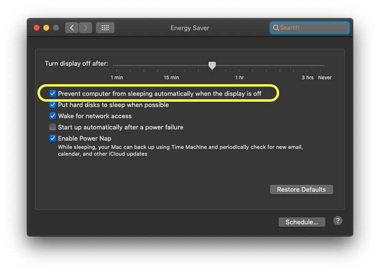

Sunday 26 April. I installed a 2080ti in Slot 3 of my Mac Pro (7,1) Everything went in fine, Windows drivers are great. No wrong slot alerts in MacOS. Only pain is the lack of Displayport cables at my house, but USB-C works a charm for one monitor. AMD for the second.
Since I'm working from home, computer is in my guest room. Also, I snore, so I sleep n the guest room a lot.
Two nights ago, the Mac woke me up four times (that I remember) with random reboots. Kinda kicking myself for reactivating the Boot Chime. The next morning, I checked the logs, nothing. Stumped. During the day if I walked away from the computer the computer going to sleep meant shutdown. More stumped.
Yesterday after a couple sleep/shut-downs, I went in the Energy settings. Checked "Prevent computer from sleeping..." Since then, no shut-downs and no middle of the night random reboots.
Serenity, for now.
