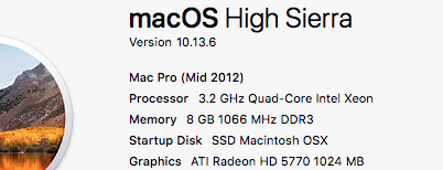

not sure if its power supply.. but i think it could be many things .. so the spec is below ...
a4462489-a744-4a53-86dd-8d378bd791b3
