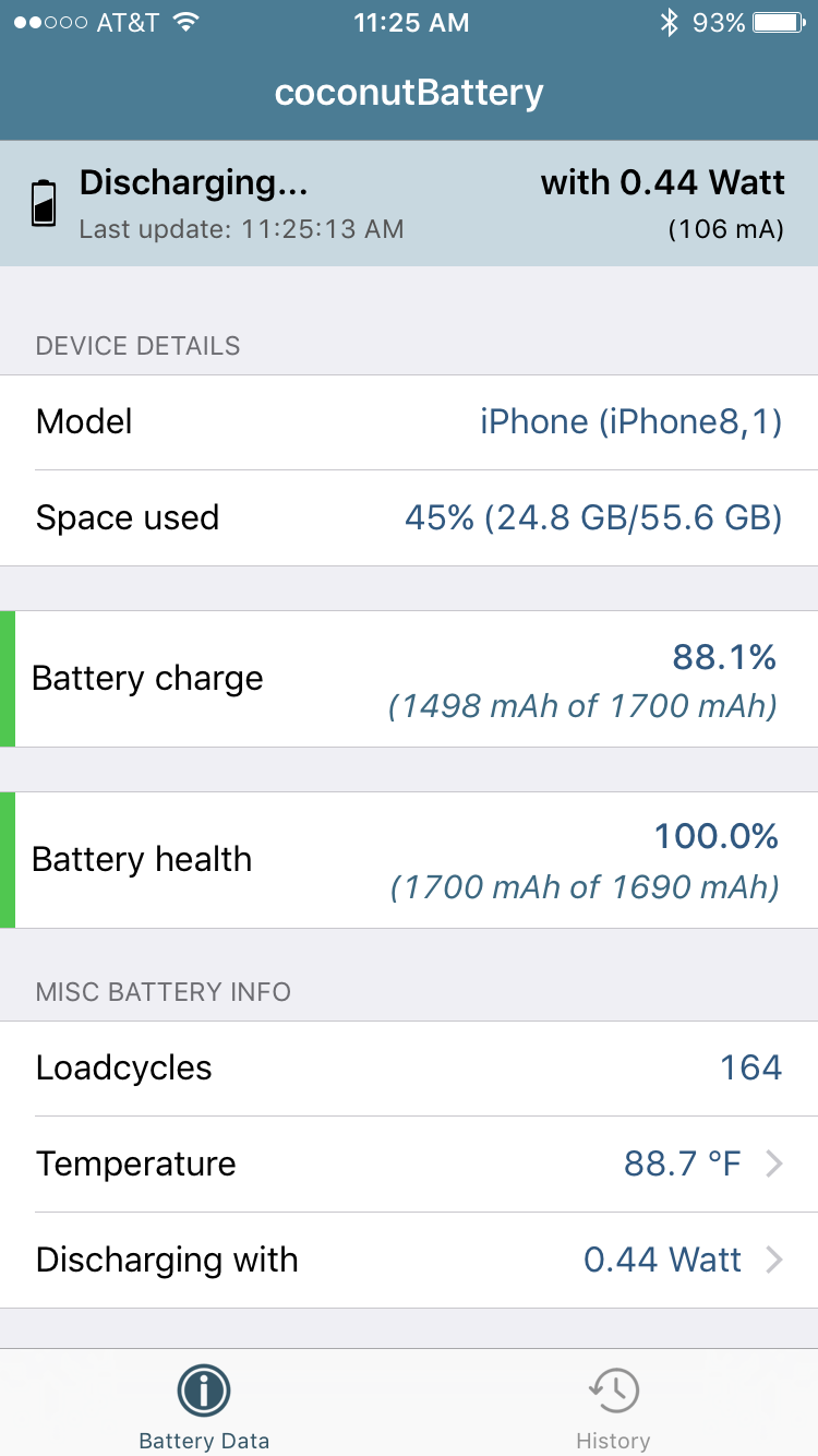

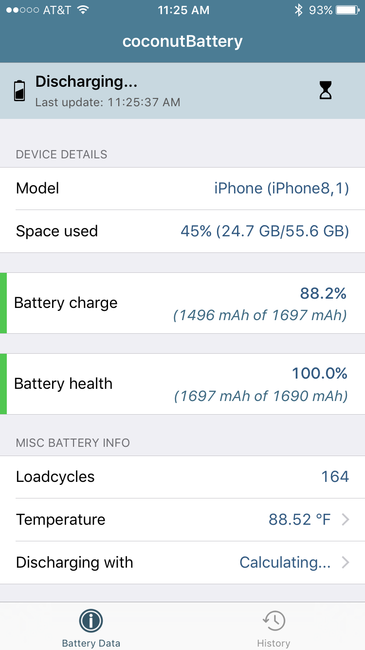

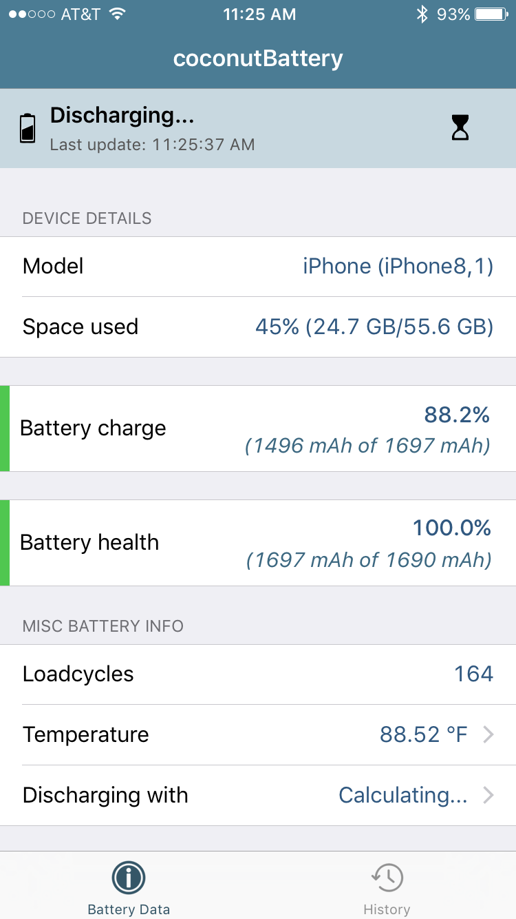

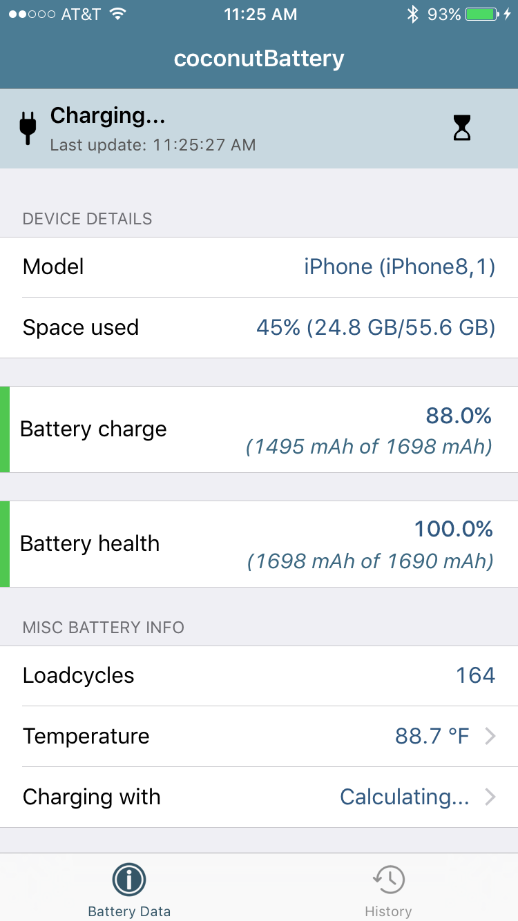

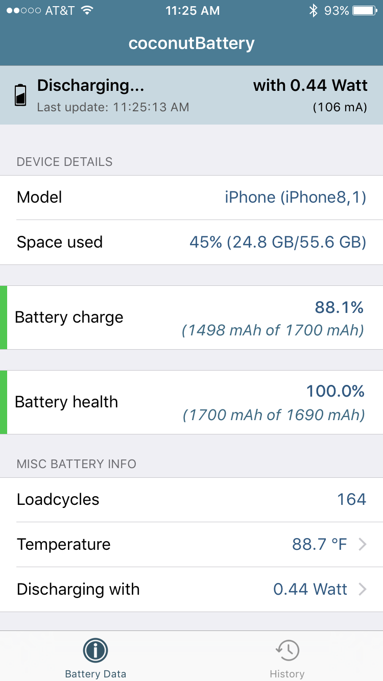

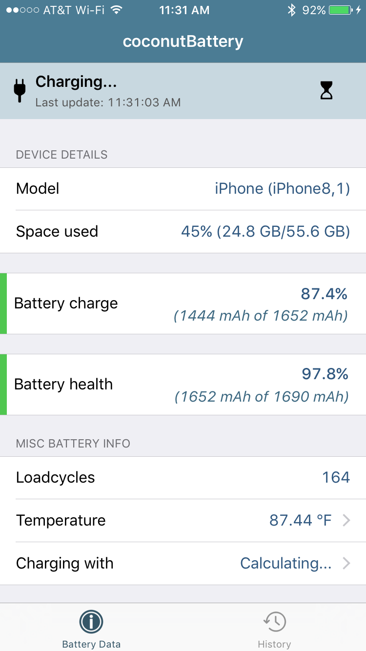

Here you go. I took 3 screenshots in 24 seconds. In different battery conditions, draining, charging and draining. Each one has a different health capacity depending on what the battery was doing. Stress and heat causes it to decrease. As it cools off and calms down, the health will restore.
If you play a game on your device for an hour and the battery temp gets to 100F, the health will drop significantly. Once you charge it and it cools off, it will increase. Eventually, it won't return to its full design capacity and wear will develop. Your battery capacity will change hundreds of times a day depending on what your battery is doing.

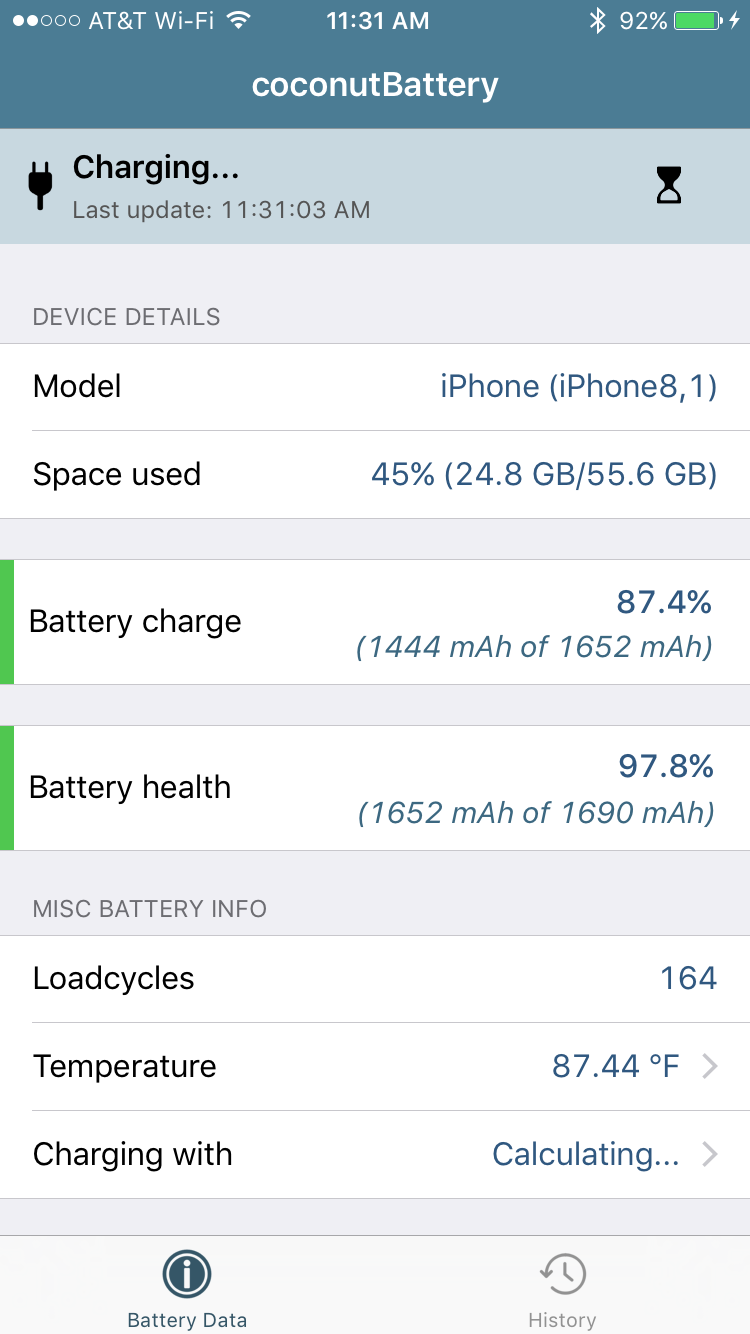

Here is another one only 6 minutes later.
This one took a huge decrease. 40+ mAh worth.
