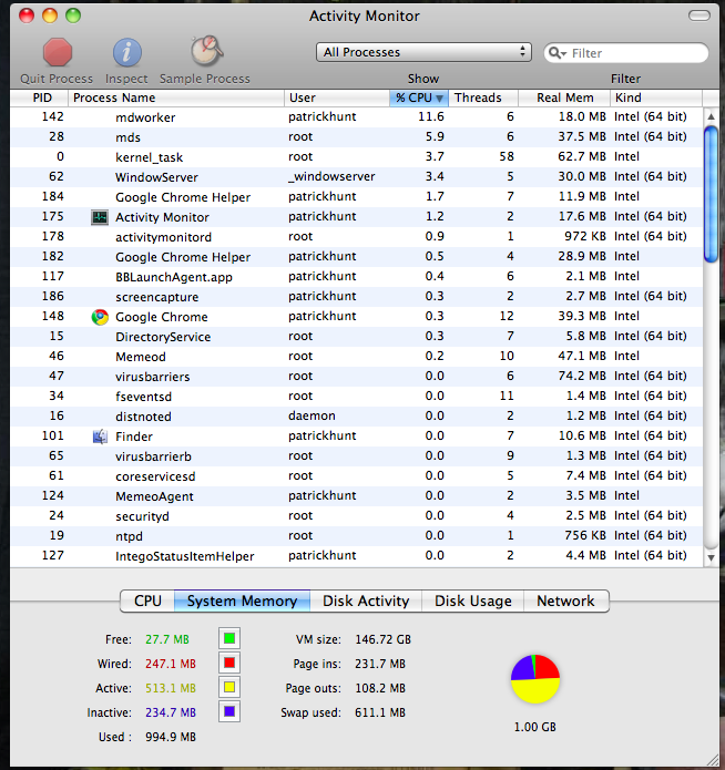

Use this link to find out what it is. Either attach a screen shot here that look like that, or type up the info.
Also, do disable the anti-virus and see what impact that has. AV software sometimes scans every file opened, that ads over head in memory and to disk I/O.
I got rid of the virusbarrier program (I think, it still has an icon on my top bar? I searched for the program in my harddrive and threw everything related to it in the trash and the program that it (and only it) used for updates). Anyhow, there is the screen shot, it seems like I don't have much free RAM but where in the world is it all going?

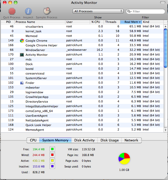

Could you repost put sort by Real Ram
so it appears that i didn't fully delete the virusbarrier, but where can i find the files that are left? are they in the library files? I have searched everywhere i know but am unable to come up w/ anything
Not good... You need a dedicated program like app zapper (Google it) to uninstall programs on macs. You should visit the Virus Barrier website to see if they have an uninstaller. Your incomplete uninstallation is why you still have an icon in your top bar.
I second what someone said earlier, WIPE your computer clean and start over. I think you should invest in a high capacity flash drive/external hard drive and back up important documents (not programs!) and plug it in when you need them. If your mac is still slow, it is surely a hardware problem.
