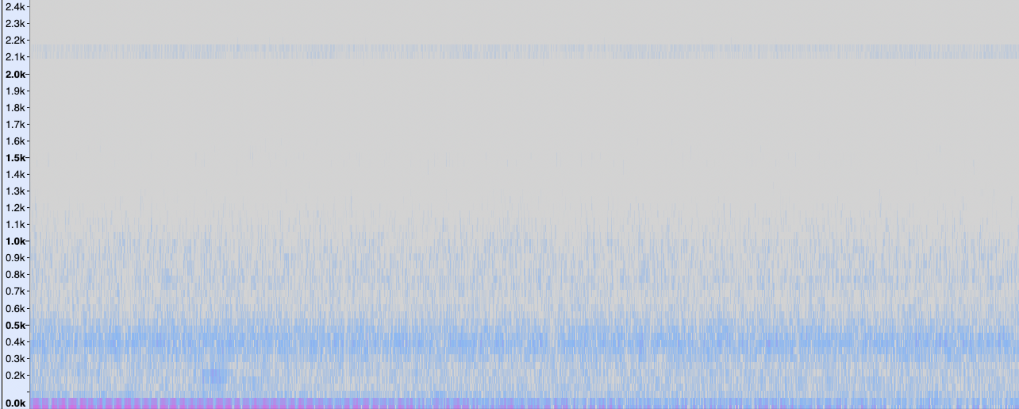

The image below shows two tracks with individual y axis which shows a spectrogram from 0 - 19,000hz. The top track is the microphone directly facing into the airstream. The bottom, is off to the side.
The x axis spaces short audio clips taken at readings of 1000 (new idle), 1300 (previous idle), 1600, 2300 & 3500rpm.
You'll notice there's no whine around the 2.14Khz mark.

Compare this with the old one where at 2.14Khz there was a distinct band, which was the whine.

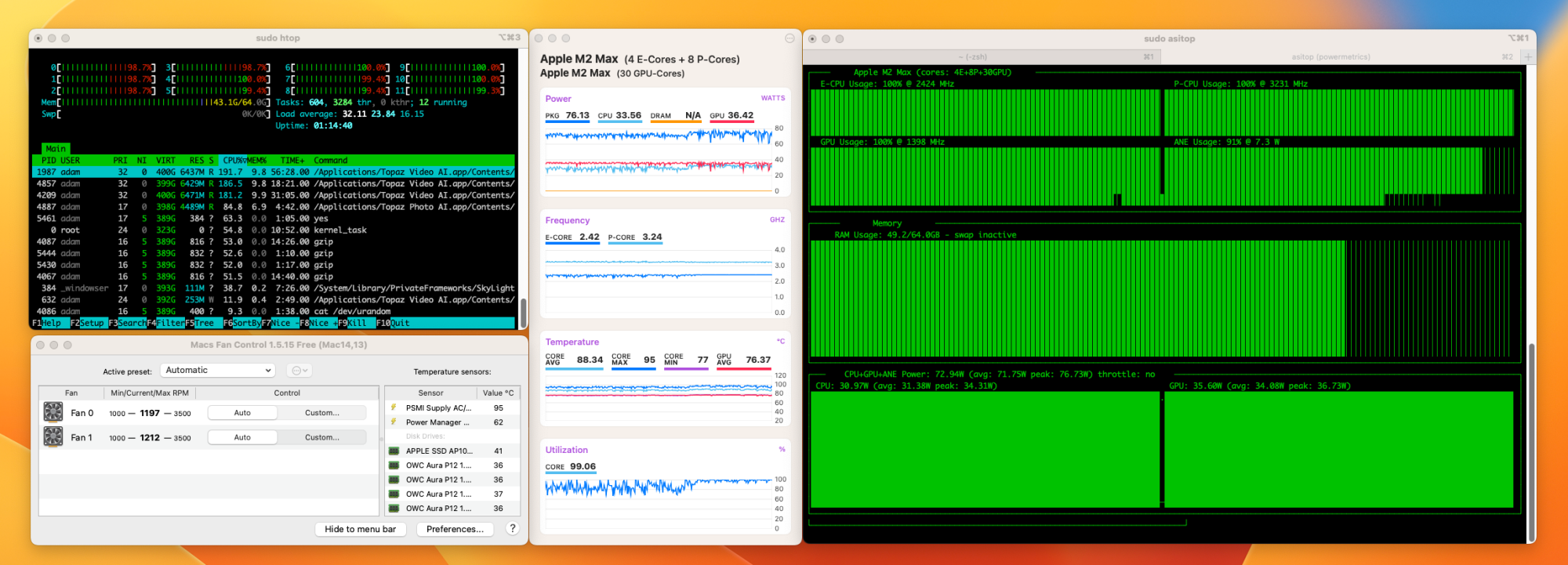

Pushing the machine, I could get it to 1200RPM.
At nearly 100% usage of most things (E-CPU, P-CPU, Neural engine, GPU) - total package power peaked at 76watts on the M2 Max base (no idea what TDP of the M2 Max base is). I saw peak power hitting 120watts for a split second on a few occasions, but then the system crashed or processes failed - so maybe some tweaks on Apples end. I didn't push it to it's absolute max as couldn't run some of the benchmarks I wanted to due to time and GFX bench wasn't working.
When the cores reached around 90c (194 freedom units), the fan started kicking up to a max speed of 1200RPM. The back temperature reached 47.4c (117.32f). Overall, quiet as hell, I couldn't get it to reach the 1300RPM base speed of the original.
This was the Studio they should have designed from the beginning. It's going to be telling to see a teardown and see if there are any physical changes, or it's just a fan curve change.
* Ambient temperate was 22.3c.

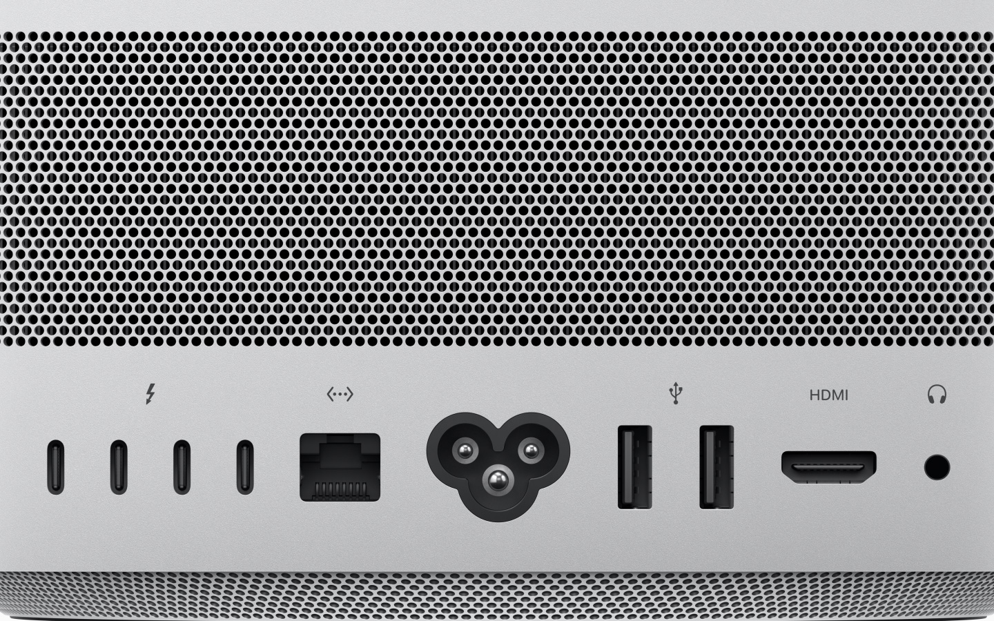

Anyone else notice the vertical lines behind the exhaust holes? Were they there in the marketing images from the first generation? I'm wondering if this hints a a subtly refined cooling system. Or perhaps a confirmation of the theory that the "whine" was due to the precise measurements of airflow.
