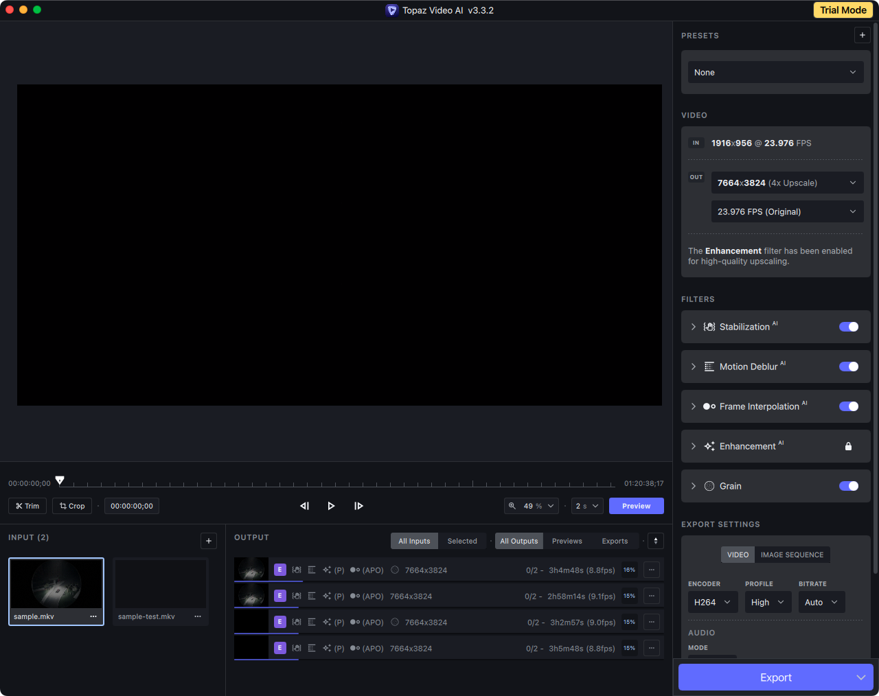

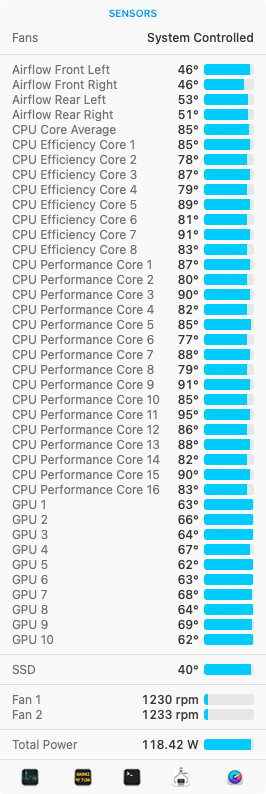

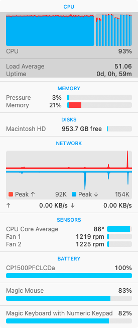

I installed Topaz Video AI on my M2 Ultra and I'm running four sessions at 4x Upscale with all filters enabled. So far at 15%, I cannot get the fan spin higher than average 1200 rpm?
Screenshot 2023-06-28 at 11.06.45 AM.pngScreenshot 2023-06-28 at 11.06.56 AM.png

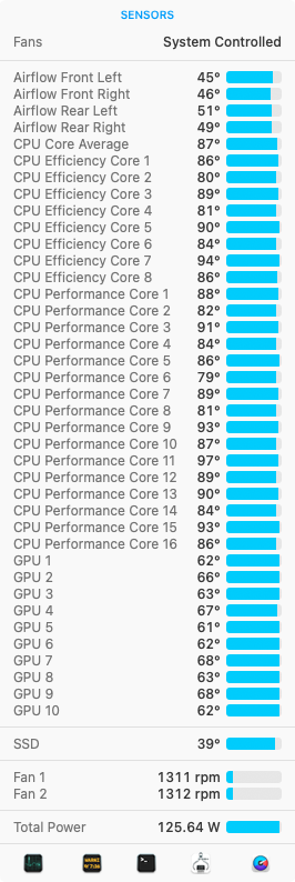

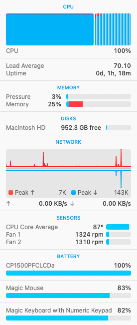

Edit: Running now in parallel Handbrake also, I cannot manage to get the fans going higher than 1320 rpm, it spikes randomly at this number then drops to 1270 rpm. At 1320 rpm, the M2 Ultra is quiet like a mouse.

Try to increase frame-rate of the videos as well (you have to explicitly set it to 60fps at the top). I'm not sure what the optimal workload is for the ultra, but too many will not be better - it will just cause the compute to switch often.
It did take a while for it to get to 1350 and the ambient temperate that day was closer to 26c. You could also try blocking the airflow a little if you really wanted to heat it up.

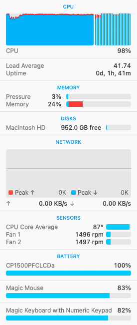

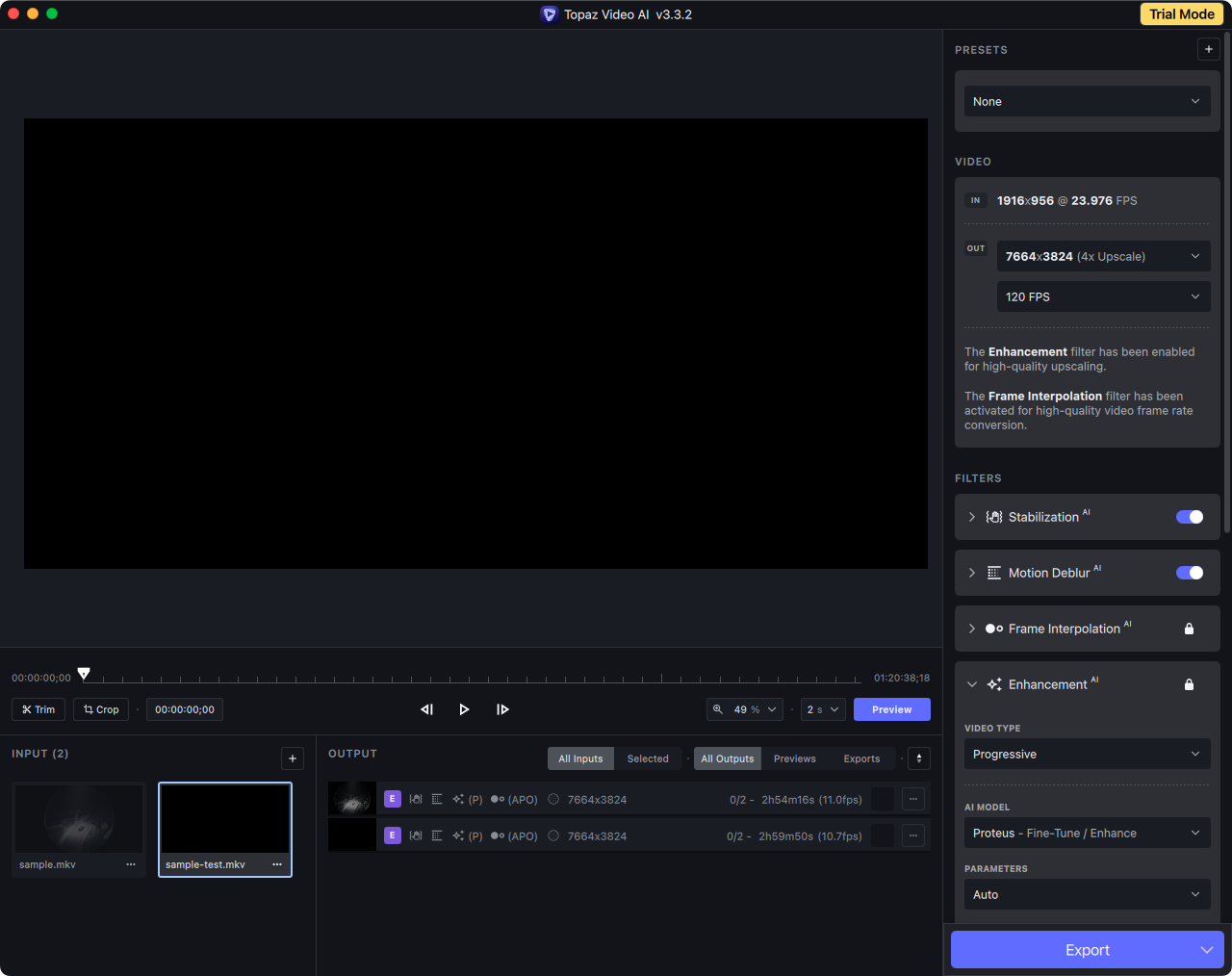

Starting again, with 120 FPS and two encodings.
This definitely helps, I'm reaching 1500 rpm and no whine at all, still very quiet. I'll let it run for a while.

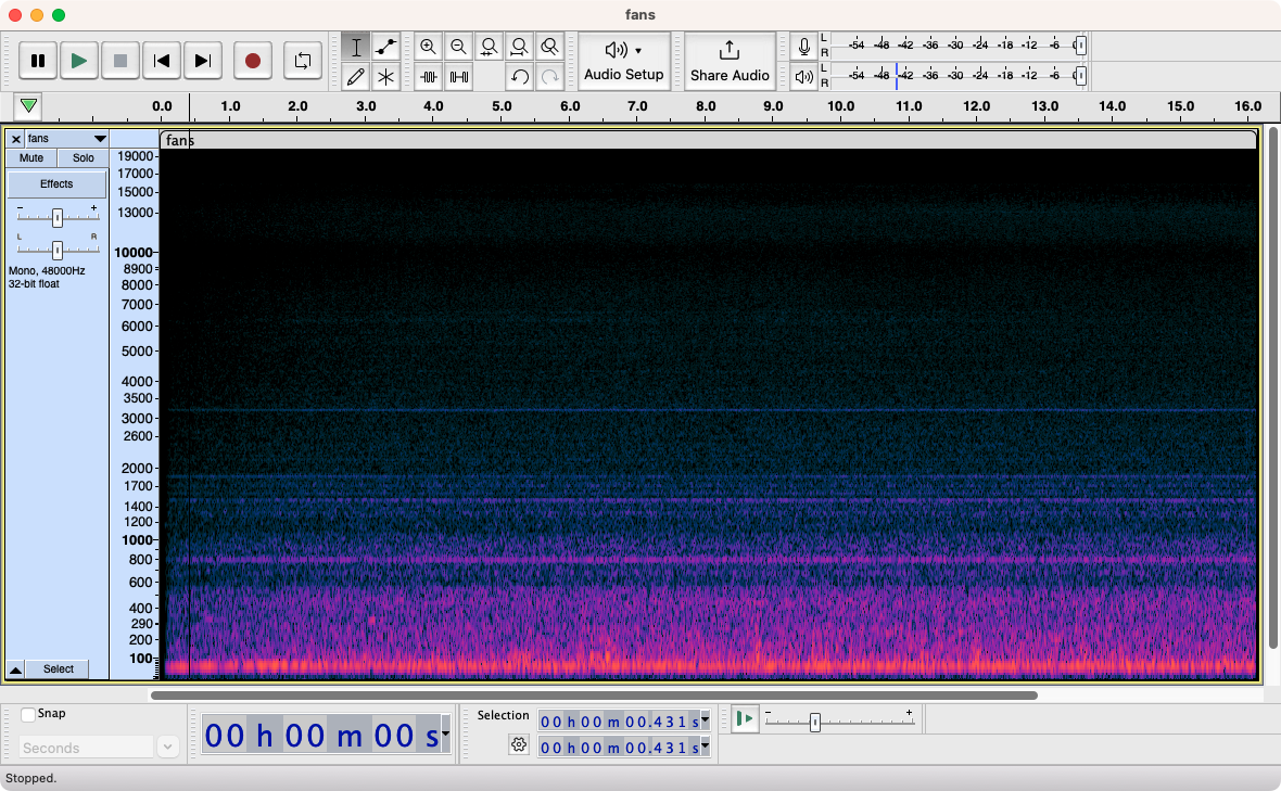

This is the Spectrogram output, can you please let me know what line corresponds to coil whine noise? If I understand correctly, there are machines who have zero whine noise. I'm in the 14 days period, I don't mind exchanging the machine, even if low, I definitely do not want to have a whine noise of a $6400 machine.

You see the flat lines at 3.3, 1.9, 1.5 and 0.8kHz? They will all be contributing to the noise. Although yours looks different to mine (check first post and links)
It might be worth getting a sample without any whine to compare against to make sure your mic isn’t picking anything else up.
I think the general consensus from the m1 generation is that many have it, many don’t notice it (you didn’t until I pointed it out) and if you go through the process again you might not get a better result. But I’d be keen to see you try, as you share your results here which helps everyone.

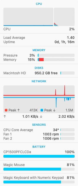

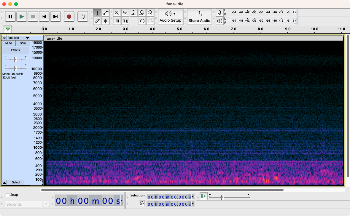

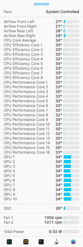

Here it is a recording at 1000 rpm, with my M2 Ultra at idle. Please let me know your thoughts, all recordings were done on a iPhone 12 Pro with Voice Memos app. What I'm trying to determine is if there are M2 Ultra machines with no coil whine.

I think there’s something else in your room causing the whine. Aircon? Other electricals? You should figure those out first because you have lots of solid lines across the spectrum. Compare that to my room recordings in the first post, which is how a quiet room should look

I have the APC and cable modem fans that generate additional noise, I've just shutdown the Mac and I can hear the background noise. I cannot disable the APC as my area is prone to very frequent intermittent electrical failures, which could very well fry all my electronics. Also, the neighbor is listening to TV always super loud 24/7, literally at 3AM you can hear it into living room where I have my Mac.

As you can see your room is quite noisy - It would be very hard to isolate the Mac Whine noise, even if you had it. So hopefully you're going to keep it?
