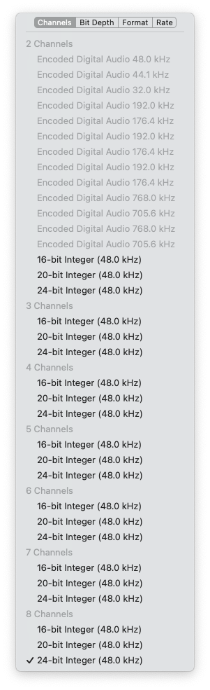

Here is what I got from the 14" HDMI port with a HDMI 2.1 cable, into Marantz AV7705 pre-amp. The Marantz for sure can decode 192kHz under HDMI connections (I got blu-ray audio playing at that clock).
Not sure what is the limit here.
@Chancha Thanks, this confirms it that your 14" MBP is the same as my M1 Mac mini. Rate is locked at 48KHz up to 8ch 24-bit. Everything above is only for encoded audio formats, like Atmos etc.

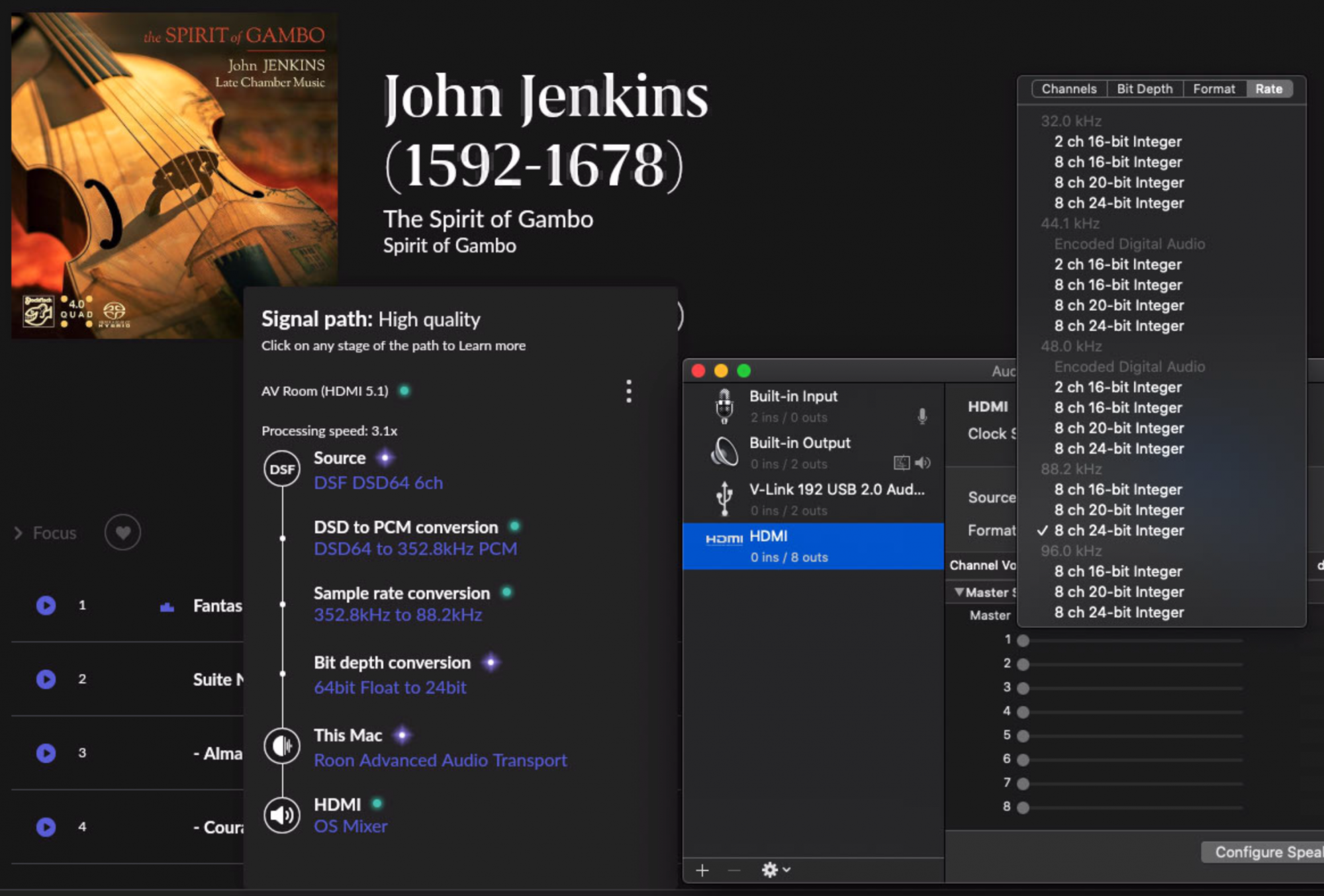

For reference, I got a mini 2012, HDMI connecting to the same pre-amp. I can make it do 8ch 96kHz 24bit, and this is 10 years old Apple tech. In fact I permanently have this clocked as a ROON end point for surround music playback. In this example ROON plays a 5.1 DSD which then downsamples to 88.2kHz to all 6 channels. I can't make my 14" MBP do the same.
