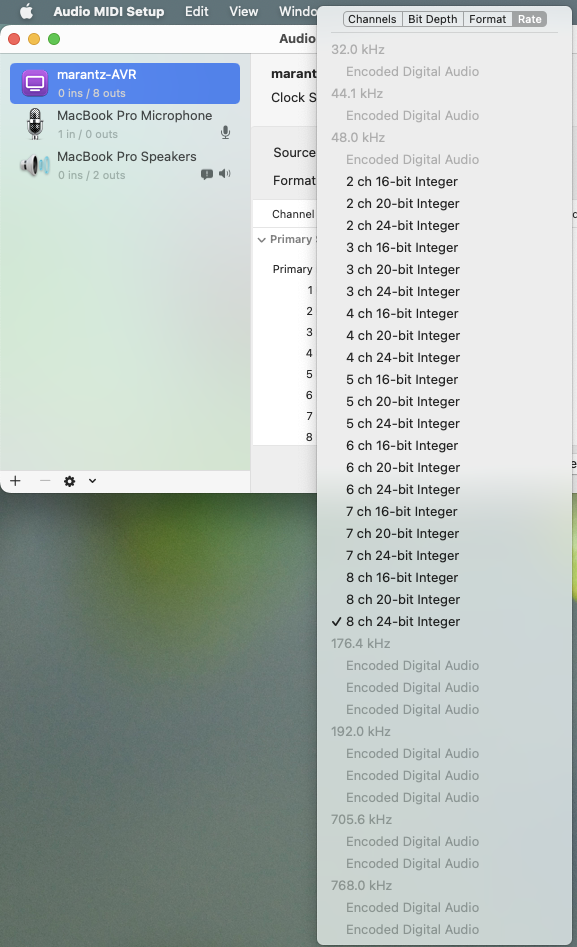

Hello, I'm a quite fresh Mac Studio owner, and sadly I can accept, that it's locked on 48KHz 🙁
However there are some other values that are blacked out, dunno if maybe apple will unlock it later by any software updates?
Here is what I got from the 14" HDMI port with a HDMI 2.1 cable, into Marantz AV7705 pre-amp. The Marantz for sure can decode 192kHz under HDMI connections (I got blu-ray audio playing at that clock).
Not sure what is the limit here.

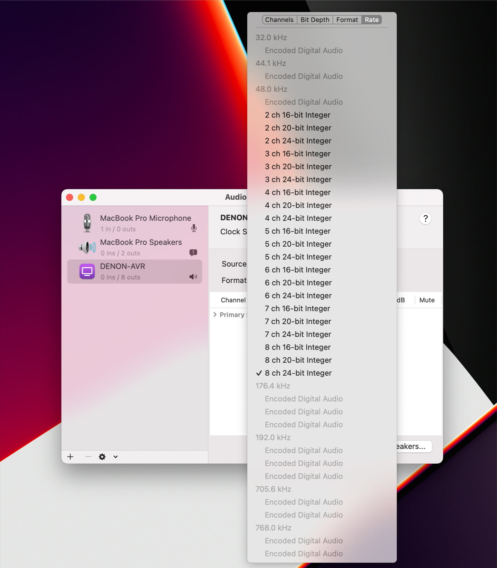

Has this thread died, I have the same issue with a MACBOOK PRO 14" M1. Apple has to be made aware this will just not due. Anyone?

This is an issue that has now come to light, Apple has to be held accountable for hobbling an otherwise excellent platform. What are they preventing us from doing, listening to Other music at 192 khz or above. Where is Louis Rossman when you need him.

The disabled frequencies are for encoded digital audio such as Dolby Digital and Dolby Atmos. They will be selected automatically depending on the encoded audio.
Simply put, Apple did not think we may use Mac with a receiver to listen to Apple Lossless music. I went back to a 2018 Mac mini as my media player because it supports up to 24/192.
I may do the same or similar, too bad however, I had envisioned making the 14" MBP M1 PRO a daily driver and companion. I'll sort it out some how. Thank you sir! Peace. 48 khz sounds like crap. I'm still flabbergasted, and do not understand Apple's methods, oh, I do. $$$$$$$.....

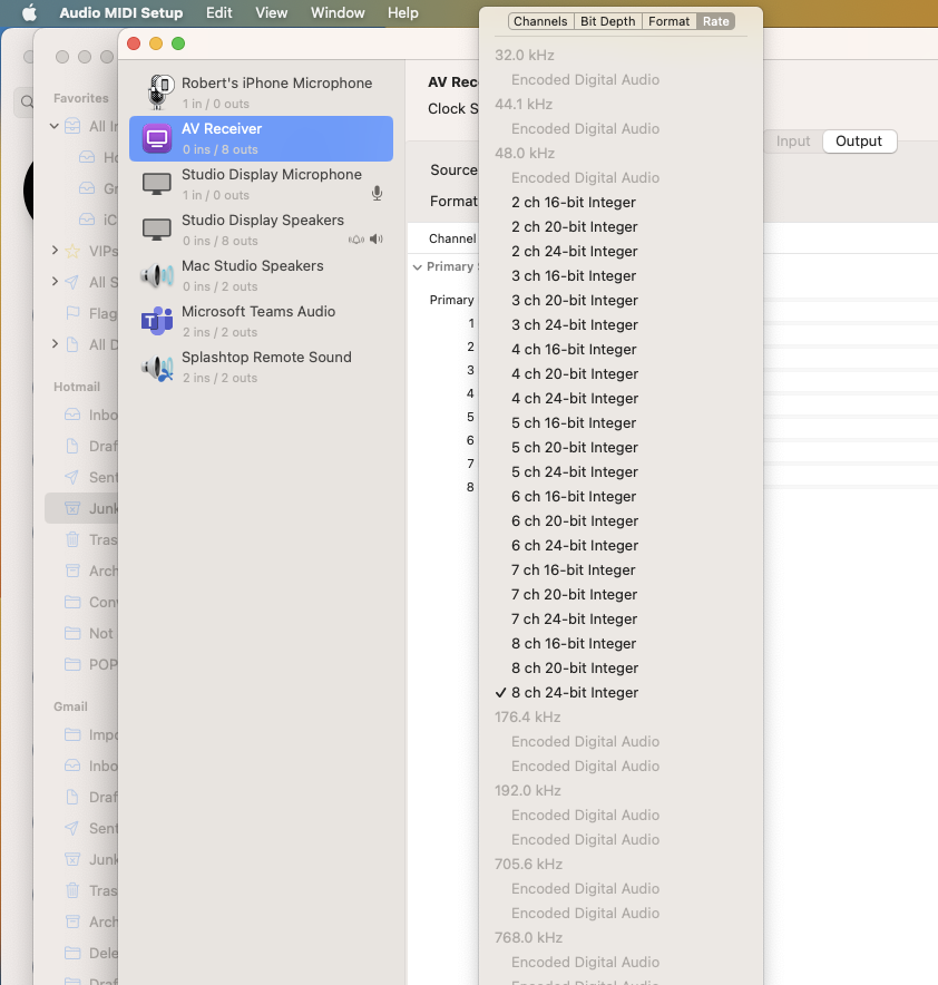

So the Studio will only do 48khz audio no matter the output?

Which Air do you have? If it is Intel, then it should do 192/24 over HDMI. I purchased M1 Mac mini to replace my 2014 Mac mini. Surprise - M1 is locked at 48KHz. The inability of Apple M1 chip to do other than 48KHz was the reason I bought an Intel Mac mini 2018 to use it as media player connected to my HiFi gear.
M1 mini at 48KHz sounded like crap.
What about internal? It seems crazy to me that the Studio apparently tops out at 48k where the Air tops at 96.
The Studio's internal DAC tops at 96kHz at 32-bit floating point 2ch, for both the internal speaker and the headphone jack. I believe it is the same D/A specs for all M1 Pro Macs or above (M1 Macs may have different headphone jack specs but it's more to do with lack of high impedance / gain). I think this spec is already above what any of the Intel Macs ever had, as far as direct analog output is concerned.
So the HDMI multi-ch output is the other way, it is below what was previous possible, which is puzzling especially for Macs that have HDMI ports like M1 mini, Studio, and 14" 16" MBPs.

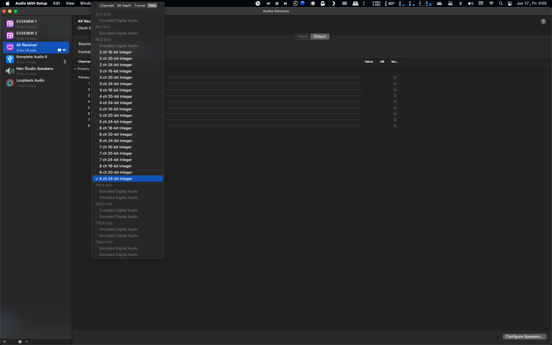

Thanks, that has been suggested by many already in a different thread. Why put an intermediate DAC that will connect to my other DAC, the receiver. Also, I am not strictly Stereo.
@vddobrev as I suggested in the related post, you don't really need an intermediate DAC - you need USB to SPDIF interface (for example, Topping D10s) that will connect to your receiver's SPDIF coaxial input. You can go up to 192kHz/24bit that way, and reaping the benefits of the low-jitter asynchronous USB connection, but you are limited to 2-channel PCM. As you are not strictly Stereo, that will not work for you, but in the context of 2-channel, it addresses your concern of cost and unnecessary A/D -> D/A conversion for room correction etc. Topping D10s goes for something like $109 on Amazon.com right now.
Many audiophiles with older receivers and DACs that don't have a USB input, or don't have asynchronous USB input, elect this route for high quality 2-channel streaming from Tidal and similar. This is normally done in combination with playback apps that support exclusive mode (direct connection to the external DAC or interface that bypasses macOS Core audio mixer). Apple Music may not fall into this category (don't use it so not sure if Exclusive mode is an option the way it is in, say, Tidal or JRiver Media Player).

Cross-posting here: I found an entry in Apple support community that illustrates a workaround that unlocks hi-res multichannel PCM over HDMI using a composite audio source:
Note that there are two versions of BlackHole pass-through driver - 2ch and 16ch. I presume people wanting multi-channel hi res PCM over HDMI will need 16ch one.

This does not work with Music app on MacOS, as it does not use exclusive mode.
I did a simpler solution - I used my 2018 Intel Mac mini, and it is now doing the duty of media player.
