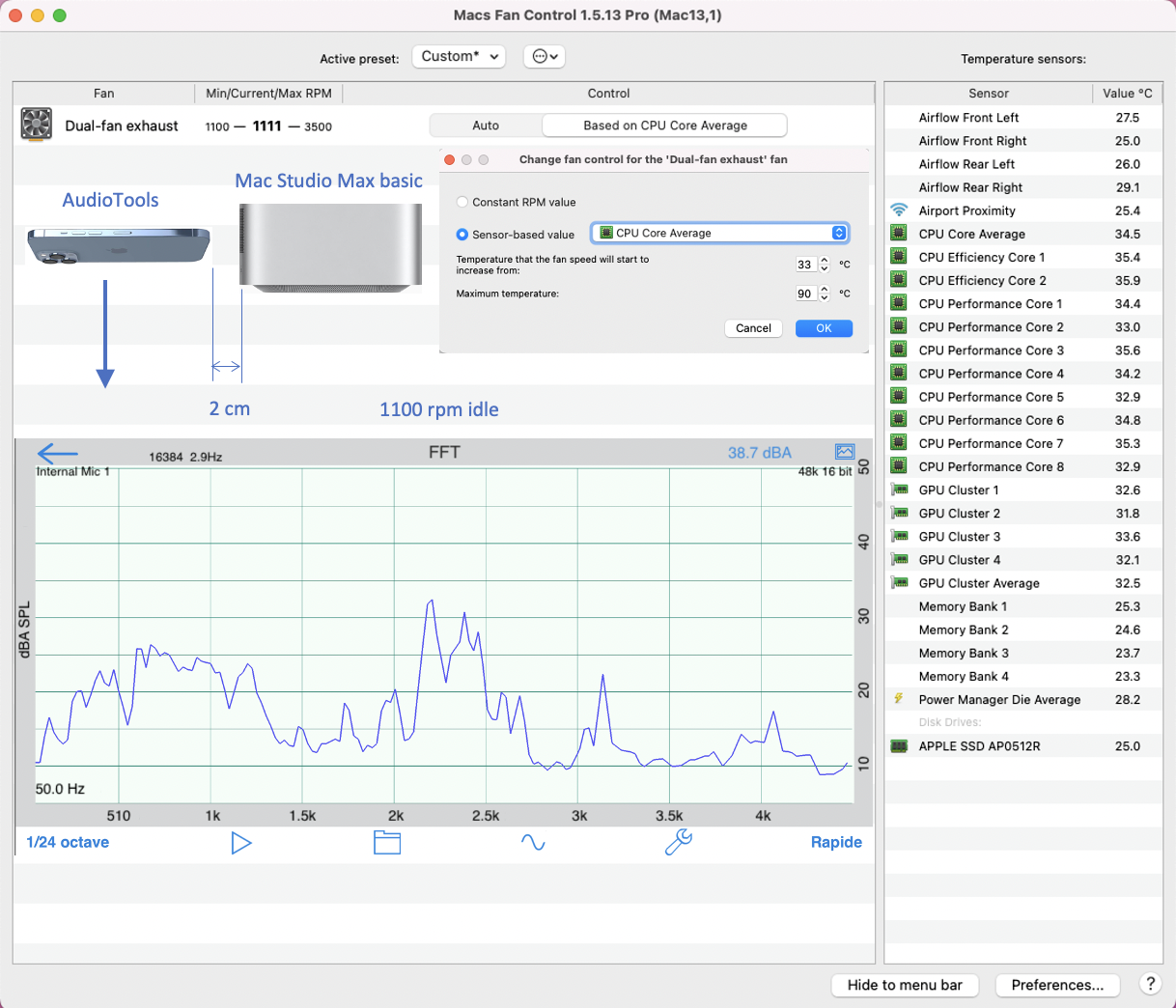

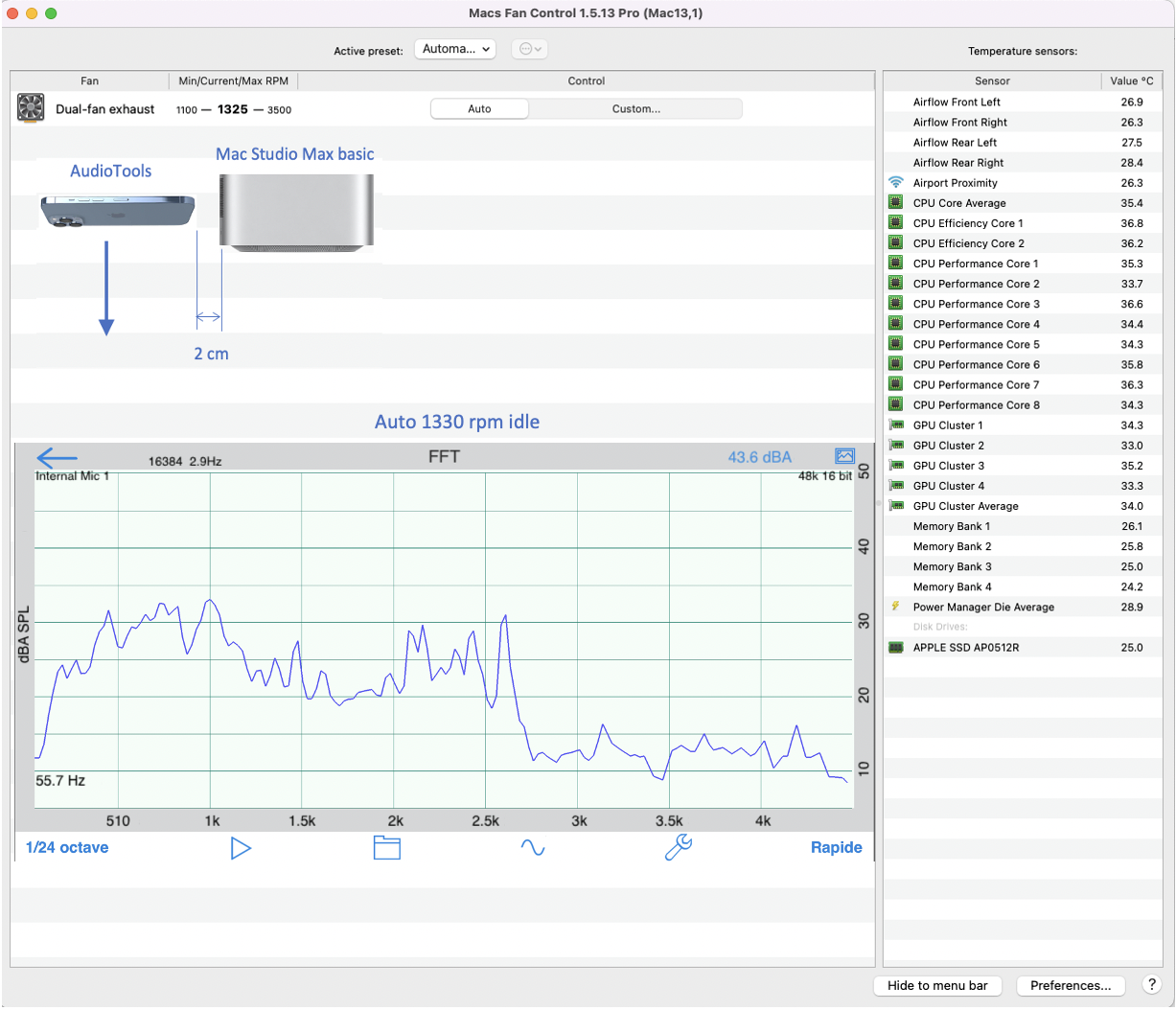

I am interested in your approach.
Reference is made to my last post.
I’ve tried to find something that can be used by anybody having an iPhone (AudioTools is working with iOS only to my knowledge) and willing to spend less than 50 EUR in order to have the same tool to be able to compare results, and detect faulty machines.
I think my Mac Studio Max basic (Mac 13,1 - 12.4 (21F79)) is working well.
I’m using AudioTools (15.4) from App Store on my iPhone 13 Pro Max and Macs Fan control Pro (1.5.13).

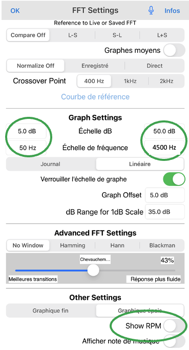

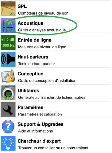

Find here after AudioTools conf I’m using,
