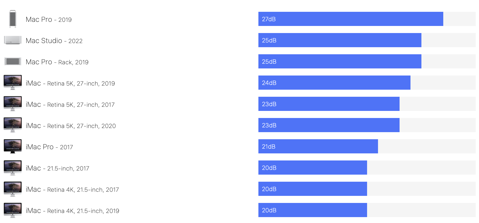

The new Mac Studio comes with a lot of power, but with it also comes a bit more noise.
It’s 25dB at idle which is as loud as the Mac Pro (rack mount). As it will tend to sit closer to the user than a Mac Pro would, which means it will be perceived to be louder as well.
(More here: https://quietmac.netlify.app)
Because it employs smaller blower fans, they emit a more unpleasant noise vs larger fans. For example, with the Mac Pro, the large fans are quiet and smooth whereas the blower fan to cool the memory is louder and higher pitched.
Until there are real samples in the wild, it remains to be seen if it is unpleasant or not.
I hoped with moving from inefficient Intels to the super efficient Apple Silicon fan noise would be lower in the high-end desktop range, but It seems the design philosophy is to use a higher than needed fan speed, but less variability.
This equates to fans running faster than required so that when tasks that spike GPU and CPU usage it will tend to stay quieter rather than creating the more obvious noise of variable fan speeds.

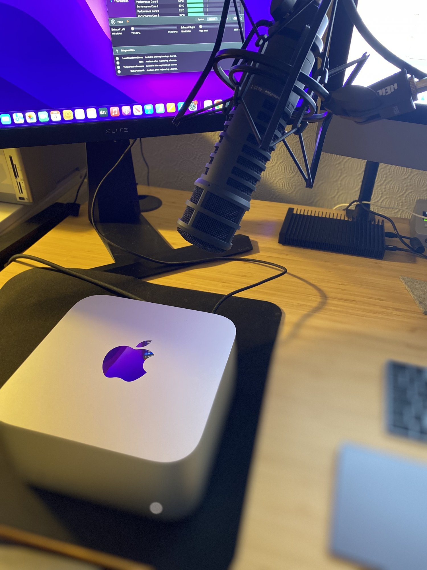

Delivery update:​
My Mac Studio arrived today and as is expected, one of the loudest Macs at idle.

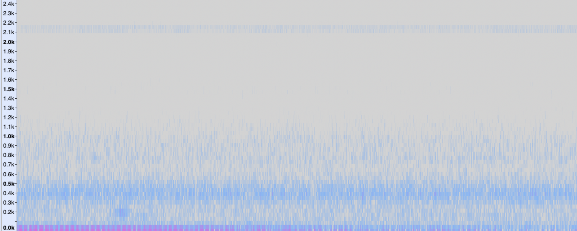

Good:
  • The fan sound is more pleasant than the Mac Pro 2019 blower. It is much less annoying and doesn't feel like it's cramming buckets full of air every second. I think many people will be fine with it.
  • When forcing it to 1,100 RPM it is easy to tune out - It is still louder than an iMac Pro at 1,100 RPM.
Bad:
  • At the default 1,300 RPM it is more noticeable. It is not "silent"
  • It has a higher fan speed than is needed at idle. The fan speed is overkill at idle.
  • It's going to be hard to clean - Dust may be a problem in future.
Ugly:
  • It exhibits a whine at 2.14Kh. This tone varies a lot in terms of when it appears. It is annoying.
Overall, I would likely keep it if 1,100 was the default and it didn't exhibit the terrible whine. So maybe with a firmware update and the whine fixed, I'd buy it.
For now - I'm sending it back. I might wait to see if the iMac Pro makes a return next year.

It's 25dB at idle, as a bel is 10x a decibel. I didn't want to add more complexity to the message, but I can see you guys have found the specs.
In reality the sound pressure at operator position is a non-standardised reading from wherever Apple defines the computer would sit - I would take the 15dB reading with a grain of salt and use the sound power level x 10. So 25dB.
I have an iMac Pro and it is significantly quieter than the Mac Pro (2019) I had. Even though in theory the iMac Pro was 13dB (at operator position) vs 11dB Mac Pro

You’re comparing Apples and oranges here and you’re both right. The lower dB is at operator position. The OP reports the measurements done right next to the machine. Sound pressure will decrease with distance squared.
Second I can see that apple uses different conditions for “wireless browsing” measurement. One is 25 popular websites- another is 8 tabs open with “media”.

If this is used in a recording studio that noise is important. I will sometimes do overdubs with the mic just a few feet from my Mac. You don’t want any noise in that situation. So for some use cases it’s an issue. In office situations I agree. A non-issue. And generally I would say that one of my main reasons to use a Mac is the low noise compared to the PC world.
As someone who does a lot of sound recording, this doesn't make any sense to me. A mike runs via cable, usually a fair bit of it, to an audio interface that in turn runs to a computer. It isn't good practice to be recording close to a computer, and equally importantly it's completely unnecessary, if one is halfway organised, to be doing something like overdubbing "a few feet" from one. Get longer monitor and mike cables :)
Well… I am and have always been limited on space in my home studio… Or you might be doing small videos where you need to overdub. Then you would sit at your computer.
Not everyone can go to another room to do recording even though you would love to.
Ever since I got my first iMac this has not been an issue. I never had a PC that was silent enough. Just hate to see Apple going in the wrong direction on this even though the 2dB is probably not noticeable.

The 12-inch Retina MacBook is listed by QuietMac with 12dB noise... but neither does it have a fan nor a spinning drive. 🙄
That's what Apple officially list it as on their tech spec website (https://support.apple.com/kb/SP712). I've no idea what the noise is at 12dB, whether it be the electrical noise or something else, but it is what Apple says it is.
