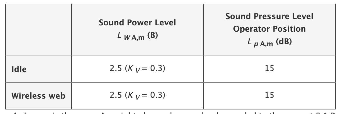

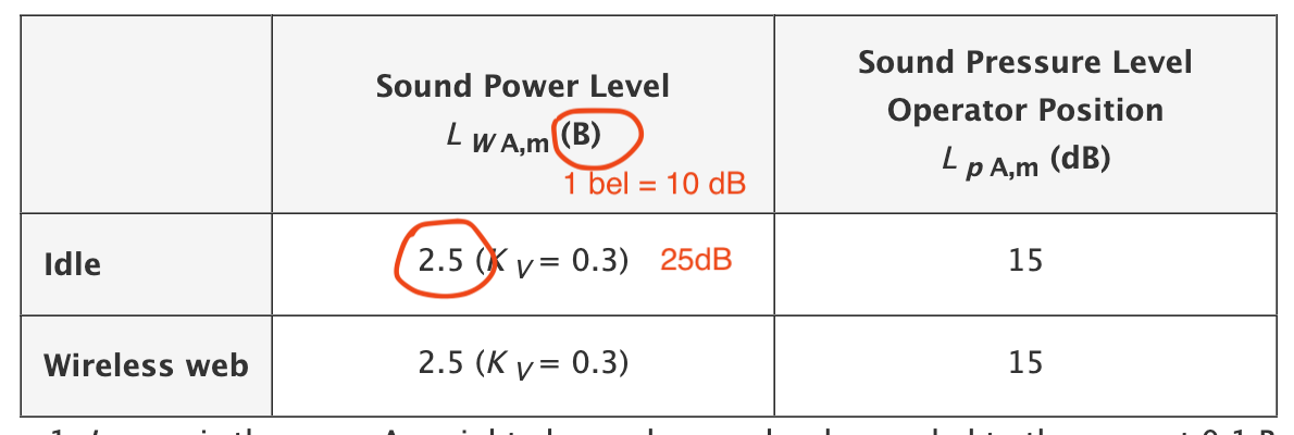

In that link it says 15dB at idle?
The sound power level is 2.5 Bels which is 25dB.
The readings will eventually be in decibels.*
*(https://www.ecma-international.org/wp-content/uploads/ECMA-109-10th-edition-December-2020.pdf)
Although this version of ECMA-109 currently continues to utilize bels as the unit with which sound power levels are declared, it is expected that future versions of this Standard will move toward the adoption of the decibel unit. The main reasons for this change are congruence with most other industries as well as reducing the confusion surrounding the meaning and significance of the bel to the public.
I don't see 25 dB only 15 dB at idle, as seen here.
Hopefully this now makes a bit more sense:
Okay I see you updated your original post with the link that states Sound Power Level.

You (OP) consistently ignore that Apple gives "SPL Operator Position" as 15dB right next to the Sound Power Level number you keep repeating.
Why do you persist in this?
