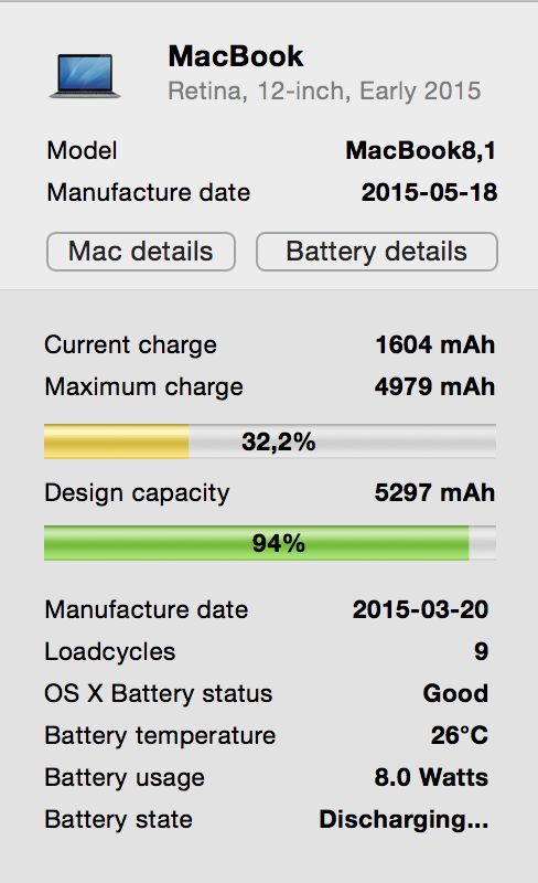

I just notice my macbook capacity losing really fast, just after 11 cycles it reduced the capacity to 94% of its original capacity. anyone have the same problem as me ?
i just do the battery calibration last night, before added the new record. i dont expect this much after only 11 cycles.

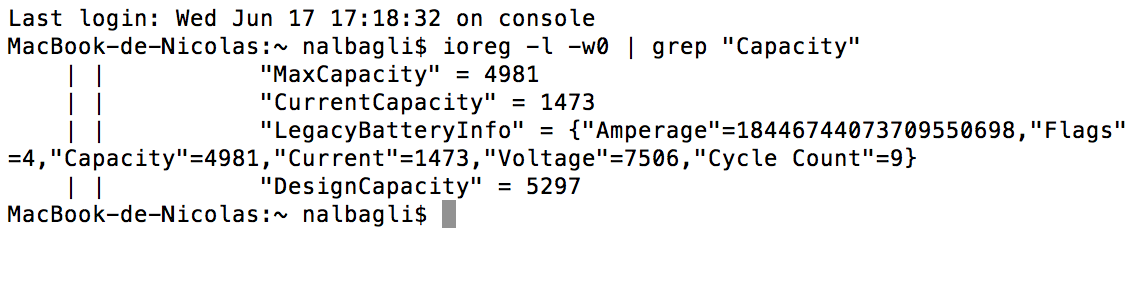

Remember also that the reported battery capacity can vary even within one cycle, depending on conditions - both up and down. Use this terminal command a few times in 5 min intervals to see the typical min/max range (including when idle):
Code:
ioreg -l -w0 | grep "Capacity"

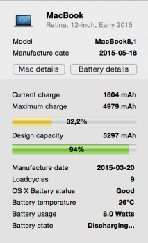

Captura de pantalla 2015-06-18 a las 1.15.24.png Captura de pantalla 2015-06-18 a las 1.05.23.png
I am really worried, with only 9 cycles my computer is down to 94% of it's original capacity, do you have any ideas of what may be causing this, what could I do to fix this issue, this is really disappointing as i've had this computer only for almost two weeks

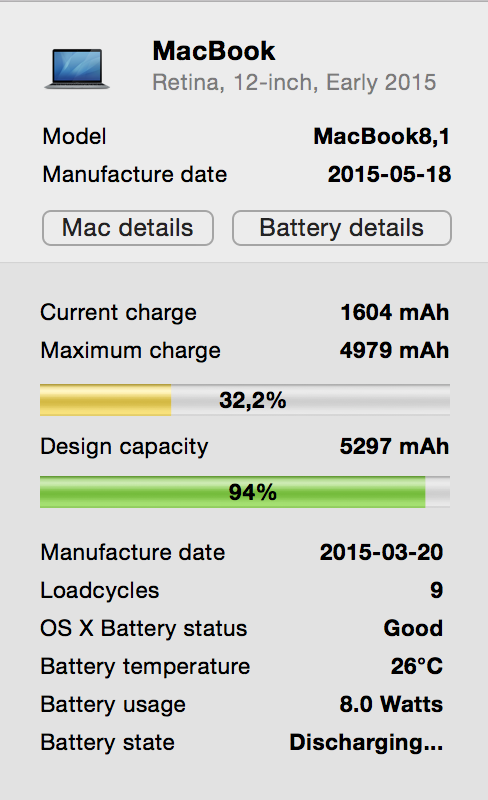

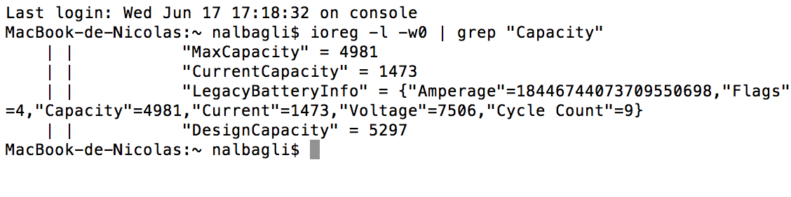

View attachment 562129 View attachment 562124
Wait and see where it settles, it`s nothing new for batteries to drop in percentage out the box. Conversely the rMBP I am on now is reporting 99.5% after 47 cycles, it started off at over 104% these values we can "pull" are not absolutes. There is a lot of parameters that effect battery life and longevity on Notebooks; charging & discharging temp, charging & discharging rates, depth of discharge etc.
