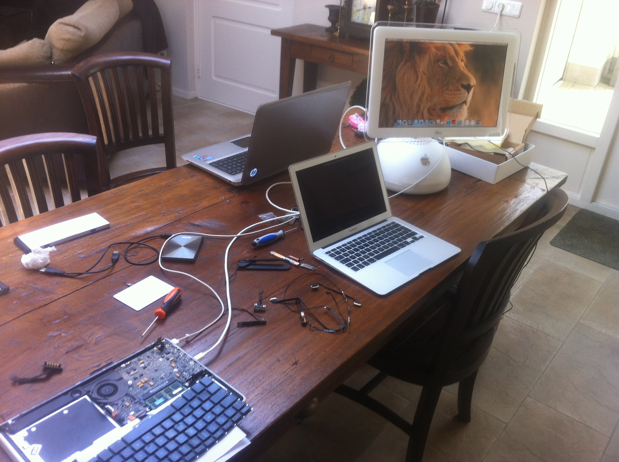

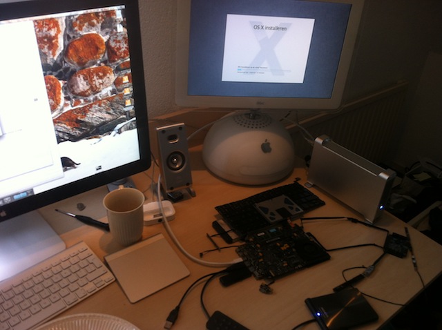

    A while back I bought a logicboard + some other internal parts of a broken MacBook Unibody 2008 (this is a EU model, as can be seen from the keyboard) I planned to use this for a homemade mac mini kind of project but never found the time.
    This all works as can be seen here:

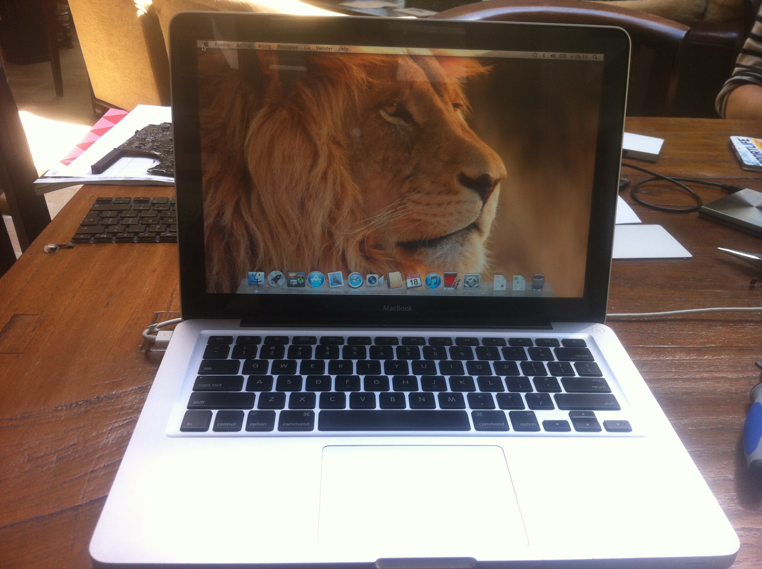

    #6
    Done!
    [​IMG]
    [​IMG]
    [​IMG]
    [​IMG]
    Special thanks to ifixit.com of course, they always provide in great guides which we all can benefit from in repairs like these :)
