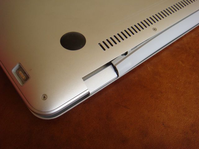

Same problem has happened to my apple air. last week when closing the lid the hinge plastic came out. Took it to apple care they said that hinges are not covered under warranty! and that I broke it. Nice of them to put down a man that is without his air.
After that I called apple care for an hour (singapore). All they could say is take it to another care centre. When I got to the next apple care centre the first thing they said to me is hinges are not covered by apple warranty. Got them to take it. Hope tomorrow they will fix it.
The funny thing is, I was going to buy a new apple air rev.b yesterday since i can not wait a 1 week for it to get fixed, as I am traveling to Sydney, Perth, Singapore, Saigon all in a week for business. but how can one buy a laptop knowing it has a DEFECT and that apple will not provide any warranty for this DEFECT?

Photo below
http://flickr.com/photos/landung2008/3247328478/

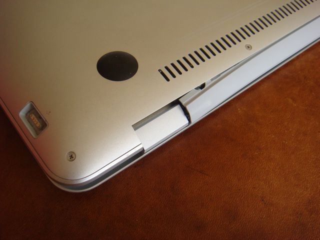

Same problem has happened to my apple air. last week when closing the lid the hinge plastic came out...
Photo below
Purchased mine 28th feb 08. rev A.
Hard to follow how it popped out on it's own, the grey plastic has 4 screws (2 on each side) to secure it. You would have had to crack the plastic from the inside which means you had opened the insides. I'm just saying ... 😀
I was closing the lid of the apple air because the apple was overheating for no reason (normal for revA) when the hinge defect happen.
I think the problem could be heat related, the constant heating and cooling around the hinge could cause some sort of fatigue problem. Its the left hinge so there is some relation with the CPU heat on the left side of the air.
Something is just not adding up about your post:
1. Why would you close the air if it was overheating? That is just trapping more heat.
2. Rev A (if you are up to date on Mac updates) doesn't get the overheat issue like it used to - fans kick in earlier now.
3. The apple store just replaced my entire shell for a broken hindge - on warranty. - they are seeing something that is not looking defect related to them.
4. It would have taken some force to pull the plastic away like this.
5. You are the only user I've ever seen to encounter this exact issue on these forums in the past year.
