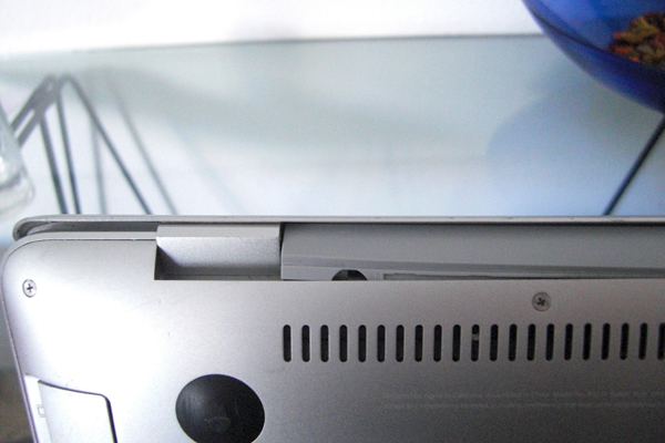

SO my hinge just broke last night the middle plastic piece popped out on the left side of the computer, its a revision a that i got on the first day of retail, and apple said they wont fix it, so i'm not sure what to do.
Won't fix it? Did they give you a quote on how much you'd have to pay or is it just irreparable?

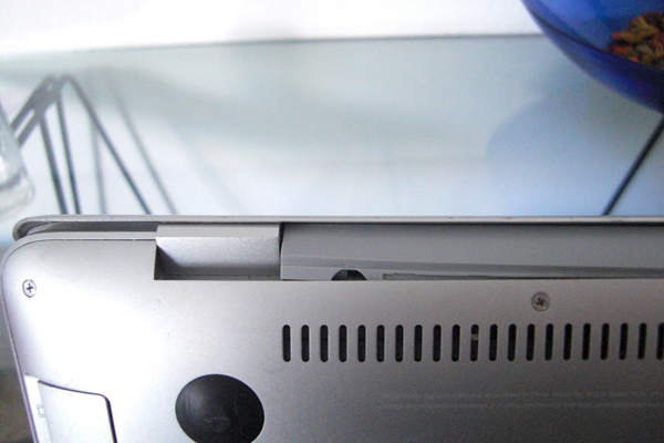

My MBA Rev A hinge broke last night. We don't have Apple Stores in Spain so I went to an authorized dealer who told me it was my fault and I would have to pay. I told him that I have never knocked it or anything and it's still under warranty (Since June 08). Knowing from what I read here, I said I would speak to Apple directly. I called them this afternoon and was told to send in pictures and they would get back to me..... :-( Still waiting.
This is what mine looks like exactly
http://att.macrumors.com/attachment.php?attachmentid=168225&d=1240511847
I was quoted 800 dollars which is outrageous considering its a hinge.
I think the best thing to do Rev A or Reb B is once you get some slop in the hinge, send back to Apple (provided you have AppleCare) to get it fixed. Once it breaks, I think you are a dead duck.
