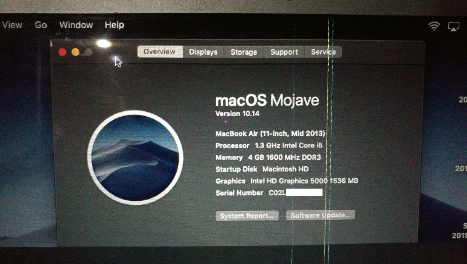

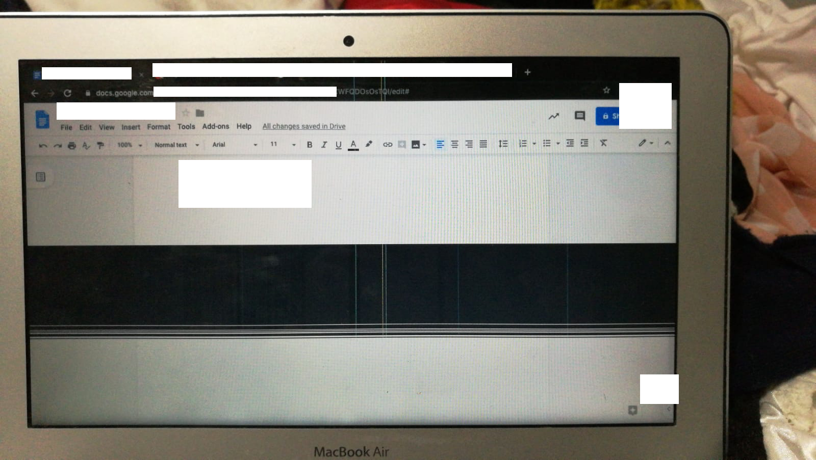

DOES ANYONE KNOW HOW TO RESOLVE THIS BLACK LINE ISSUE WITH THIS MACBOOK AIR? (PICTURE BELOW)
IVE TRIED EVERYTHING, INCLUDING RETTING PRAM
PLEASE SUGGEST IDEAS DOWN BELOW
(btw the white/gray boxes are there to blur private stuff as this is my girlfriend's macbook air)
Have you tried disconnecting and reconnecting the video cables between the screen and logic board? If you did and that didn't fix the problem, I think you'll need a new lvds cable or screen.
Umm ive tried that, it didn’t work and we got new video cables put in, umm do you think the MacBook Air is could have been damaged by smoking? As my gf and I both smoke, it’s always exposed to smoke
I doubt smoking would produce this result.
I'm inclined to think it's time for a replacement display.
Replacing the display is pretty simple with the right screwdrivers and patience. I recommend buying a damaged Air with a working display. This will be much cheaper than going to Apple. The display from the mid-2013 to early 2015 Air should fit.

I was doubting that us smoking would have caused this too, but I heard that smoking effects laptops (another reason to quit lol) and btw display is brand new so I’m stumped.
I'm at a loss as to what it could be. The only other thing is the logic board.
I assume you have no way of testing the display on another Air.
Same, even my local repair shop doesn’t know, the logic board could be the problem but there are complications with that.
A replacement logic board is going to be expensive. At least a logic board from 2013 to 2015 will be a direct physical replacement with no modifications.
