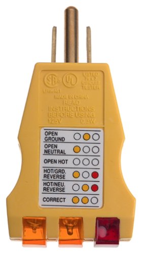

    I'm surprised that no one has done the obvious and tested the plug-hole. it would be interesting to know if the people that are experiencing this are in areas with crappy or ungrounded electrical outlets. My experience is that something like 20% of all houses are actually wired incorrectly as most houses have some DIY wiring in them somewhere.
    [​IMG]
    If this is static electricity, then the environment should be changed however is necessary to stop it happening as it could certainly fry the motherboard in some situations.
    If it is actually electricity from poor wiring in the wall, you are even more likely to destroy your computer with it.
    Either this is an effect that is to some extent "in the mind" or it's a serious electrical problem that should neither be ignored nor tolerated. I would definitely check the electrical socket you are plugging into (for hot on the neural and for ground) and definitely take the MacBook Air back to the store if you can't find anything wrong with your house wiring. You'd be crazy not to do so as this is definitely not the experience you are supposed to be getting.
