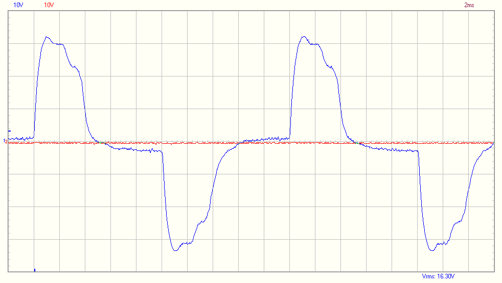

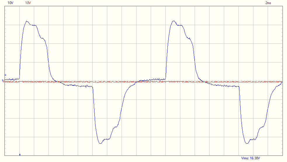

I also get this electric feeling on my macbook air (MBA) I got for christmas, only if I have the charger plugged in, especially if I brush one finger across the left of the MBA. I also get this feeling if I brush on the metal part of the mag-'safe' power connector (the new design) even if it's unplugged.
So I tested the voltage and current between the power connector's magnet (while plugged in) and the earth wiring (via a tower PC's case, which I know is earthed) and it wasn't very much. On the current setting, the electric feeling goes away.
But, If I probe the same place using an oscilloscope, there is certainly some mains voltage leaking into the MBA's pseudo-ground (case), which is too much for the 30Vp oscilloscope. If I connect the magnet to earth via a 270k-ohm resistor, the waveform is only 29V, and is the one illustrated in the attachment with 10 volts/div vs 2 millisec/div.
Therefore, if I connect a wire from earth to the connector's magnet, the electric feeling stops.
I hope this information is useful.
